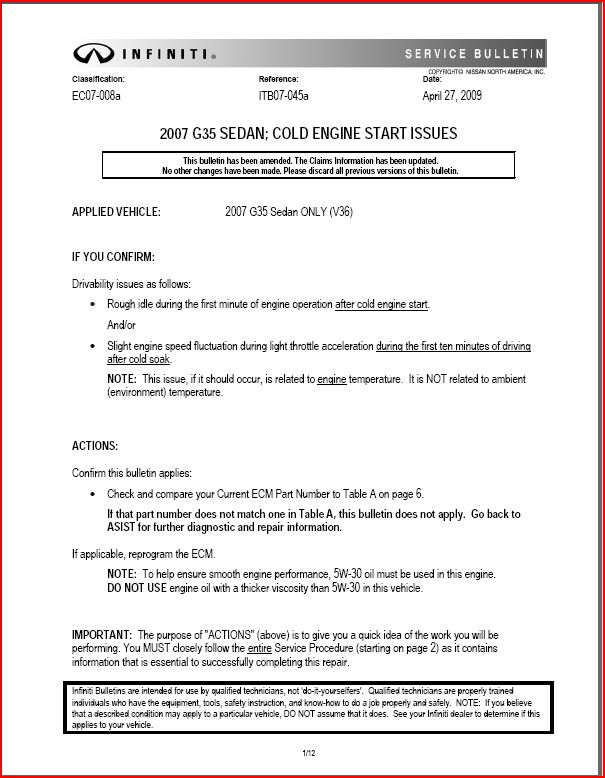

ITB07-45a is the REVISED cold engine start TSB...just came out last week 4/27/09! Sorta ironic that there's a new ECU program that turns the car back to its old self. hahahaOriginally Posted by Ernie3647

One question - did you have a fluctuating idle issue after doing the sensitive throttle ECU update? If so, did this new updated (ITB07-45a REVISED cold engine start TSB) fix it?

Guys: There are now 3 TSBs for the 07 G35. The latest one issued April 27, 2009 according to Ernie3647 ITB07- 045a is not to be confused with ITB07-028 and 045 issued last year....all dealing with the "touchy Throttle issues. My ECM was replaced after the dealer applied the unauthorized ITB08-017 TSB, note that is an 2008. That made my G runa like an 08 which drive differently - slightly hesitant, etc. My g is CLOSE to what it was but not exactly. I do sense the rough cold idle. I may ask to apply the new 045a, next visit...
