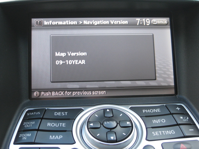

I can take a picture of mine when i get home, but the screen definitely does change.

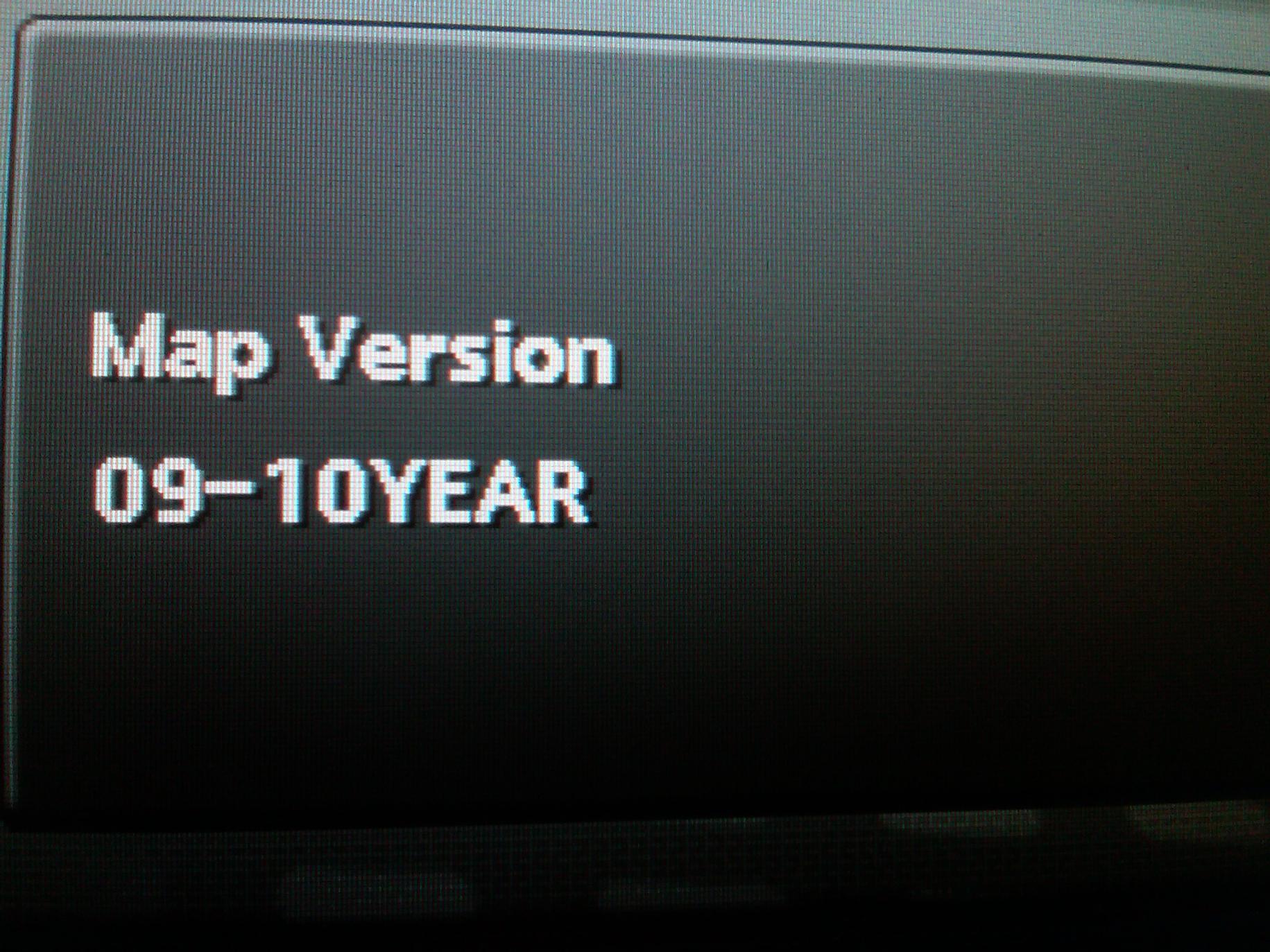

Mine used to say 06-07. Then they updated it wrong (they hadn't updated their own system yet) and it said 07-08. But I brought it back in and the correct version has been installed and the screen reflects that.

Hope this helps. Let me know if you need any other picture. My car is a 2008 g35 it just had the nav. updated. Used to say 07-08 year something like that. Now it says 09-10 year. Off topic, I am biting my tongue not saying anything bad about dealers .
Awesome, thanks a ton. I knew something was entirely wrong with their explanation. The service tech who helped me out also thought something was wrong, but the service manager was the one who says it always stays as "07-08" update. Can't wait for this conversation.

Thanks for the picture. I brought itto the service department today who still insisted that I was wrong. They said that the car in the picture had an optional "hard drive upgrade" which shows the 09-10 map version. I informed them that is complete BS.
