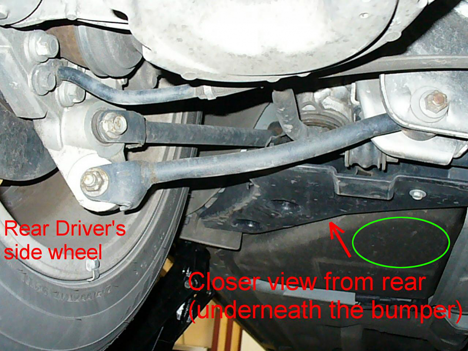

Hi all, I have an 07 G35x sedan and I was wondering what is housed in the metal enclosure outlined by the green circle? It's located right beside one of the rear wheels (on both sides).
The reason I'm asking is that I stupidly placed a jack stand on this to lift the car up and it left a pretty big dent. Is there any cause of concern? Nothing leaked, but I just found out that the black coating fell off as a result the crease made by the jackstand.

The Green circle is your gas tank.

you sure about that? because there's also another one on the other side...

Yes! Do you think there is only one tank? Our cars is 20 Gallons and if it was only on one side it would throw the balance of our cars off. Some A$$ whole jacked up my car on both tanks and they are pretty dented up. Some other mechanic shop told me about it and that's how i know those are our gas tanks.

Uhm, to be honest, I've never looked that closely, but I'd be very surprised if our cars have two tanks. Much more likely that they have a single saddle tank.

you're both right in a sense.
blue - the tank stretches across the width of the car, so it appears there is a gas tank on both sides. but really, it's the same tank, as vqsmile implied - a saddle.

wow I think I'm convinced that it is the gas tank... I kept rechecking and just a bit surprised that it didn't leak after withstanding enormous amount of pressure. These things are built really tough.
I learned my lesson...
