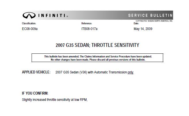

The harsh acceleration is a known issue (Issue to some not others ) There is a TSB for it. The dealer can reprogram your tranny to relieve the harsh acceleration

I did not like the throttle pedal sensitivity at first but the more I drove, the more used to it that I became. As mentioned, there is a TSB to rectify this "problem", however it is *not* reversible. Once it's done, it's done, so make sure that you are surely sure before you have it done.

Search here or google "G35 throttle sensitivity" or "ITB08-017".
You can read the actual service bulletin at Infinitihelp.com

Here's a link to the page with the tsb, just register for infinitihelp.com and you should be able to download it. ITB08-017a
I would try disconnecting the battery to reset the ecu first, just remember that you'll have to reset your radio presets and auto up/down windows.

I saw this TSB was for a 2007, mine is a 2008. Would it still be applicable?

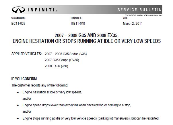

I would caution to seriously consider this bulletin application. I speak from experience as when I first got my G I also was annoyed by this behavior. I found this bulletin and had it applied it fixed that problem but produced a negative result also. I’m sure if you research this bulletin thoroughly even on this site you’ll find the negative comments I speak of. After the upgrade like I said it did fix that problem but now the car seemed almost hesitant to go. It seemed to lose let’s say that “Sparkle” I always loved about it. Not being able to positively put my finger on it made it even more frustrating. I even asked the dealer if he could revert things back. I’d rather live with the touchy gas pedal then accept things as they were. He said no couldn’t be “undone”. I took a drive on another G with dealer and showed him the difference. Nothing could be done. So I said to myself well it’s still a very enjoyable car I’ll see if down the road there’s an answer. Had to wait till March of 2011 to restore my beloved G back to its prime performance state in the form of bulletin numbered 1TB11-018. Bottom line considers this sensitive gas pedal well. In my opinion leave it alone and consider it “The Nature of the Beast”.

Originally Posted by Ernie3647
... Had to wait till March of 2011 to restore my beloved G back to its prime performance state in the form of bulletin numbered 1TB11-018. ...
So, to be clear, you had the original TSB performed (#17), didn't like the result (as many others have reported here too), and then had this other TSB (#18) performed to restore it back to original.
Is that right?
Is throttle response actually back to original now, or is it somewhere between original and the first overly-compensated TSB?
Old Dec 2, 2011 | 01:26 PM
Ernie3647's Avatar
Joined: Oct 2008
Posts: 17
From: Baldwin NY
Not sure if we can say that the second bulletin was made to restore the system. It addressed a particular problem which one that was caused Ironically by the first in my case. I may be wrong but I think the later update incorporates the prior ones. I know the ECU version now ends with an "E" and it ended with a "D" prior to the update. The original was a "A" I've had some changes made to correct things like the ICC unit operation. To be perfectly honest the gas pedal problem is “slightly” better now. Or maybe I’m just getting used to it again because now it has that “snap” off the line that I really liked about the car. It was especially pronounced with the all wheel drive because it didn’t matter what the road conditions were. The damn thing just goes like it’s geared to the road and thankfully it’s like that again. Certainly not enough better to make up for the length of the time which the car wasn’t “as purchased”.
