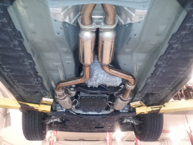

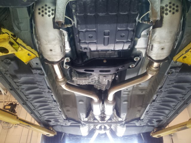

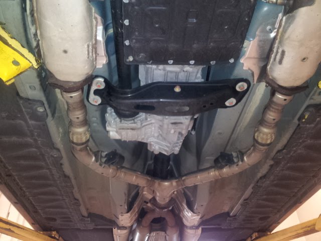

ok it is finally done! i was not able to be present when the pipe was cut, however it was very easy to see how to make it work. After i got it back from the welder he said it was easy.
here is the stock set up
here is the after

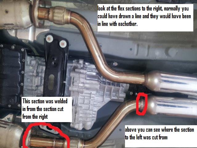

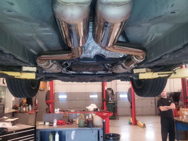

some description of the cuts involved
these are some of the pictures that i took. i can get more detailed measurements if needed. after the modification to the pipe the rest of the exhaust bolted right on. hope this helps anyone with a awd who wants an invidia. On a side not i realized i misspelled invidia in my post title...can i change it?
