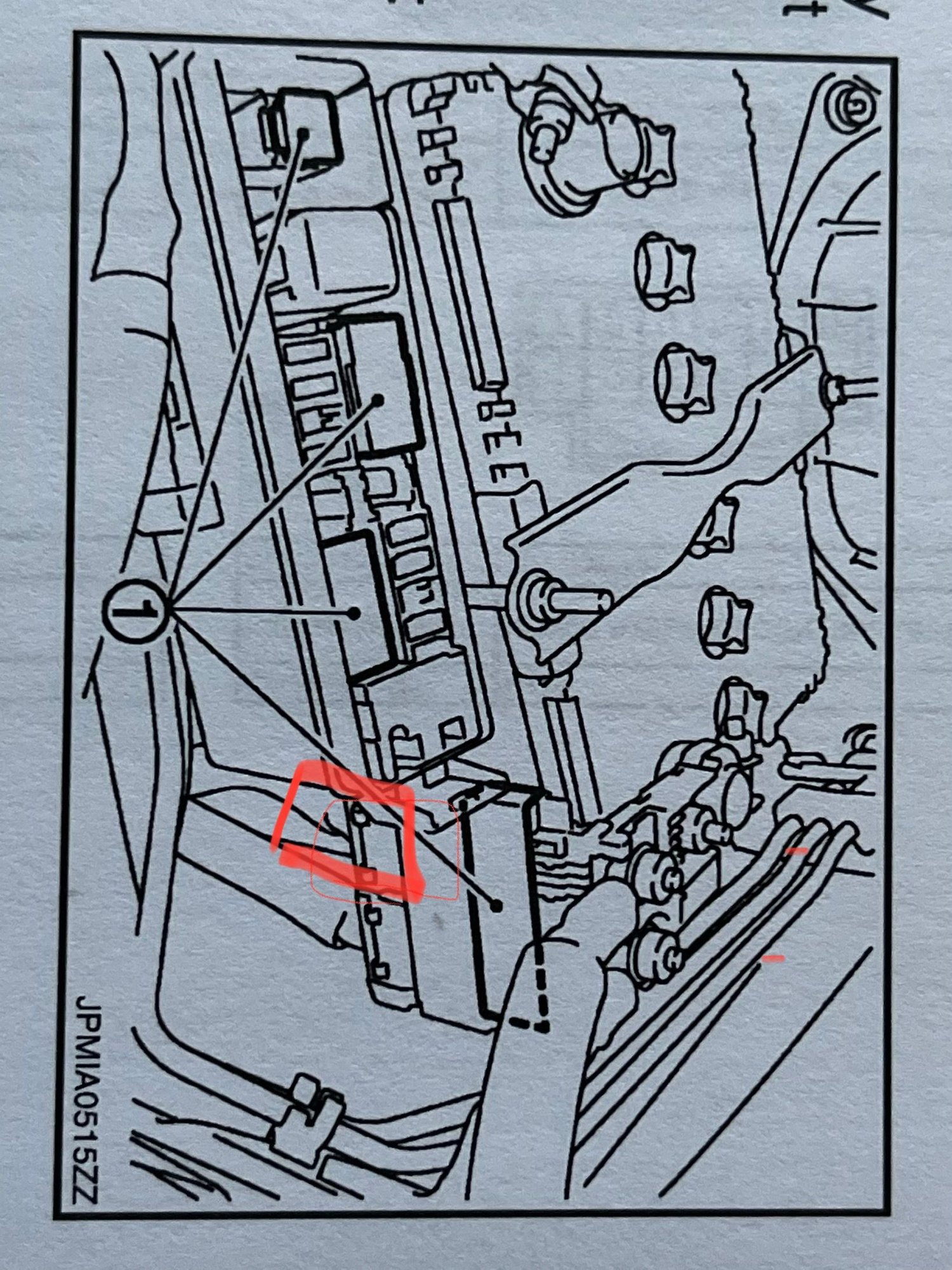

Check voltage at cabin fuse
After finding all of the fuses in the cabin fuse block do not have power, check the connectors at the positive battery terminal power distribution assembly. You will need to remove battery cover plastic trim and the positive battery lead. There are 2 connectors under the power distribution assembly that
The connector outlined in red delivers power to cabin fuse block.
must be fully clicked into position. Hope this saves you some time!
