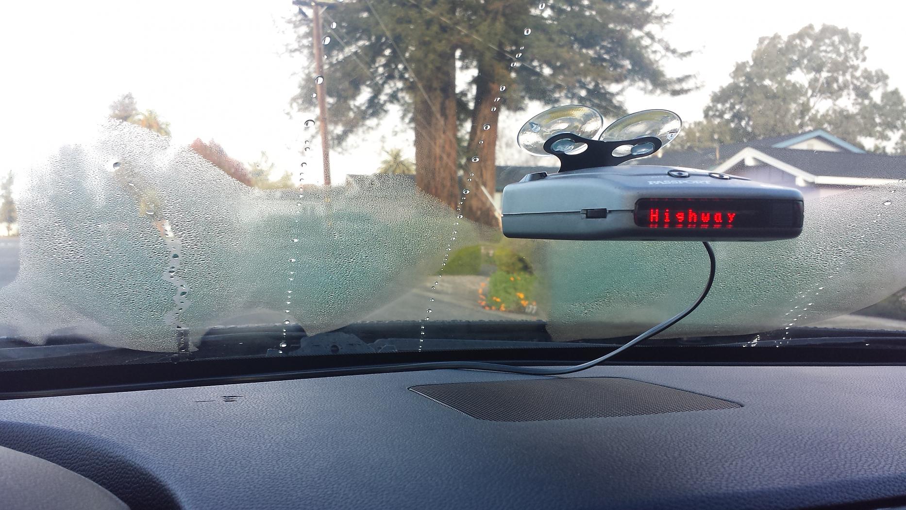

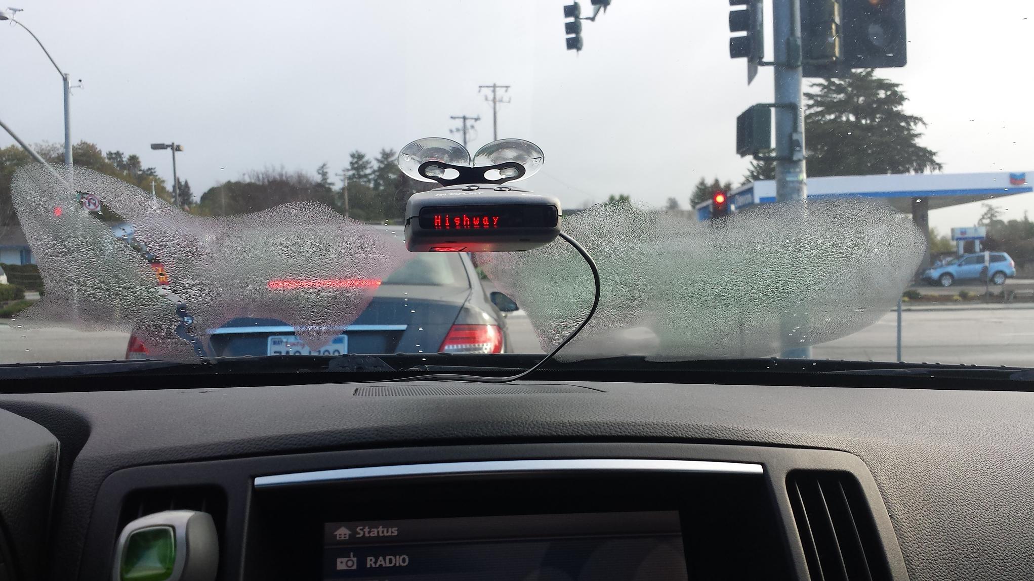

It started raining over here in Cali, and I noticed my car gets very humid and starts smelling really weird and this morning my windshield had water spots inside large ones! Anybody have this problem or have a solution. 07 G35X.

You have a leak somewhere

My thoughts about this: check all your rubber seals around your car. Like windows and specially the rubber seal of your doors. It tends to dry up and crack during summer and specially putting some sort of car detailing products.

Check for clogged drains. Some compressed air into the sunroof drains, possibly debris in the hvac system. Is your carpet wet?
Also, even if it's not warm out, run the A/C. That helps remove humidity from the cabin.

Any recently installed stereo or alarm systems? That's where you may see poorly sealed holes for the wiring.

as someone else said, check the drain on the evaporator core. Check the carpet on the passengers side, you may need to pull it, to look under it. That's what I had to do once. My drain was full of leaves and algae.
