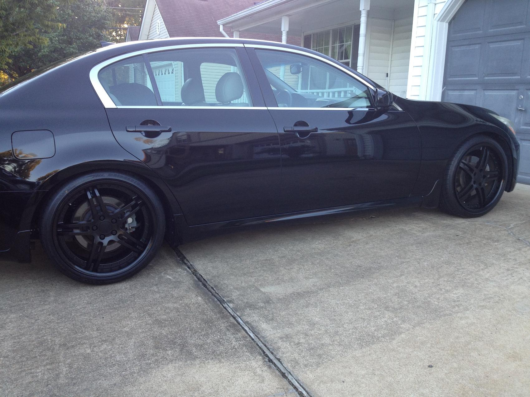

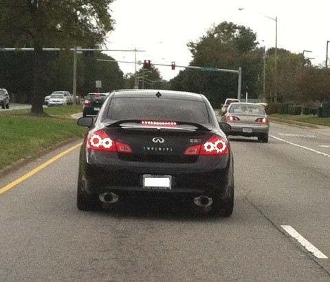

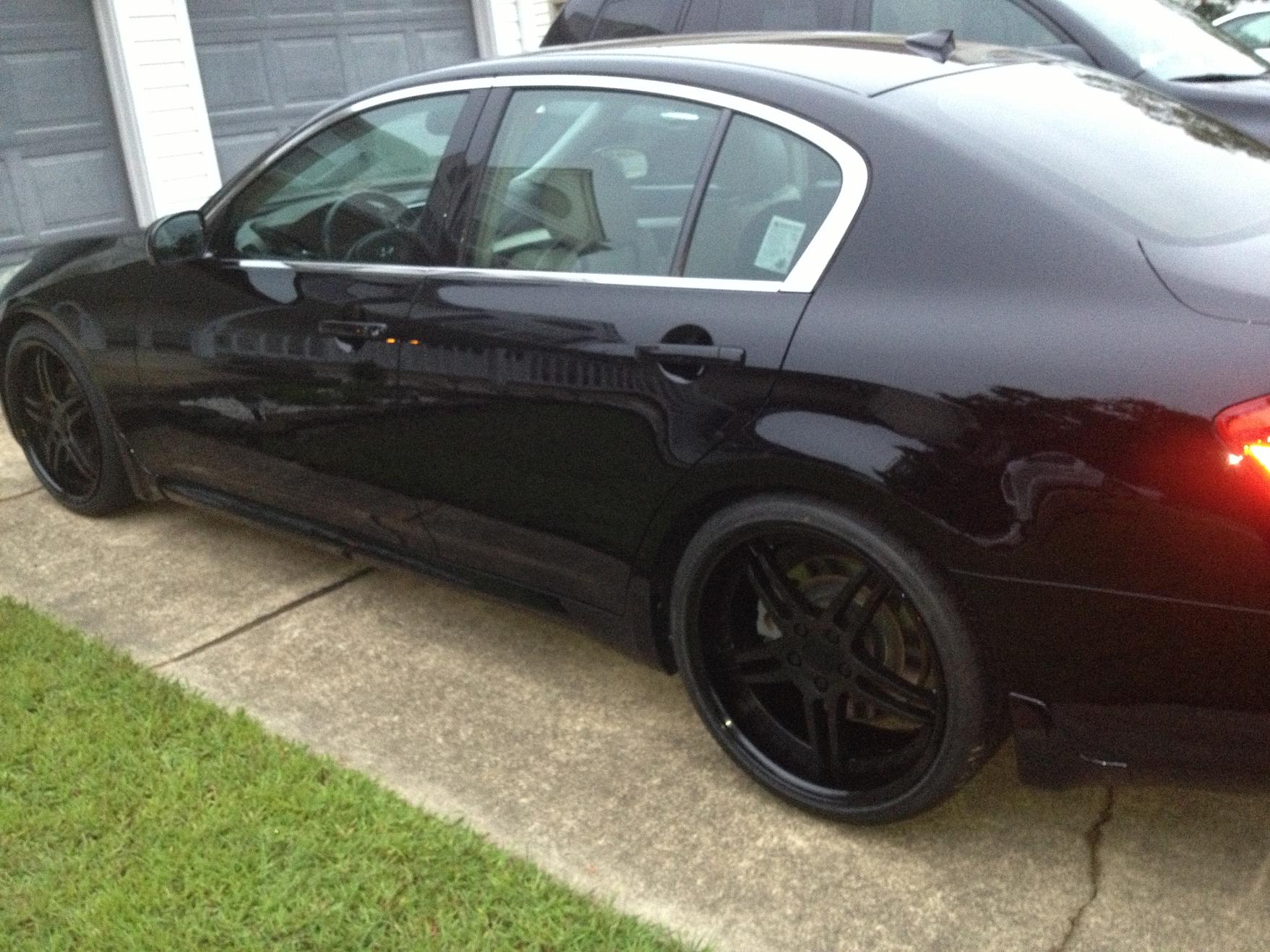

i have 10.5's on the back of my '07 no modifications...

none whatsoever. they're 20 x 10.5 +48 on the rears and 20 x 9.5 +40 on the fronts (looking back at it, I could've gone slightly more on the offset for the front to get completely flush).
