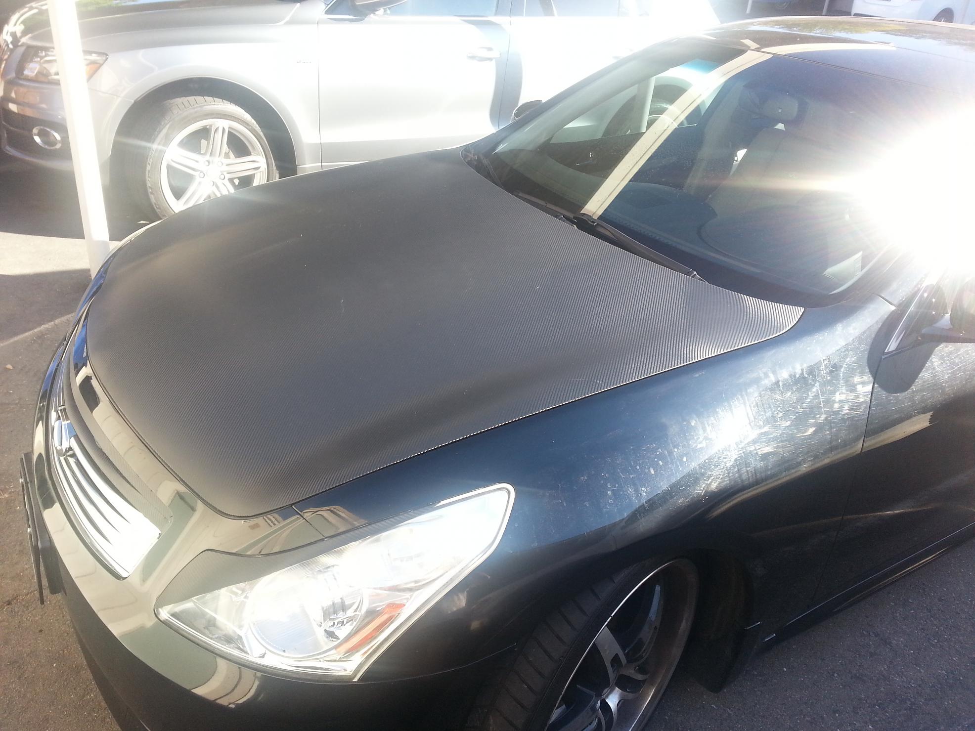

Did it by myself. Didn't do a very good job but learnt why. Didn't heart enough in the beginning and melted the vinyl in 2 places. Overall, is a success for the first time. Also, I played around with leftovers after. You'll see.

Looks pretty good from the pictures. Nice job for a first try. Looking forward to the rest.

After being parked in the sun for a few hours most imperfections disappeared. II'lltake a needle to the rest. Still have 47x50 left, maybe for the trunk. The rest comes in Tuesday.

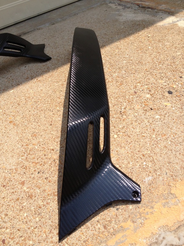

I'm writing from my phone but also wanted to let you know you can clear coat over the vinyl to make it glossy and a darker black. I can post some pics of some fenders I did a while back if you want. They were cleared after the wrap.

It removes just the same but you have to be careful about overspray if your doing it on the car. I did these while they were off the customers scooter.
3m dinoc uncleared
Cleared:
In the sun, cleared:
Customer installed Pics on a shady day, if there was direct light on them the color and pattern would really pop, really not a good example of installed pics to be honest.

The big thing with clearing the material is it has to be done after its wrapped & you need to do wet coats. If you do too thin a coat the material gets a weird dry look when its done drying. I do 1-2 wet coats. You may notice the clear looks white when you spray it and the CF pattern is gone completely however once it drys it makes the cf look more a dark black and the pop of the cf is multiplied. You loose that any angle cf dry look and gain a glossy dark black w/tons of pop at angles cf look. You will want to test on a spare piece first as I have only cleared di-noc materials but I love the effect it gives them. I have more examples but they are all paintball related smaller wrapped items. I wrap car stuff but just really by word of mouth so a lot of small interior stuff, scooter stuff etc. I have not tackled a whole car wrap, just hood, roofs & trunks. I do a lot more paintball related wraps than anything. I feel like plasti dip would be cheaper/easier if I wanted to change the color of the car completely and wanted a satin or matte color finish. For gloss wrap would definitely be the only option.
