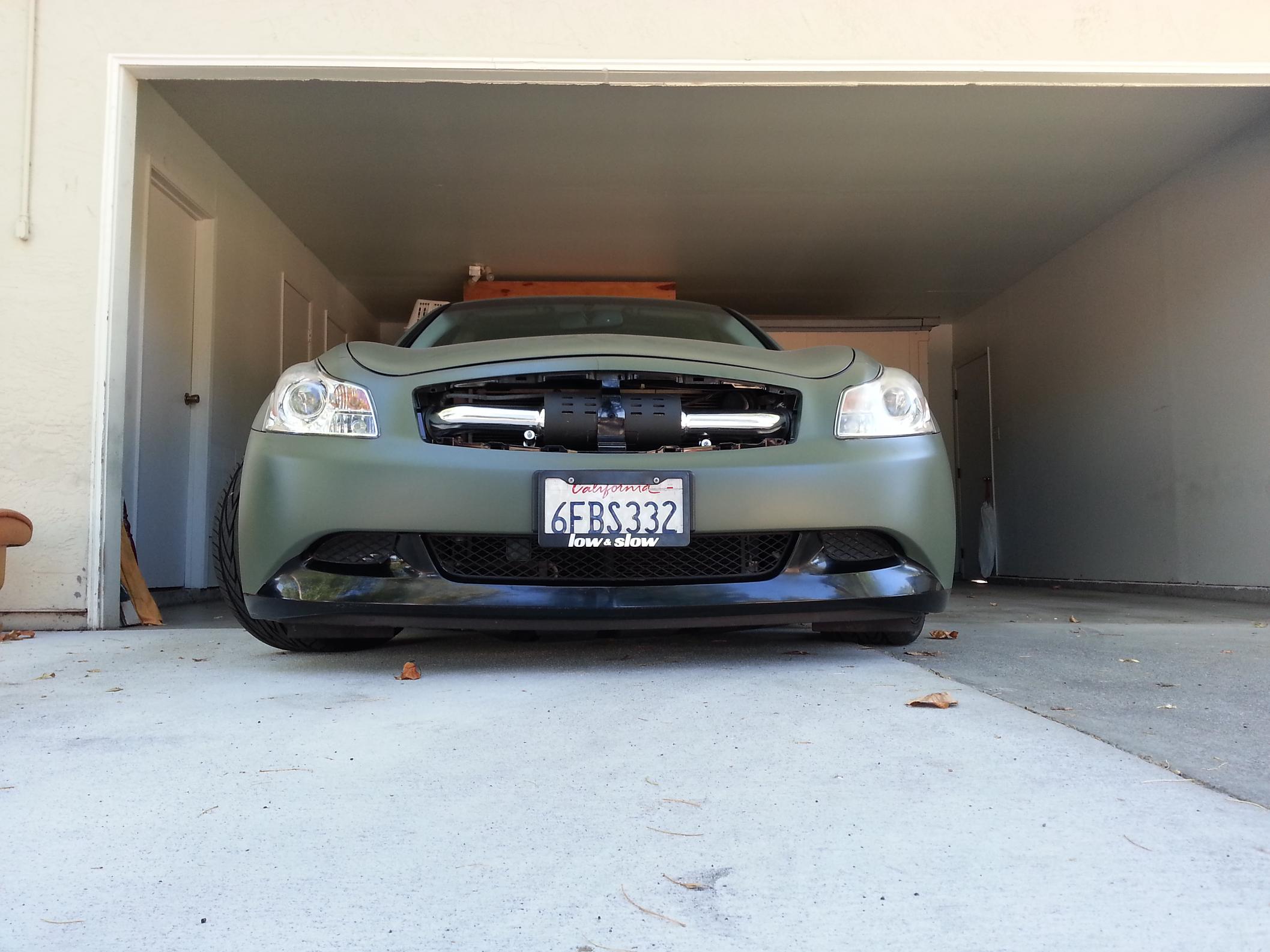

I know its been done before. But not on my car lol. I am assuming it'll be a little bit of a project since I'll be doing a section at a time after work with no prior experience. Input and tips are appreciated. I think I've read every thread about this up to date. This is a double purpose project: yes, I want my car wrapped, but I also, mainly, want to develop the skill set to wrap, so hopefully, I can wrap for $$$. I figured I'd start working with my car and friends' cars for free (materials on them) untill I am confident enough.
I JUST ordered everything needed:
- 5ft x 80ft of vinyl. Thats roughly double what I need but for the price and for trial and error extras as well as for potential fixes I got the bigger roll. $300
- 5ft x 10ft of CF vinyl for the hood/grille/trims/mirrors/maybe trunk. May need more of this if I decide to do the trunk. $65 --- I may also just do CF hood and trunk and do black roof, grille, and trims and body colored mirrors. We'll see how I feel.
- Tools. Primer/sealer/squeegees/heat gun/knifeless tape/etc. Approximately $100
So all together it came out to about $500, including all the extras.
I ordered Vvivid brand as opposed to, say, 3M or Oracal, which would have added another $400 - $500 to the cost of materials. I did not find any reviews of the brand, but could not pass up the price for practice.
Everything is supposed to arrive by late next week so I can start immediately.
Once again, tips and advice much appreciated.
