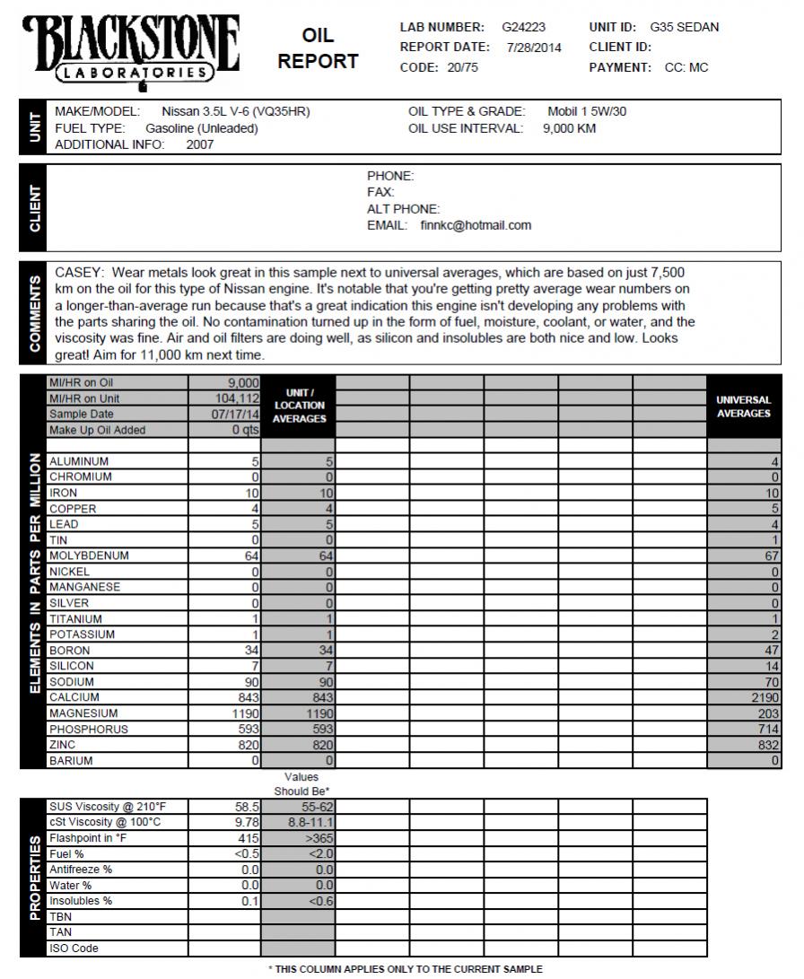

Just got it back today, thought I would share.
K&N Air Filters in factory boxes, OEM oil filters, and Mobil 1 5w-30 Full Syn.
All seems well. Will get another report next year.

Mileage on the vehicle? I didn't see it..
Old Jul 29, 2014 | 05:03 PM
Finnkc's Avatar
Joined: Sep 2011
Posts: 129
105,000km ... so 65,000 miles.

Nice. Was this the "regular" Mobil1 or the 15,000 mile extended version?

I like the comments about the air filter. I was wondering how Blackstone felt about the K&N

Nope just the regular Mobil 1 Full Syn. I too was interested to see how the K&N filters would do. It has been about one year since I dropped them in to replace the OEM ones. I had read mixed things about K&N filters. They seem to be doing their job.

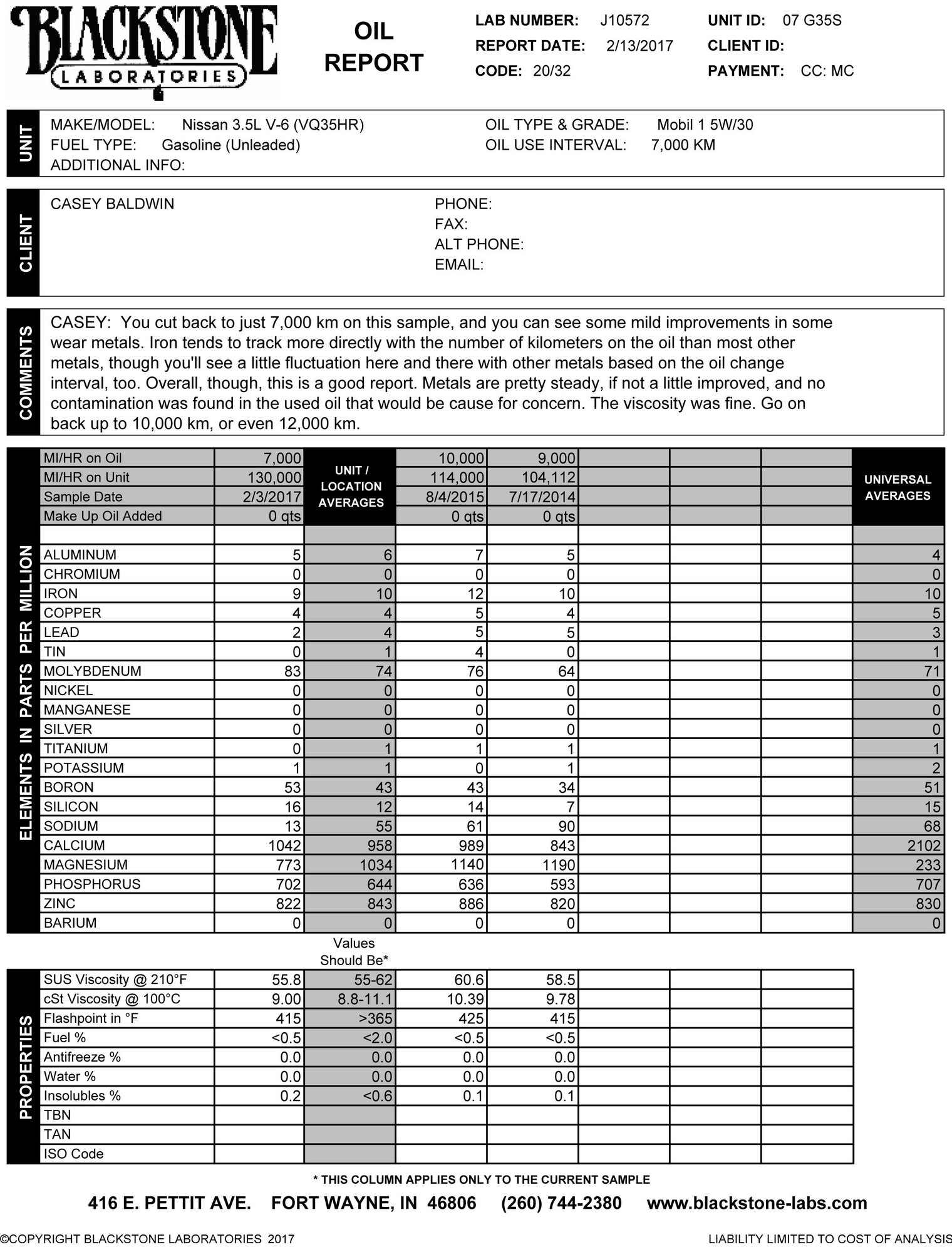

Old Feb 13, 2017 | 05:42 PM
Finnkc's Avatar
Joined: Sep 2011
Posts: 129
Got back my third Blackstone test today. If anyone is interested.
Still using the K&N drop in filters in the stock boxes. They are due for a clean I think soon.
Still using Mobil 1 5w-30
129,000 km
128,000km
Old Feb 15, 2017 | 07:05 AM
Blue Dream's Avatar
I drove ttrank's car solo
iTrader: (50)
Posts: 18,299
Likes: 1,488
From: By the sea, Tx
Still not sure what air filters have to do with metal in the oil but whatevs...............
Nice report though.
