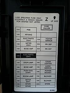

Hi,
I think the fuse blew for my 12v outlet in the centre console of my g35 but i'm not sure where the fuse box is.
I found the fuse for the cigarette lighter in the driver side fuse box, not sure if i missed the 12v outlet fuse in there but i didn't see anything on the diagram.
i checked the fuse box by the battery also but didn't see anything obvious that was for the outlet.

Its next to your foot, on the driver side there is a little cover i think its a 10a fuse.

found it on the drivers side on the left. here is the image of everything there.
power socket was the one in the center console

You will notice in there a fuse puller. Pretty useful little tool.
