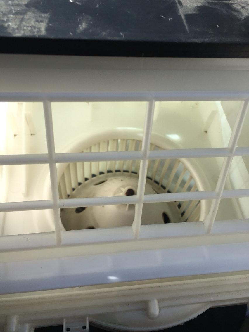

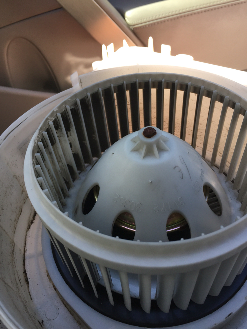

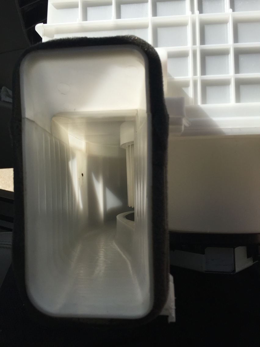

I cleaned my blower motor*, made a large post about it earlier. You need to clean yours most likely. Start with the filter (remove lower glove box).
Mildew smell when on "Fresh Air" mode-photo362.jpgMildew smell when on "Fresh Air" mode-photo27.jpgMildew smell when on "Fresh Air" mode-photo368.jpgMildew smell when on "Fresh Air" mode-photo605.jpg

I replace the in cabin air filter with carbon activated filter every early summer.
I also have been doing turn off AC and keep the fan running a minute before turn off the car. I have been doing that since this summer but still get the bad smell.
I'll clean up the blower like Urban suggested.
