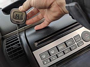

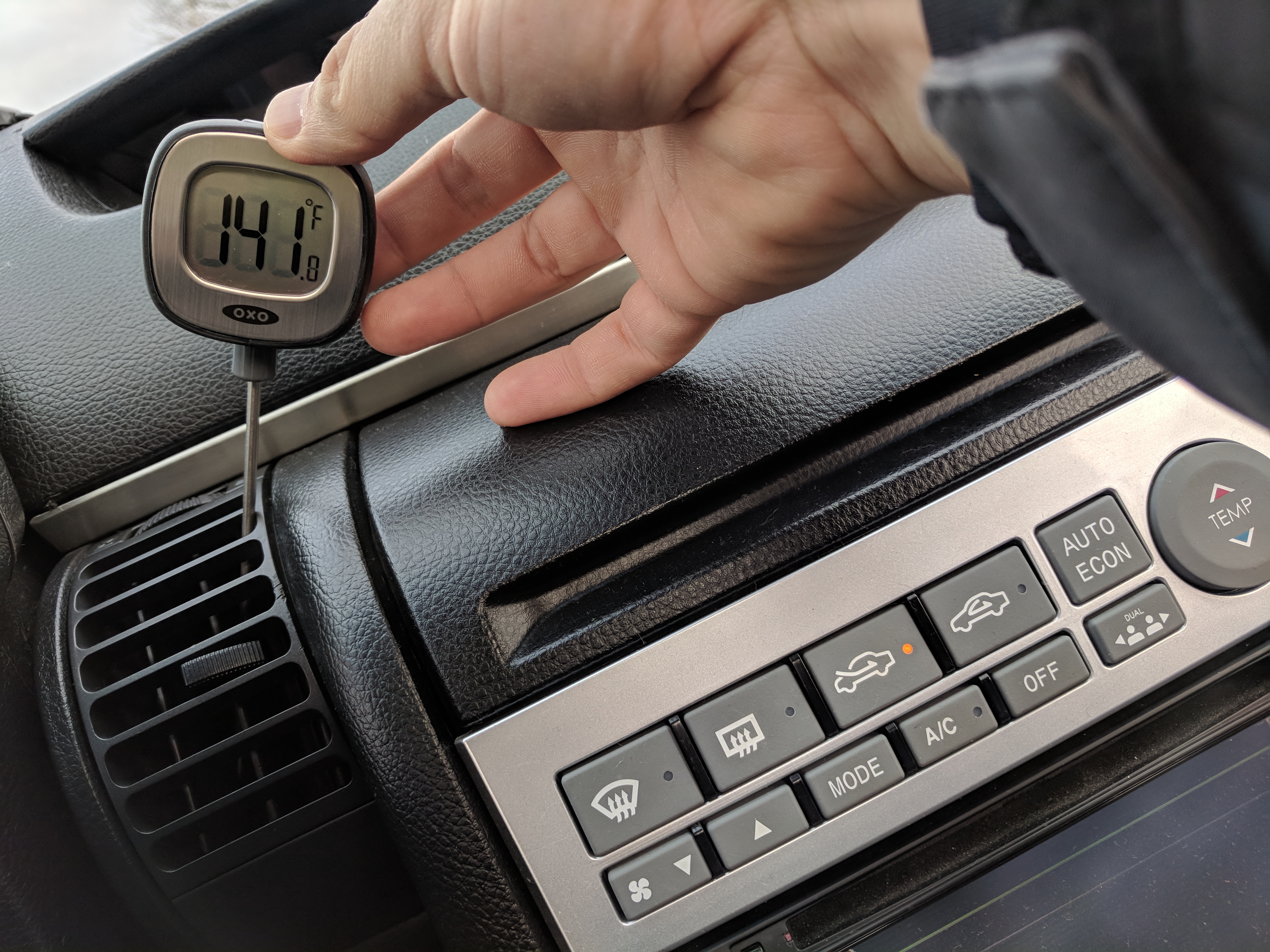

Ok Urban I took this pic today, system on high (you can see settings in the pic) but with RECIRCULATED AIR, it was a little above freezing outside (34F I think)and it was blowing 140F (60C) air out of the vent. I could see every time the thermostat opened because it would spike to 150F then trickle quickly back down to 140F.
Wasn't kidding about it being hot enough to burn your hand, hope this helps for reference.

Also keep in mind that I had the windows down, sunroof open so it was cold inside the cabin, the system throttles back considerably when inside temps reach about 60 F cabin temps even though the target temp was still at 90 F.
If you're running the nismo thermostat (or others that open at 155 F instead of the stock 170 F) then it will translate to cooler air for the AC, I believe the same would apply to a higher efficiency radiator but don't quote me on that part, I can't remember exactly where the heater core supply is drawn from.
