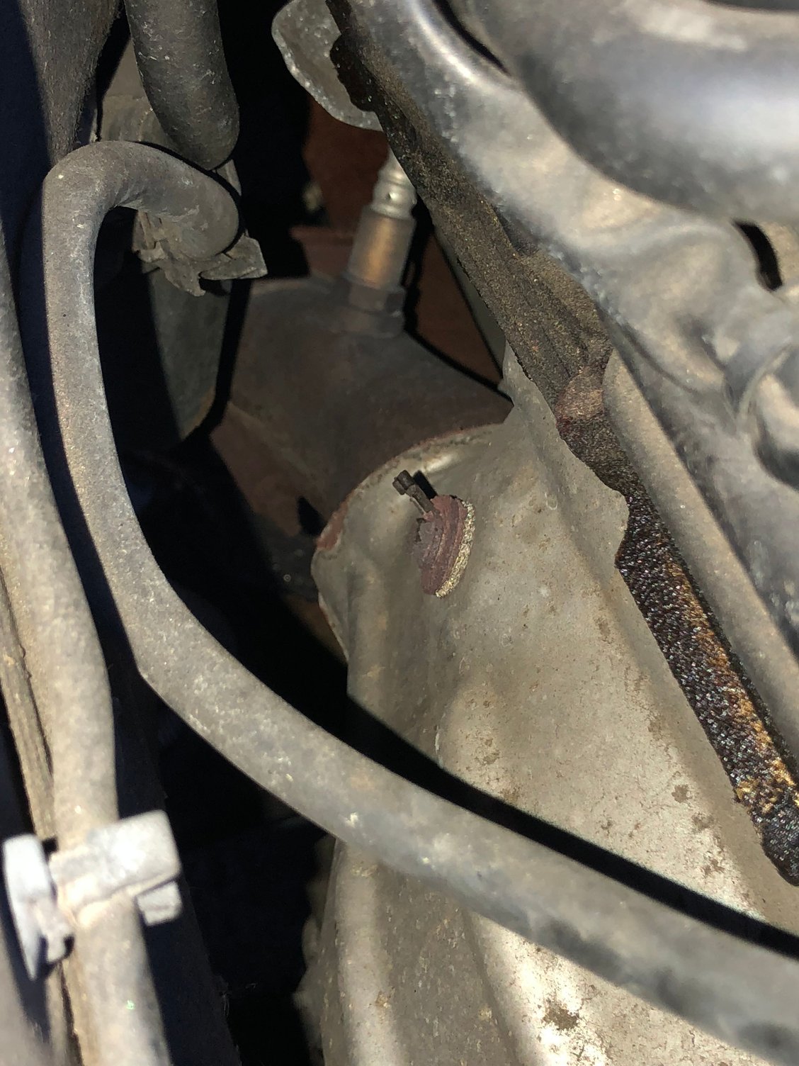

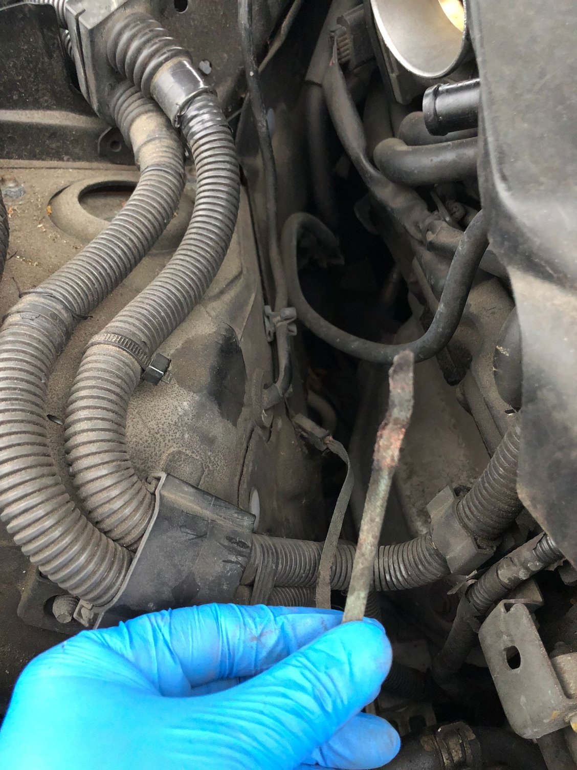

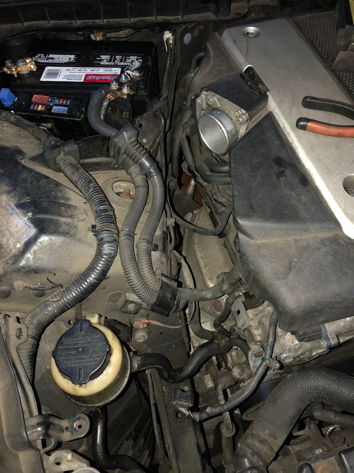

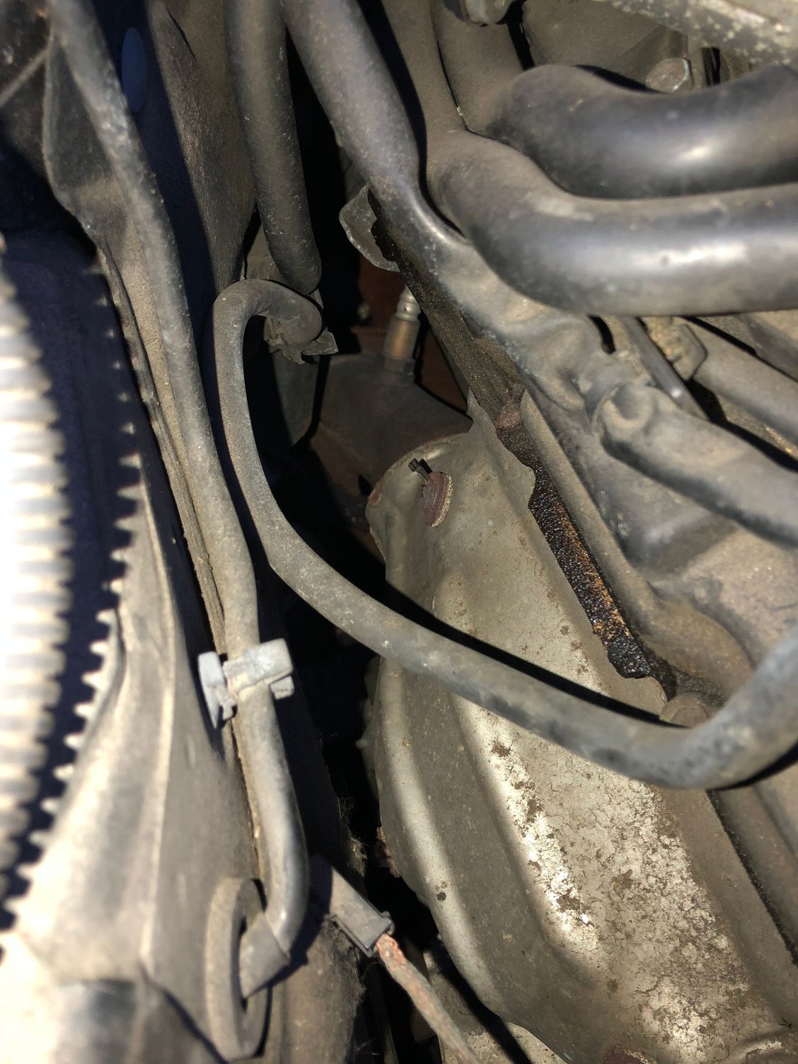

Found this wire hanging...
Close up Noticed wire or a ground missing

Would make sense if you are missing a major ground. Clean the main battery ground for now.
