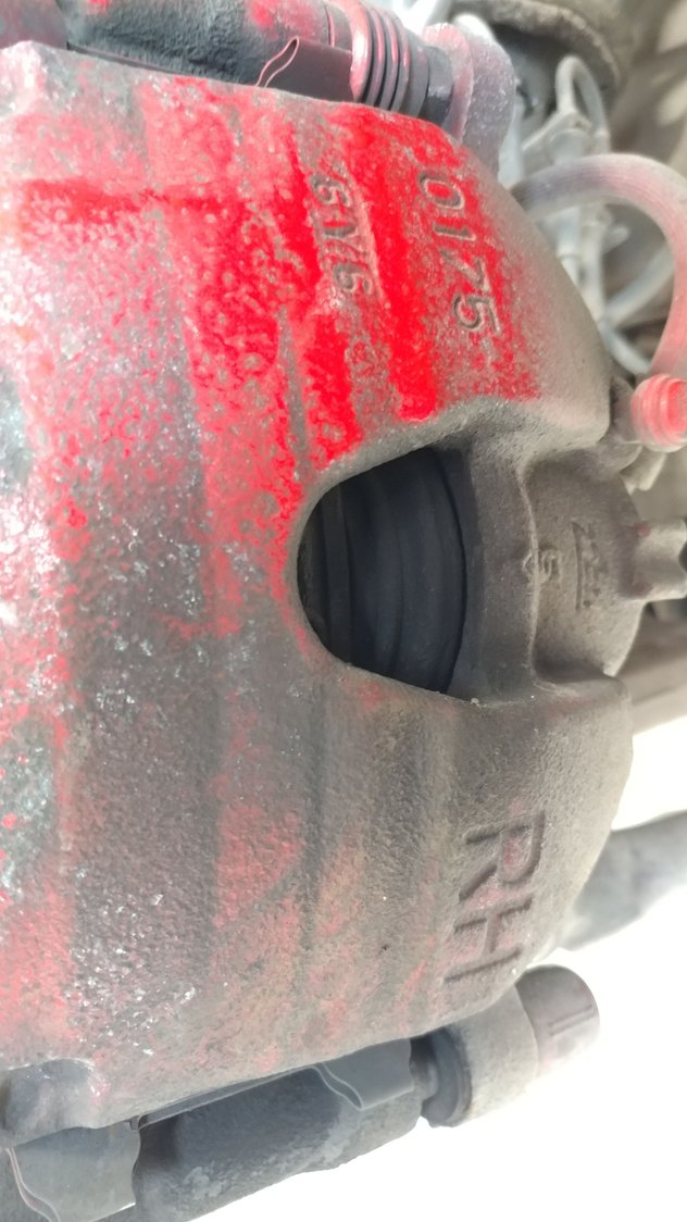

Hello!
I posted a thread a few days ago which seemed to have gone nowhere. Quick background: bought an 07 G35. Dealerships confirmed packages via VIN (this has all except sport). There are some (cosmetic?) modifications and since I need to replace brake pads, I need to identify which ones this will take.
I now have a few more pictures, which may help identify the calipers and therefore appropriate pads. One things clear, these are definitely not Brembo calipers from 03-04. They do look a lot like 07 G35 originals, but I want to confirm as I don't have access to other G35s here in the middle of nowhere in the Midwest.
The calipers seem to have been painted with the pads in them so the pads are red too, which is apparently why the mechanic did not take the pads out. He said the pads usually have a number written in the middle (visible while installed) but that part seems to have been painted over.
Rear:
Front:
My only concern is there are a few I've seen on ebay that look like these and a few that don't. Are these original base model ones or are they the sport ones? Any help will be appreciated.
Thanks

What you have are the OEM non-sport (i.e. NOT the Akebono's from the later year and NOT the brembo's from the early years) calipers that someone installed fake brembo covers on.
Base model calipers with something like THIS installed.
As soon as I saw image # 2, I got suspicious but then image # 3 was a dead giveaway ! Those are standard, non-Sport/Brembo calipers for sure.

Have your mechanic pull the pads and order standard, stock replacement pads and compare them. Pretty sure everything will match up nicely.
If I'm not mistaken, Brembo calipers are all the same basic design (surprised your mechanic didn't notice this to be honest - Brembos are common on many cars). There are piston(s) on the inboard and outboard sides of the calipers and they're not the same "floating" design like you have.

Thank you for the help everyone! Ordered the standard pads and struts yesterday.
LOL at the cheap Brembo covers, even Brembo themselves couldn't tell me these were fakes. I should've known; whoever had this car before the previous owner modified it to look like the G37 anniversary edition, changing the seats to red, the front/rear bumper and side skirts, sport wheels and a rear spoiler. I don't mind these, especially since I got it at a good price and the prepurchase inspection mechanic cleared the car of any problems, except for the aforementioned brakes/struts etc.

Originally Posted by Hall Stevenson
According to Infiniti's own parts website, an '07 G35 sedan with "sport type grade" trim comes with a single-piston, floating-style caliper, not Brembo or Akebono style.
I also have a "spec sheet" but it's for 2008, not 2007, but I wonder how much changed.... Anyway, it says the Sport trim is only available with manual transmissions. Do you have auto or manual ?
It is an auto with shifter paddles, which came with the tech package according to a dealership I talked to. Again, a few dealerships I talked to said this car/VIN did not have a factory installed sport package.
Go here, https://parts.infinitiusa.com/infini...on=replacement, and input your VIN and see what brakes it lists. I believe even the drawings are accurate. Take the brake pad part number it gives you and go here, https://www.brakepartsinc.com/raybes...terchange.html. Input the Infiniti p/n (without the "-"), select "is exactly" and search. From my OEM p/n, it gives me the Raybestos pad (that I have sitting in my garage waiting to go on the car someday).
So the dealerships say no sports package, and going from the pictures, the consensus here seems to be the brake calipers are OEM non-sport calipers which should take non-sport pads. BUT, from the infinitiusa.com link above, when I entered my VIN and followed those directions, it specified sport grade brakes, which lead to sport package Akebono pads as well.
I have already ordered non-sport pads and struts. I hope that wasn't a mistake.

When I input D1060JK000 at Raybestos, it tells me their equivalent parts are 1287 variants (PGD1287, EHT1287, etc, etc). They have (4) choices and have pictures for (2) of them. If their pictures are representative, they are "standard" pads.
https://www.brakepartsinc.com/.imagi...1287CH_FRO.jpg
https://www.brakepartsinc.com/.imagi...D1287C_FRO.jpg
It's looking more and more like cleric said, it might have have "Sport" brakes but they've been swapped with standard brakes. That's clearly what you have on the car based on the pictures.
