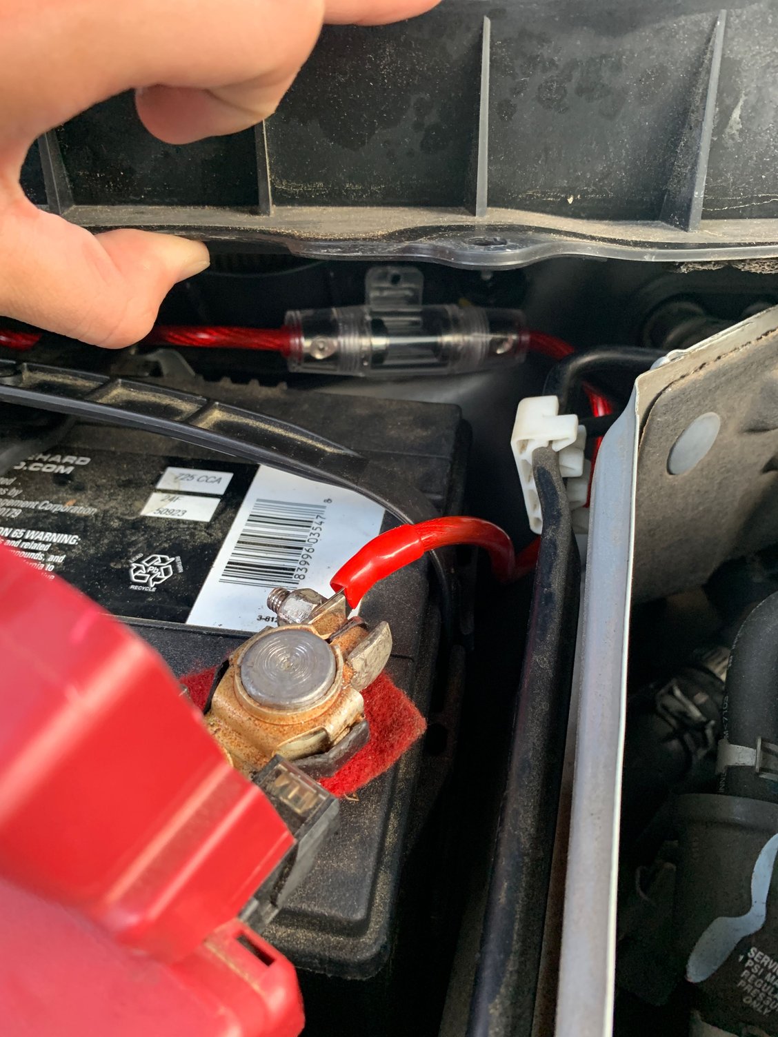

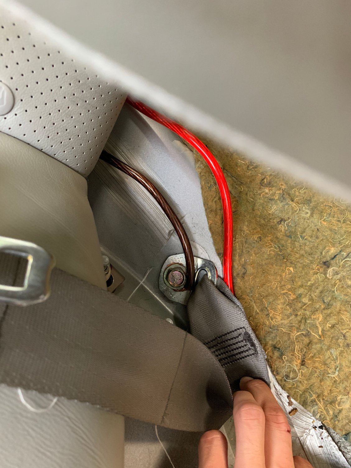

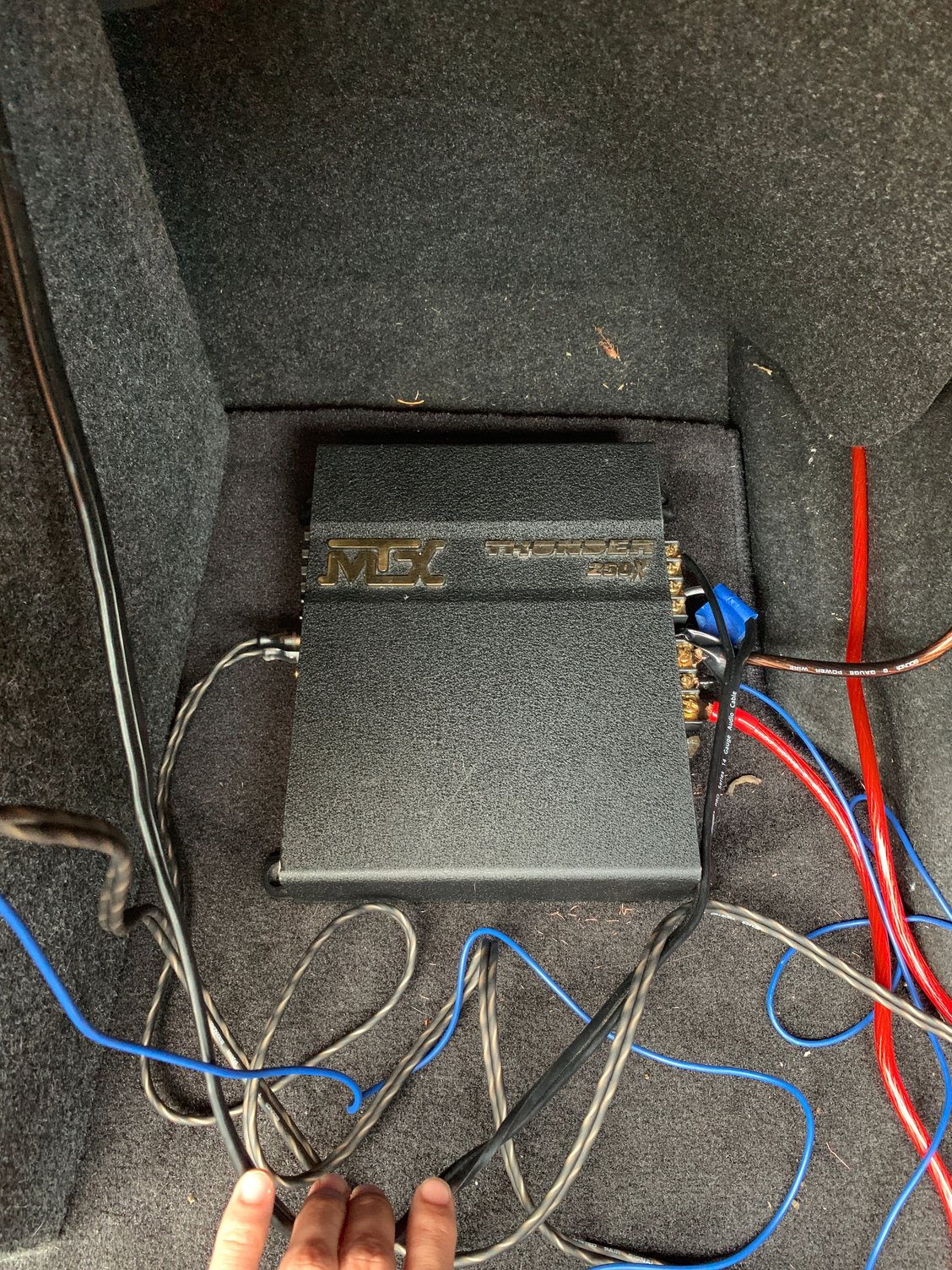

Hi me and my pops tried to add a amp and sub to my 2007 g35s with the full tech package along with the Bose system. We have everything hooked up but we can’t seem to get any power to the amp, any ideas?

Your blue remote wire should trigger the amp to come on. Looks like u have your wires hooked up correctly.
Check to see if the blue wire is getting power when u turn your stereo on. Make sure the fuse on your amp isnt popped.

So we tried it and still got no power. We tried different terminals and made sure they were tight. Any other clue what it could be?

U sure your blue remote wire is tapped imto the correct wire on that harness?
Does the amp turn on if u touch the blue wire to the Red main power cable?

I believe all wires are connected to the right ones on the harness, but we're not sure if maybe the wires are too small to make a connection. Haven't tried connecting the blue wire to the main power cable.

Jump the blue remote terminal to the red power cable terminal on the amp. The amp should turn on that way. If it doesnt, then the amp is probably busted.

use a multimeter to check. you can easily check if your amp is getting power and then double check the voltage on that trigger wire

Yeah so I tried the rem wire with the power wire and nothing worked I believe the amp might be done after this, but thanks for the help!

Sounds like you should get it tested yes.
