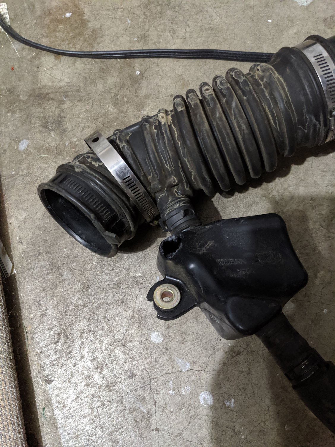

Not sure if this was the only issue, but I found this today. There's a giant hole in the intake resonator.
I replaced the factory intake with a super cheap "cold air" intake. I took it for a quick test drive and it seems better, but not completely fixed yet. Do I need to do a reset, or should I just expect it to smooth out over time?

Old Sep 5, 2019 | 02:03 AM
Urbanengineer's Avatar
Joined: Jun 2013
Posts: 11,174
Likes: 1,044
From: OH-IO
If you do the reset it will fix itself immediately .
