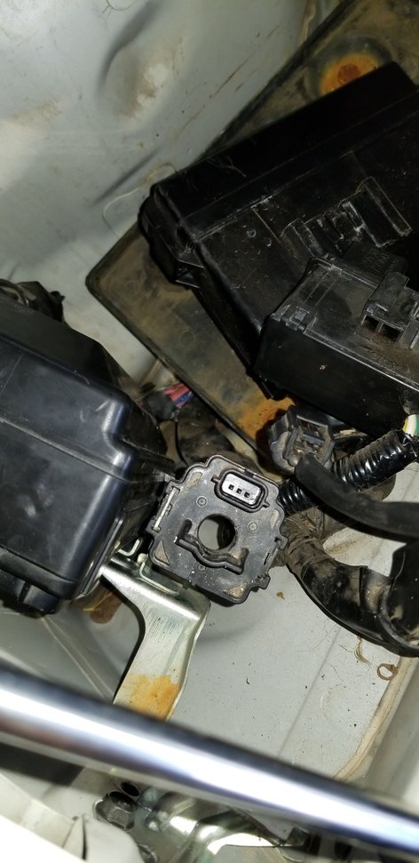

Odd topic line, but here goes. 2007 G35 Journey. Battery light came on the other day and stayed on all the way home (39 miles). Checked alternator output and it showed 11.63vdc. Battery previously had shown 12.62vdc. Charged the battery and still have the light and low output. Removed the battery and alternator (alternator is 14 mos. old, battery ~18 months) and had both tested at a local NAPA. Both test good. While there I got a negative cable since mine wasn't as tight as it needed to be (yet was as tight as I could get it, perhaps it's the whole problem). Anyway, the old cable is routed through what looks like it might be a current detector (see the pic). I had to cut the old cable to get it out as neither connection end would go through and, of course, the new cable won't fit through either! Grrr…. So, what I need to know is does the negative cable have to be routed through this device? Tom

Yes the cable needs to go through that CT, should be Nissan part number 24080-JK60A Cable Assy - Battery Earth. Your local Nissan will have them in stock, it's an assembly with the wire and the CT together, they cost like $50 new.

New ground installed. Alternator output is 14.5vdc and battery light is out. I went to the dealer and a mechanic confirmed that it is a current sensor. Parts looked it up and it doesn't show it under a 2007, but 2008 did. Their price is $106. An online dealer shows it for $47. Fortunately it doesn't look like I need it.

Actually, no. One, the site I use breaks it down by specific sub-model. You can also find parts by vin. The site is run by an Infiniti dealer. Second the part number was the same as I got from the local dealer. Anyway, hopefully the ground cable resolved the issue.
