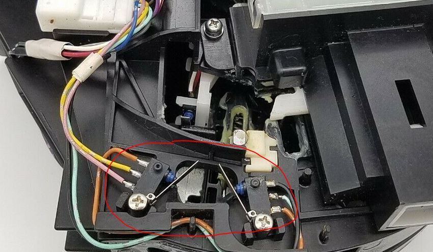

i was thinking about "bending" that small metal arm, but it's not exactly fixed in place, there is some pivoting to it. here's what it looks like:

That's exactly what I was thinking they might look like. If you press the arms gently against the switch (plunger) itself, do you hear it click ? It might not unless it's powered though. If it does appear to click normally and consistently, I wouldn't hesitate to bend the arms in order to apply more pressure to the switch. Just don't bend it too far that the gear shifter doesn't reach it well enough.
Is there just that single screw holding each switch in ? If so, if that screw isn't tight, the switches may pivot, moving closer or away from the mechanism that engages the switches. Or is that what you mean by "there is some pivoting" ? I would think there shouldn't be. Maybe the two outside protrusions lock it in position ?

yeah, it clicks, but the gear doesn't change with just a click - you have to keep pushing it in some more.
re: pivoting. if you look at the top left/right of each respective screw, the arms attach to a pivoting point. they are not rigidly attached at the bottom, so that's why i was hesitant on trying to bend them without the risk of breaking them off.

just to update. the manu mode switch ended up failing a few months back, so i swapped the new assembly in. pretty easy job, tho the unit i got was for the coupe and the metal arm that connects to the tranny was shaped differently, so had to swap the guts over to the old one. easy repair other than sweating over trying not to break the plastic trim crap.
