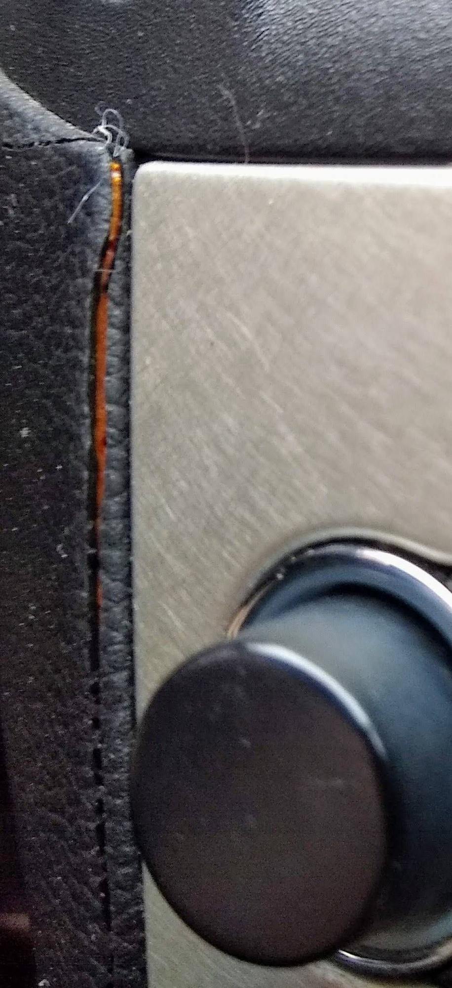

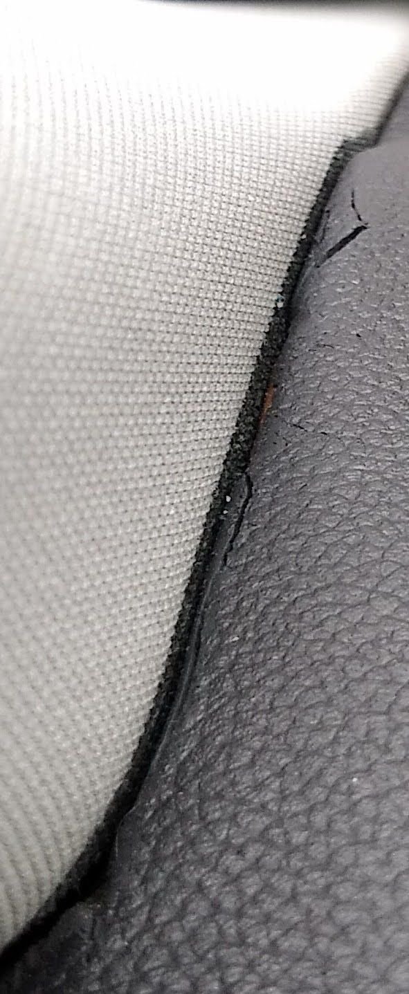

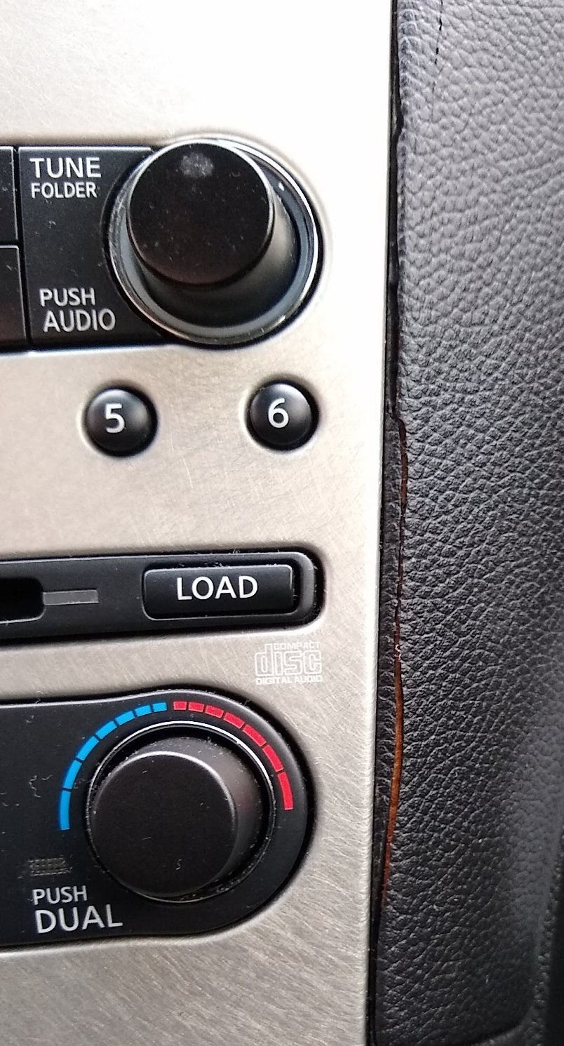

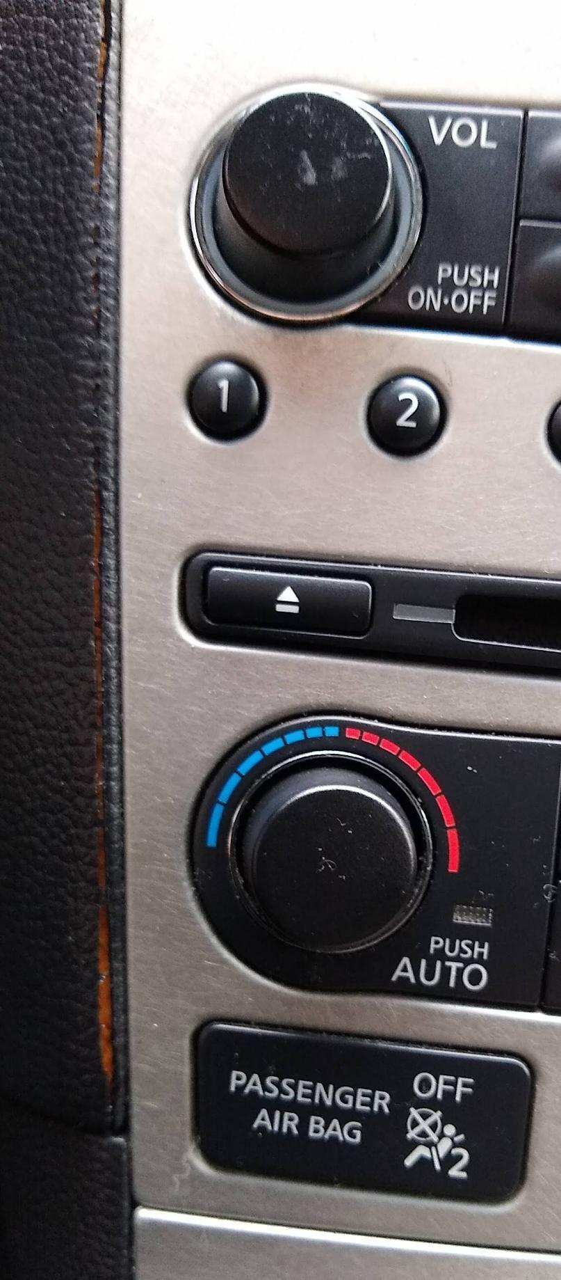

Hi All ~ Regarding 2007 G35X
Initial problem was car not starting.
Towed to shop 7-2-19. Shop called and asked if I had problem with water in car. Told them no, I had never noticed any. They found driver side floor wet and thought this was causing problem with no start. Said sunroof tubing needed to be cleaned. Sounded reasonable, so I ok’d fixing that. I asked them to change the cabin air filter at that time also.
Two weeks later, roughly, there was water again ~ mostly contained to the floor of the back seat. It was about an inch of water! And the car wouldn’t start. Towed again. I was told that something was done incorrectly the first time when sunroof tubing was drained but that all was good now. Btw, I came here to educate myself when they initially told me about water in the car. I recommended this site to them and explained that there are some extremely knowledgeable people here and it seems there are some specific things to check concerning Infinitis with water problems. I don’t think my recommendation was well received.

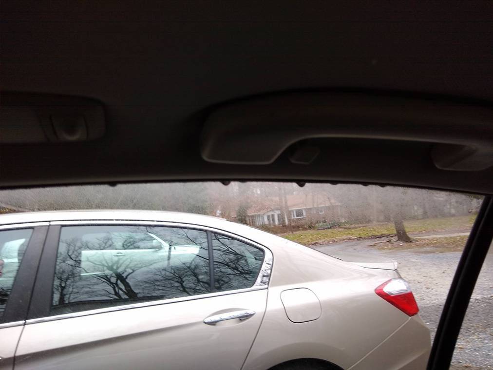

A couple weeks later, end of August ~ I noticed that after a rain, the windows would have condensation on them. I looked in the car and found it was full of mold because water was still getting in (so much for that new cabin air filter) Again, the car wouldn’t start and needed to be towed. It was at the shop from 8-29-19 to 11-5-19. When done, I was again assured that no water was getting in. As I drove away after picking car up, I noticed something flicker on the dash. My first thought was, “Oh no, something electrical is loose now.” “They are really gonna hate me.” I only saw that flicker once. Then it got dark and I turned the headlights on. All fine until the dashboard lights suddenly went off. I was very close to home so I just kept going. I thought about calling but figured I would wait and see how things went. I didn’t want them to think I was just one of those people who are impossible to please. Can’t add more about dashboard lights as I didn’t drive at night after this. I just wasn’t convinced the car was really fixed and I didn’t want to get stranded. I was actually only able to drive one or two more times before the car would no longer start. As much as I wanted to call, I just couldn’t bring myself to do it. So I’ve been here with no car for more than a year now. I just didn’t know what to do to solve this problem.
On 11-5-20, I received a text from brother of shop owner asking if all was good since I have not been at the shop for over a year. I wrote back and explained some of this. He responded that he would have the service manager contact me.
Service manager called on 11-9-20. He was very nice and said he would call me back. I had the impression it would be that same week but I never heard back from him. I was trying to be patient in waiting to hear back.
Monday 12-14-20 I received a letter from my landlord stating that I “have to do something about my car that’s been sitting outside taking up space”, or he will initiate removing it by end of the year. I’m out of time and can no longer be patient.
Tuesday 12-15-20 I texted brother of owner again, explained that service mgr did call me, was going to call me back…but hasn’t. No reply from brother.
Wednesday 12-16-20 Because I’m running out of time, I thought maybe I’d just try to sell the car without waiting to hear back. I went out to check the inside. I took pictures. There are water droplets hanging from two areas, so it seems water problem is still not fixed. The dash/instrument panel cover is chipped and cracked in so many places it’s truly inconceivable that this was done to my car and nothing was said. I noticed one area when I picked the car up but decided to let it go because I thought the car was finally, truly fixed and I didn’t want to be a pain. I’m guessing the other areas were there also but have worsened with the cold weather and are now quite visible. (Remember, I was only able to drive the car once or twice after picking it up last time…not a lot of time to notice these issues)
So...I had a car that wouldn’t start ~ but the dash looked fine and it didn’t have a problem with water.
I spent $1149.76 to fix it.

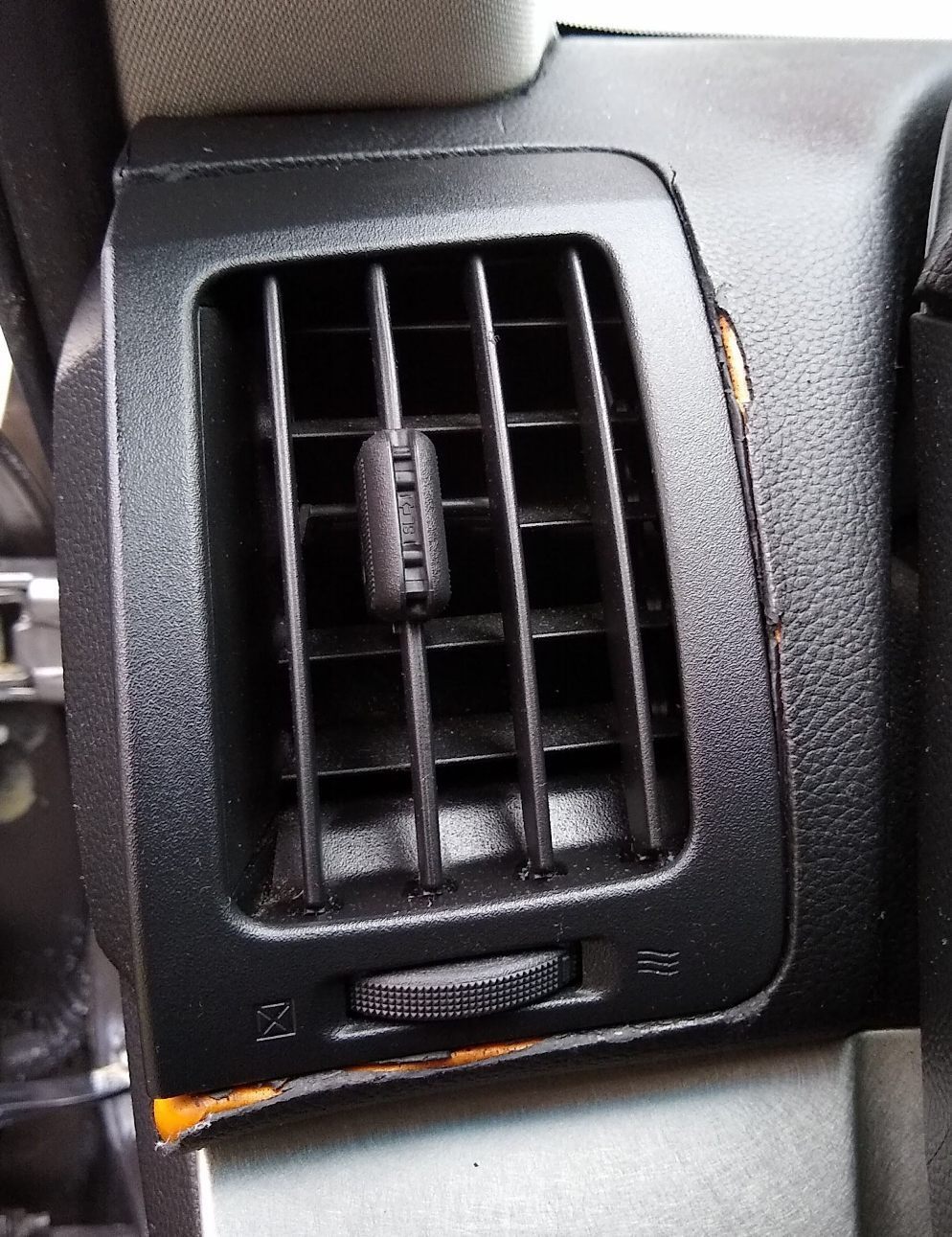

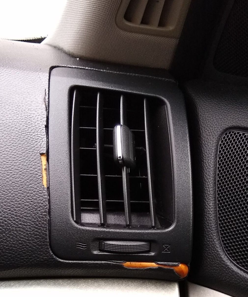

Now I have a car that still won’t start, seems to have unending problems with water getting inside, and it looks like someone took a knife to the stuff you see while sitting in the front seats…the air vents, the radio, parts of the dash, etc.
I’ve always had it in my head that if I found myself in a financial bind
, I could sell the car as Infinitis hold their value very well. I checked Kelley Blue Book. A 2007 Infiniti with my mileage, in good condition (which is no longer accurate but would have beenhad it actually beenfixed and not been damaged as it is) has a private party value range of $4627-$6416, with a private party value listed at $5522. However, I can’t imagine that anyone will want to buy this car now.
I currently have nothing of value. But I should have a car worth around $5522, that I should be able to sell right now, but I can’t do that as I just discovered.
I'm curious what others would do as far as the shop? What would your expectations be?
Thanks for taking the time to read and offer opinions.
Dash
Water droplets on rear window, from inside looking out. Same on front window.

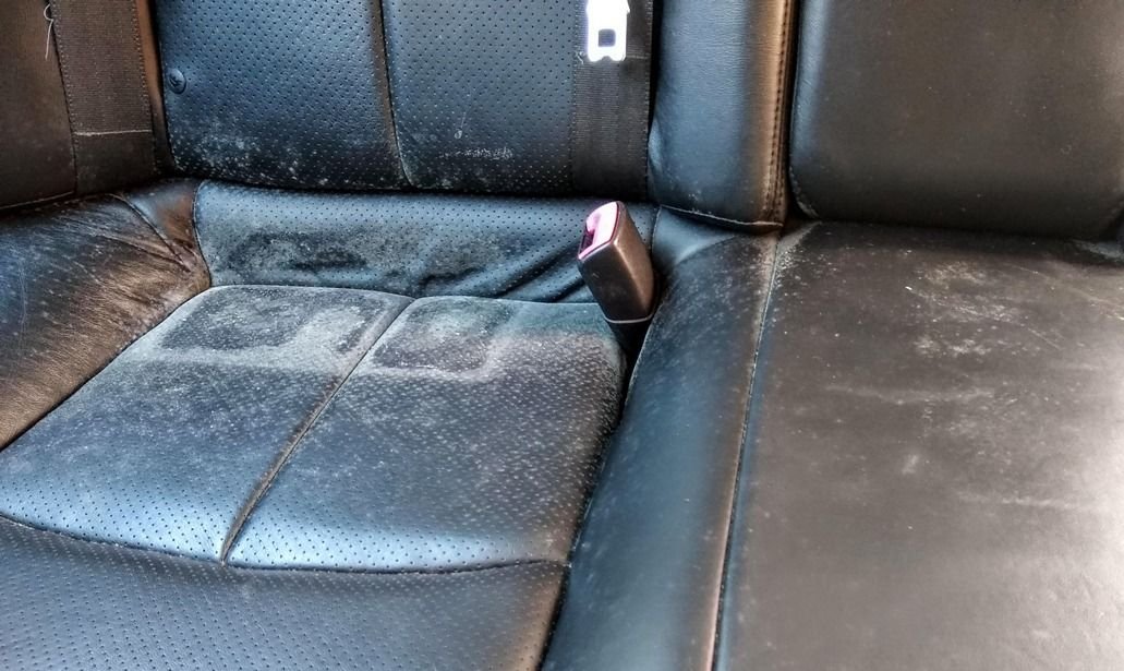

Mold...random pic. This was all over. How could this be gone, even after cleaning? Especially since water continues!

Holy hell! They destroyed your interior!
I would be pissed. Go there and ask them for all the money back. Even a few hundred more on top, to cover the damage. Then take it to someone who really knows how to find and fix leaks.

As for the problems with the car, there are multiple sunroof drains, not just the cowl drain in the front. It sounds like they didn't clean them very well and BOTH are still plugged.
Since you will be PAYING a shop to do repair work I suggest you mark the car at something around $3500 (expect to accept a lower offer like 2750-3000) just to offload the vehicle, be upfront in the seller description that it has plugged sunroof drains and water damage to the interior of the vehicle and thus the lower price.
A lot of that interior damage can be masked with a black sharpie and some black silicone/caulk. Squirt the caulk onto a piece of cardboard and carefully fill the crack using a popsicle stick and your finger.. Have some paper towels and isopropyl alcohol handy to wipe down the area carefully when you're done to remove any extra silicone. It will look 100x better than it does right now, will only cost about $20.
The dash issues are probably because water is leaking onto the BCM in the driver footwell, it's basically the computer that controls all the non-engine functions. It's a fairly common problem with plugged sunroof drains since the water typically pours out right on top of it.
As for the legalities of going after the shop for shoddy work, this one you're going to have a really hard time with because of the amount of time that's elapsed since they did the work. I would see what the service manager says about these problems but don't hold your breath. And even if they fix the sunroof drain problems you're still going to likely have BCM issues which is beyond the scope of their liability.
