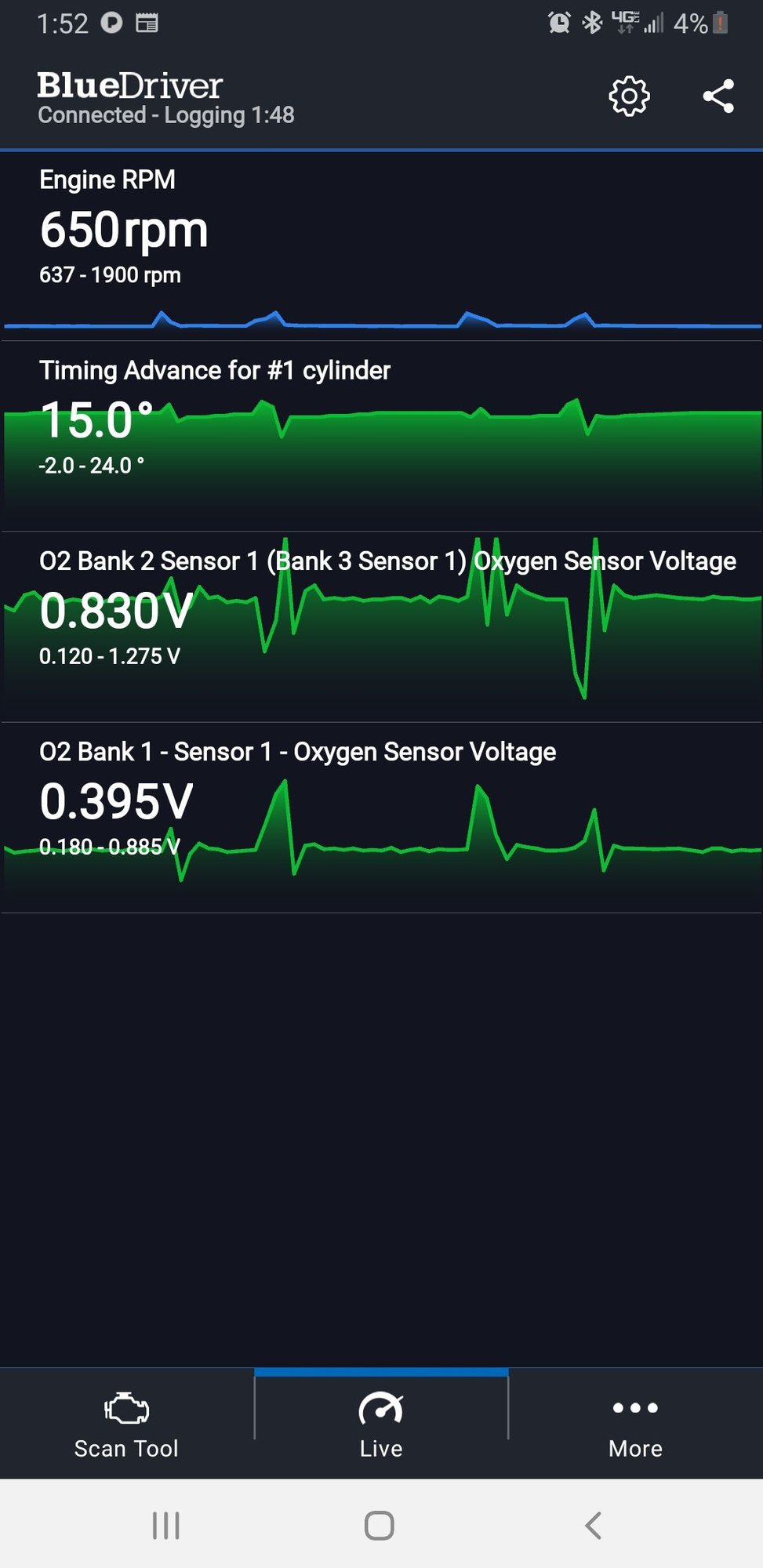

Is this normal for timing advance?

Is that the timing advance at idle?

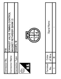

Alright so here's what I found, on that harness F41, you should be testing resistance on pins 1 and 2. That harness is viewed as the part that goes back to the ECM so you will need to mirror it to test the side with the actuator.
Verify the same ohms reading with the driver side.

Yep. 15.9 ohms between 1 and 2

This is at idle
