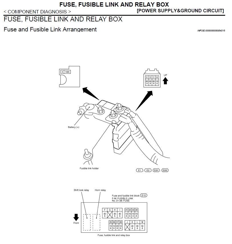

Ok... starting over, your trip odometer resetting is probably a blown fuse preventing full-time power from reaching the instrument panel when the car is turned off.
Check fusible link slot C and K
Check IPDM fuses 50, 51
Check Fuse Block - J/B (cabin) fuses 11, 6, 4, 19, 3, 10
My gut it telling me it's FB-J/B fuse 11.
Old Mar 12, 2021 | 07:24 PM
Brad6080's Avatar
Joined: Oct 2020
Posts: 78
base 04 sedan and 07 sport sedan
Well. I feel stupid. There isn't even a fuse in location 11. Gonna run to the store and grab one. Got my fingers crossed
Old Mar 12, 2021 | 07:39 PM
Brad6080's Avatar
Joined: Oct 2020
Posts: 78
I now have a security light in the dash, the dash lights are keeping their setting, and the lcd is staying on the mpg/average speed setting when i kill it. I can't thank you enough. My ocd was driving me nuts. Now if i can just figure out the random codes. I found 1 ground loose, but it was the small one for the headlights on the passenger side fender. Gonna keep looking. Thank you again

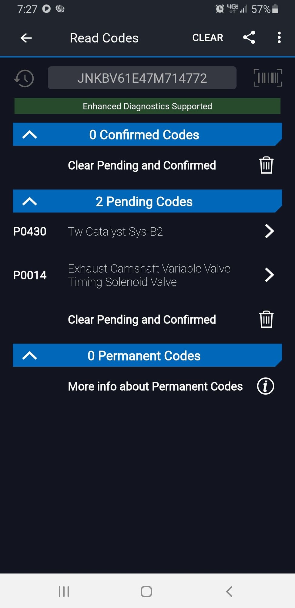

Old Mar 12, 2021 | 08:30 PM
Brad6080's Avatar
Joined: Oct 2020
Posts: 78
These come back pretty much every time i hit a bump. It has test pipes so that explains one. The other is the one I'm really worried about
