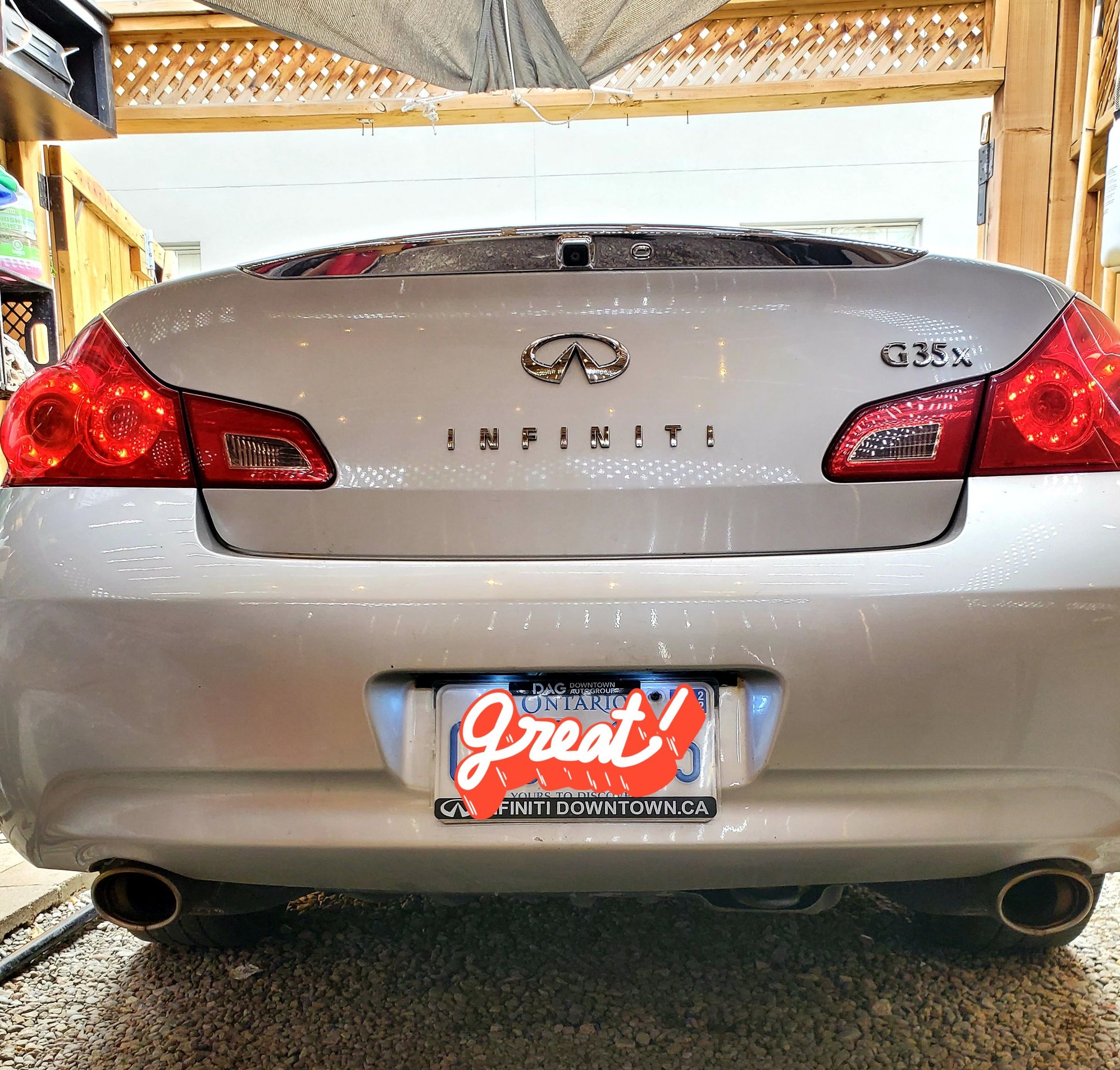

Anyone else have their license plate light support bar in the rear bumper rusted out
Notice the bulb hanging in front of my rear plate today .
Checked it out.
The support bar that holds the license plate bulbs was totally rusted out, and crumbled like old crusty bread.
This can't be normal ?
Anyone else experience this

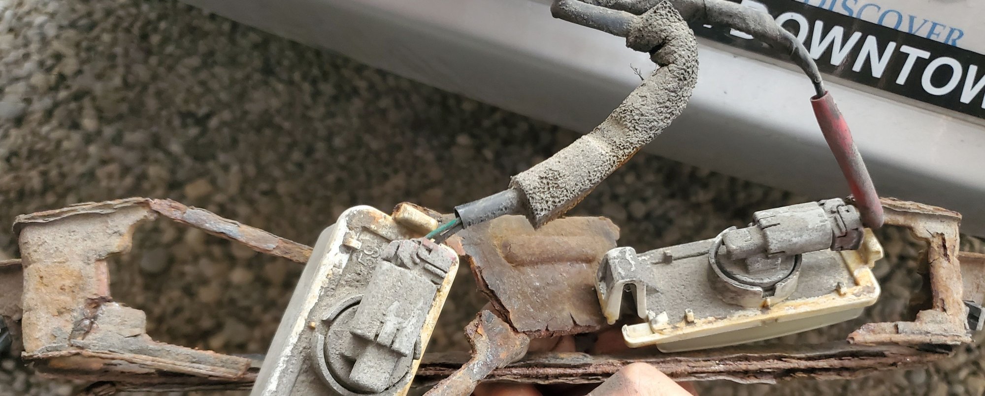

Started poking around. The rust crumbled like breadcrumbs.

Some of the remaining metal was still good enough (questionable).
I live in a city where junkyards are not allowed, and the closest one is 2 hours away.
Metal wire is a temporary solution for now, and gets me back on the road legally.

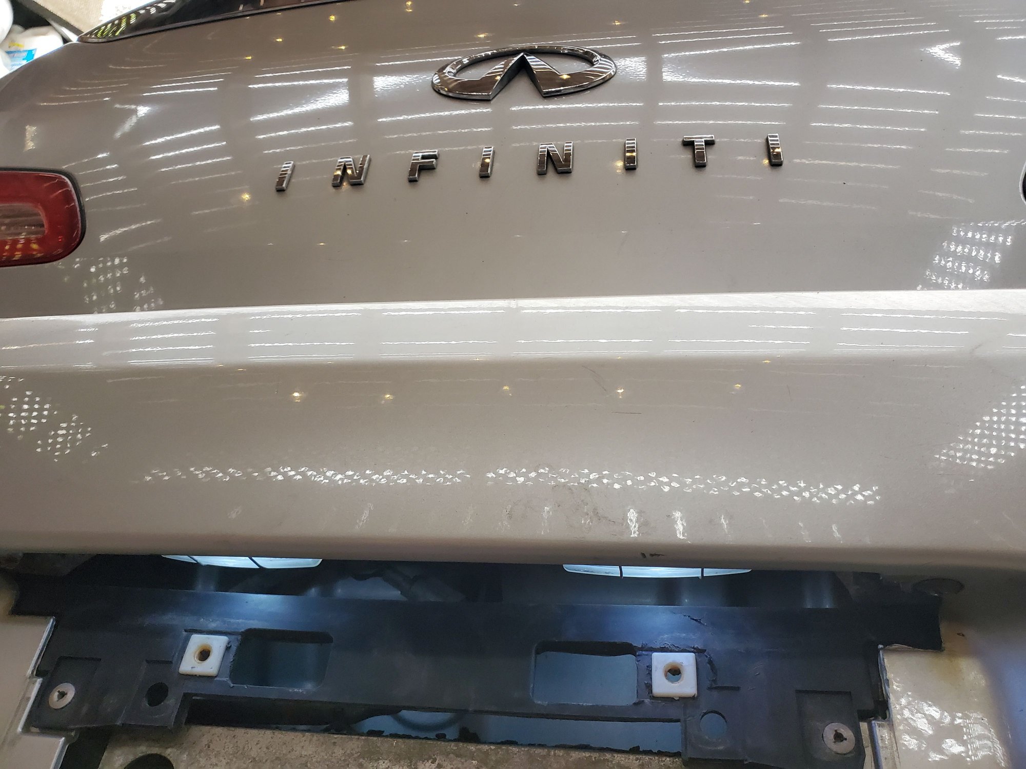

Can't tell.
Nothing happened.

This is an easy, permanent repair - just buy the replacement part and a few minutes later it is fixed! Several good threads in this forum. Here is one I participated in
https://g35driver.com/forums/g35-sed...g35-sedan.html
Old Sep 2, 2021 | 06:04 PM
user 7202's Avatar
Joined: Jun 2017
Posts: 4
I used an epoxy glue and glued the bulb housings to the inside of the bumper skin. Worked for 3 years now.
Old Sep 4, 2021 | 07:46 PM
cleric670's Avatar
BANNED!!!
Joined: May 2017
Posts: 14,837
Likes: 2,497
From: Washington State
Coupe 6MT Premium RAS
You can buy those license plate brackets on eBay, then spray it with truck bed liner or cold-galvanizing spray, or something to protect it from the salt on the road in winter.
EDIT: Or use the 3M body tape and just tape your license plate on.
Old Sep 8, 2021 | 02:03 PM
MikeG35Coupe's Avatar
20 Year Member
Joined: Dec 2003
Posts: 677
Likes: 89
From: Rhode Island
One owner 2004 G35 Coupe 6MT
The bracket on my coupe disintegrated like that. I replaced it a couple of weeks ago with one from eBay, for about half of what the new ones go for (which keep increasing in price every year). Silly me thought it would be easier to replace it if I took the rear bumper cover off, but when I attempted that I found the brackets that connect the cover to the body were also just as rotted. I ended up buying new brackets for about $40 a piece.

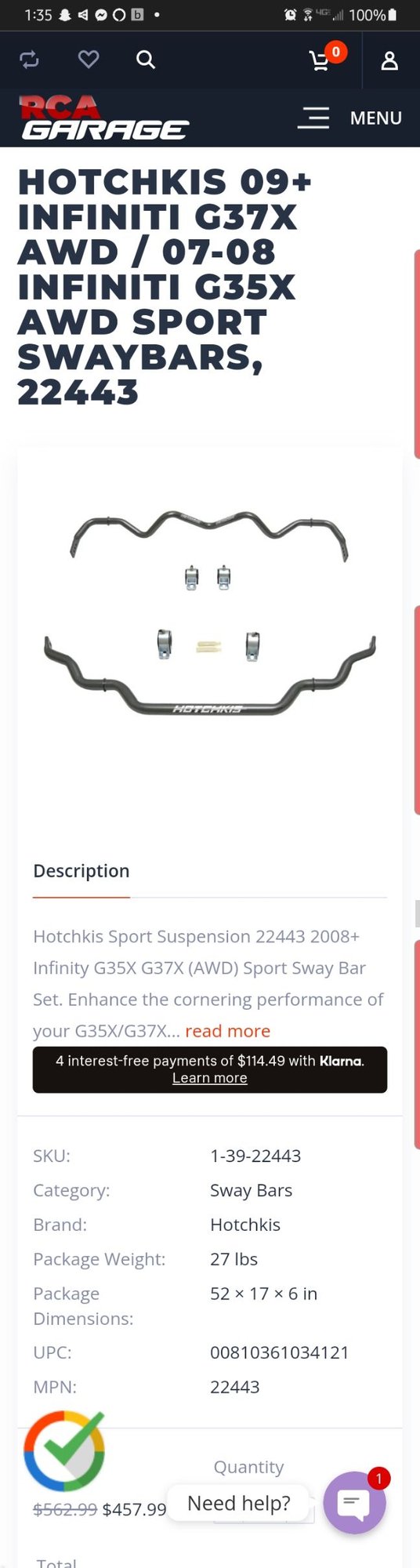

I'm having a rear end wobble/sway when cornering. my car is a 2007 G35x sedan with 232k on it. My 4th G sedan started with a 03, then 04, then 06 they looked dated so I ended getting a 07 sedan. I'm sure that the rear W brace is rusted , im in a wheelchair so getting on the ground or under the vehicle is difficult. I'm gonna have to give the rear end a good looking over, any suggestions where to start?. I did the shocks & wheel bearings. Gonna be replacing a brake line on the rear drivers side. So while it's up in air I'll give the trailing arms and other bushings a good inspection , as good as I can see, I notice the rear rear sway bar is a quite small , been thinking of upgrading to the hotchkiss front and rear sway bars
, the rear is adjustable. I appreciate any suggestions or advice you can give. I dont wanna just keep throwing parts at it. But I love the car and like to drive it like it's supposed to be driven. Again appreciate your opinion & advice.
