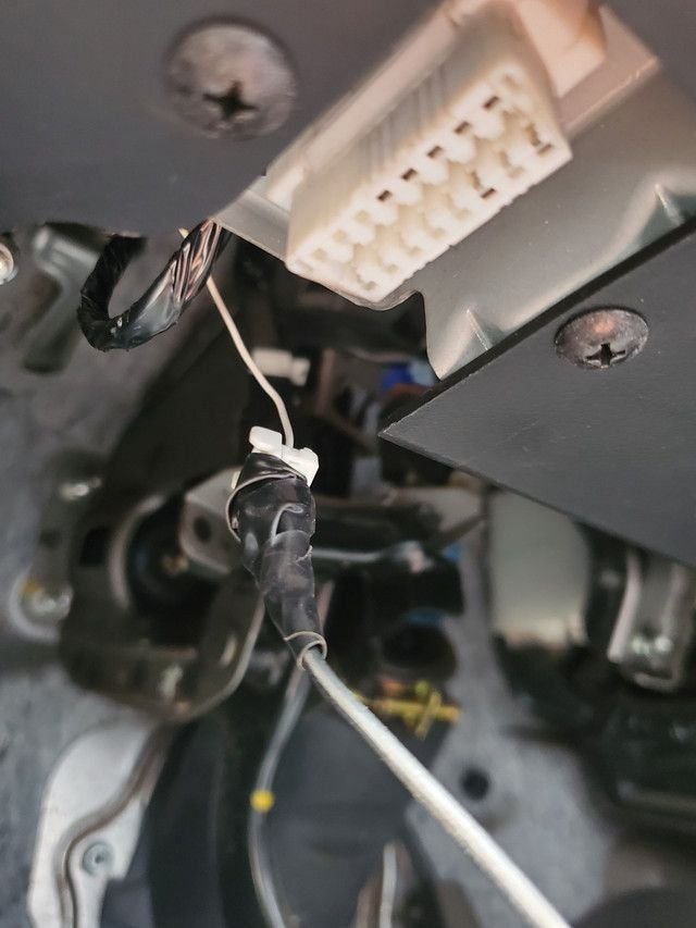

Old Nov 3, 2021 | 05:10 PM
909's Avatar
909
Joined: Dec 2018
Posts: 381
Likes: 48
Your mom's boyfriend
Notice the white cable and white plug

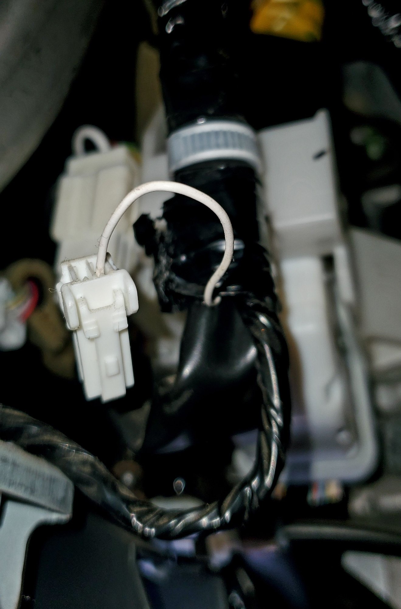

Old Nov 3, 2021 | 05:12 PM
909's Avatar
909
Joined: Dec 2018
Posts: 381
Likes: 48
Stick a piece of wire inside the plug

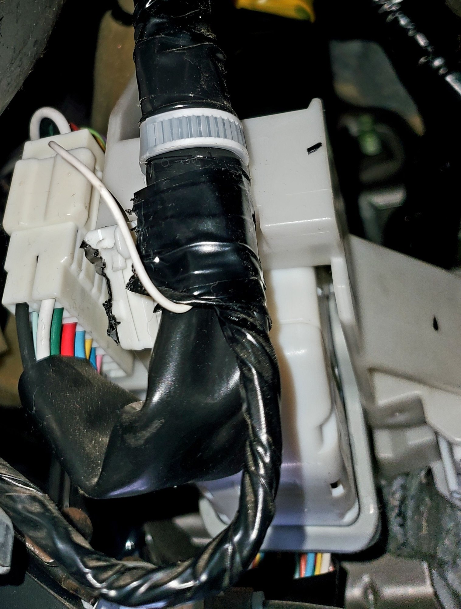

Old Nov 3, 2021 | 05:14 PM
909's Avatar
909
Joined: Dec 2018
Posts: 381
Likes: 48
Tape the wire

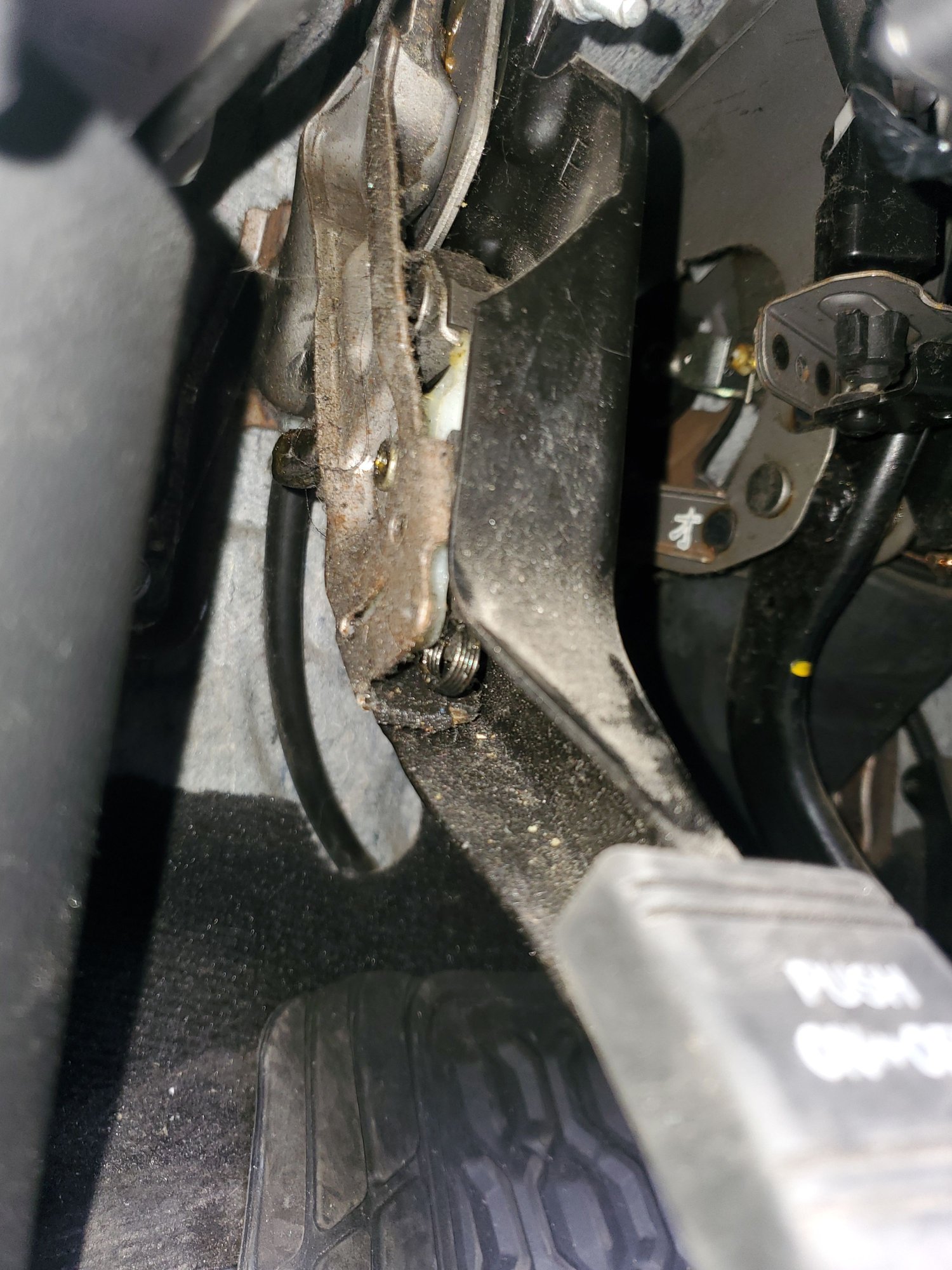

Old Nov 3, 2021 | 05:15 PM
909's Avatar
909
Joined: Dec 2018
Posts: 381
Likes: 48
Find a ground point. I used the E brake
