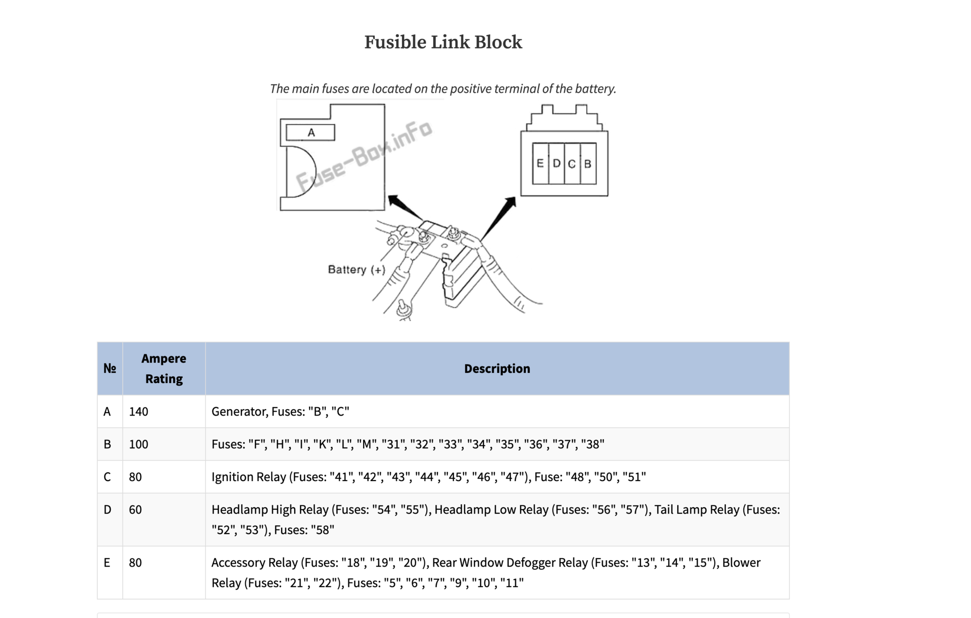

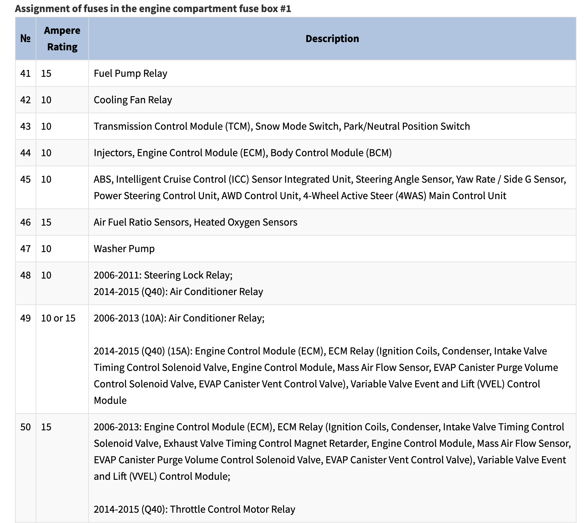

Looks like fuel pump relay is in this area at #41 in Box #1
I may just go with rag and eye protection.. doesn't look like much fuel came out in the Youtube video.
https://fuse-box.info/infiniti/infin...ses-and-relays
