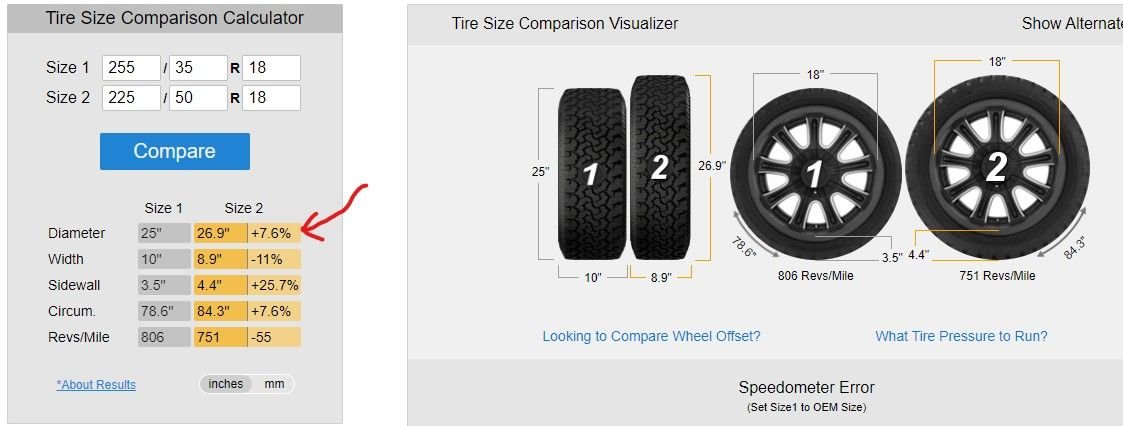

The 255s are 25" diameter.
The 225s are 26.9" diameter.
7.6% difference.
https://tiresize.com/calculator/

Ohh yeah that's definitely the issue, you're 7.6% different in size
