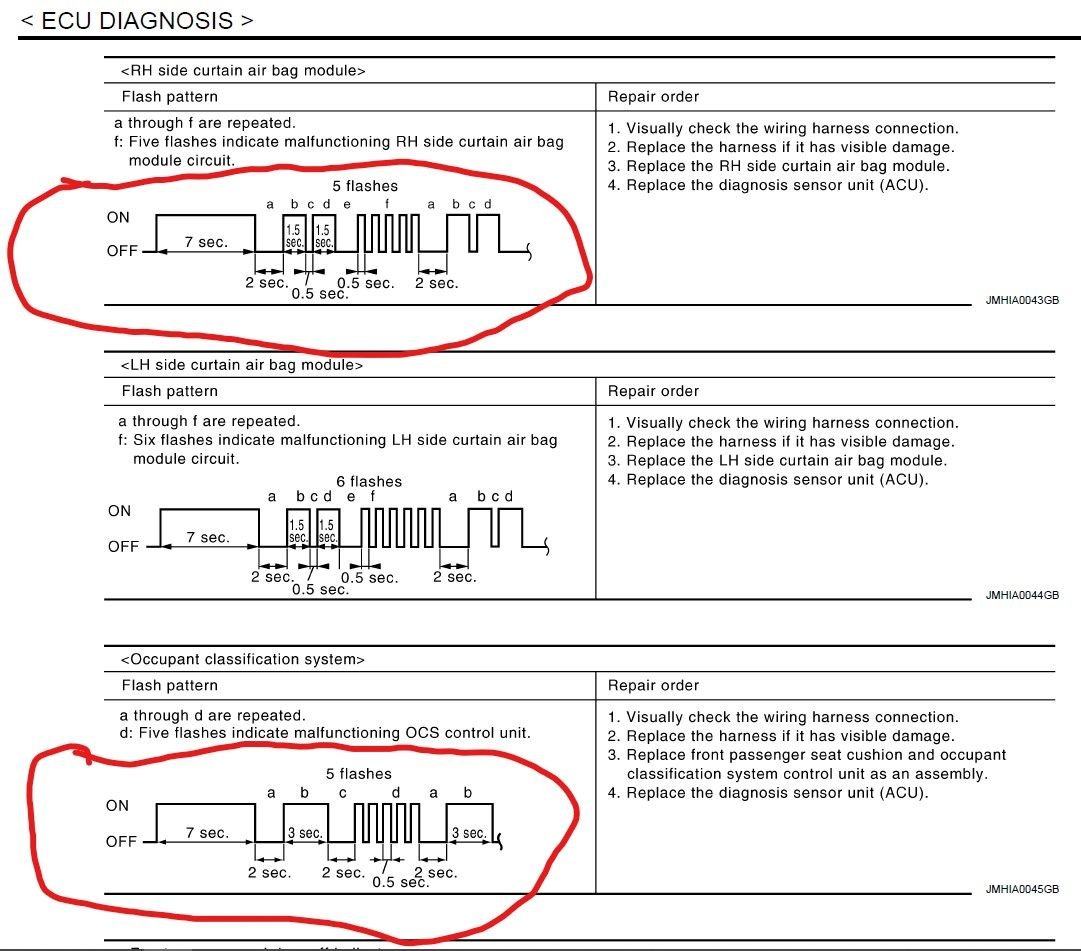

If you did get it into diagnostic mode in some point off those videos and it gave you 5 quick pulse flashes that's one of two things, do it again and compare to this picture.
The "code" is just the number of quick flashes the light makes during the 0.5off 0.5on sequence, you just count the number of flashes, it will be between 1 and 11 flashes. There is no code 15, it's NOT a 2-part flash sequence like OBD1 used to do where the long flashes was the first digit, short flashes was the second digit.
Unfortunately 5 flashes could be either that right curtain airbag or the diagnostic control module, look at the other flashes around it.

Thanks so much for the image, Cleric. Tremendous help. It is definitely the 7sec/3sec/5 flashes which indicates the occupant classification system. I now realize I didn’t give you a great video to diagnose it…, the site made me downsize so I had to cut out the 7sec part.
Assuming it’s a bad sensor in the seat cushion, would the easiest way to fix this issue be to replace the entire passenger seat with a used one? There are plenty of G35 part outs around me and I’m sure I could find one.
