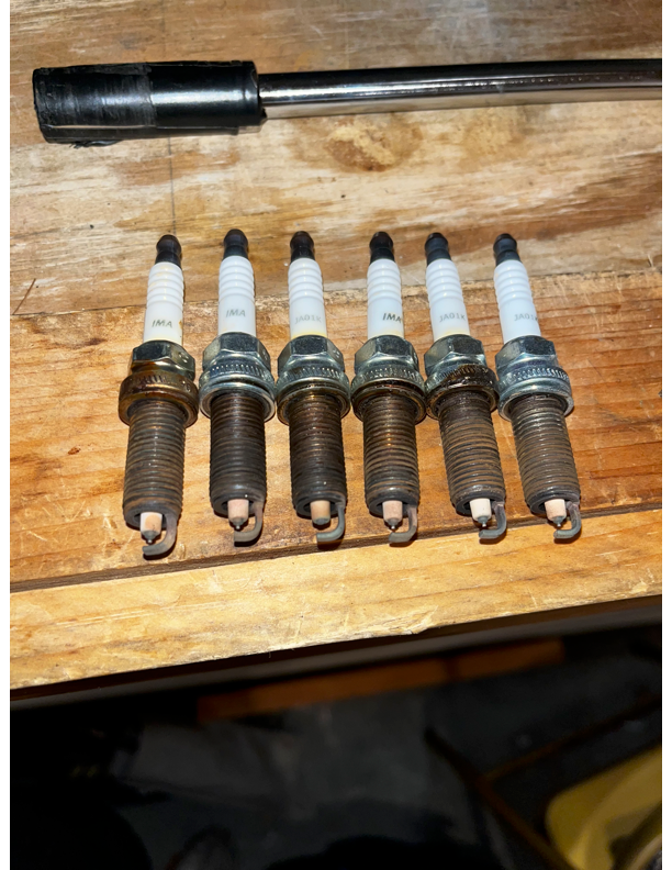

Hey, thanks so much for the response. This is my first time actually pulling the csv file from the data log, so for future reference ill try to play around with adding/removing some PIDS, and I also deleted a bunch of the useless columns and reuploaded the data log as an excel file, so hopefully its alittle easier to read now. I used torque pro to pull the data. I pulled all 6 plugs bout a week ago, im going to include a pic of what they looked like, and also a video inside each chamber. There was a little bit of oil on the plugs, but from what ive read thats relatively normal for a motor at 109k miles. I also noticed one of the plugs had a missing center electrode, so I replaced all 6 with brand new oem iridium plugs. The problem still persists. I cleaned TB's about 2 weeks ago without unplugging them, but still did the idle and air volume recalibrations. I saw someone post saying the 07-08 models had a bug with the idle recalibration, not allowing it to fully finish. Maybe this is the issue? but I don't know enough to look into that. I sat around my engine bay for a few hrs looking for leaks, and like I said I heard a bit of hissing from pcv line and valve, but that's also apparently normal as well. I sprayed all around the engine bay with TB cleaner, and no change in rpm, AFR, or fuel trims.

Air/fuel is calculated solely based on the data for the upstream. However because the upstream sensor is so close to the flange that mates to the cats/test pipe then yes you could be getting a false reading if that gasket is bad. You would see it on the plugs though, they would be pretty black, yours definitely look like it's running hot. Have you smoke tested the intake too?
