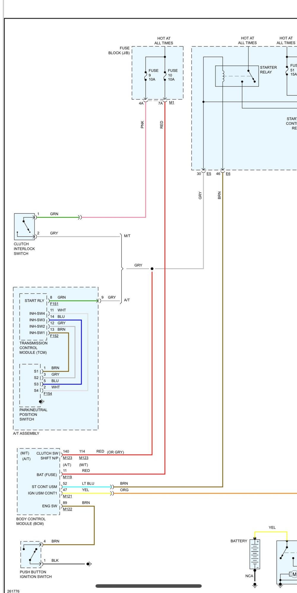

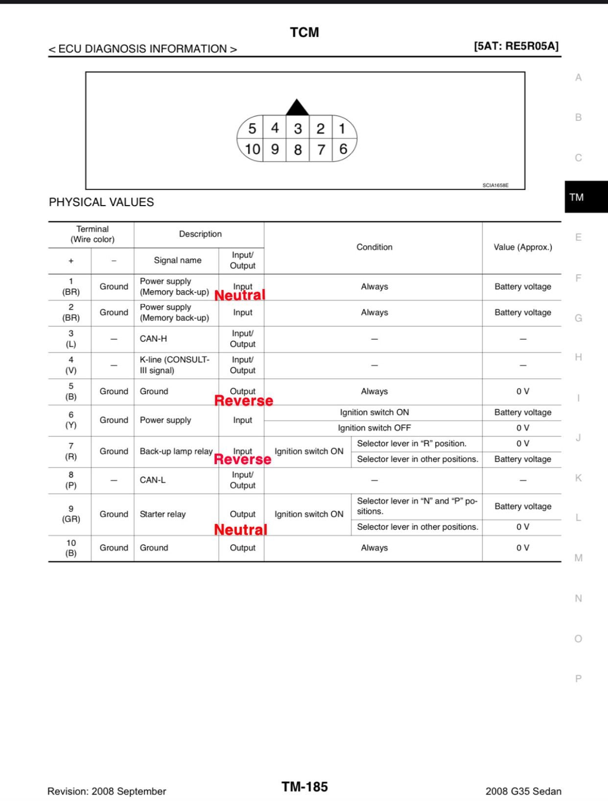

So I looked up the fsm for the 5at pigtail, does this look right? I believe someone else has done this same thing on a g37 splicing into the 7at harness. I just followed his connections and matched ‘‘em to my 5at harness. Once again I appreciate all the help. I’ve got all the parts laid out at my shop ready for the big install but wanna make sure I have the electrical side all good.

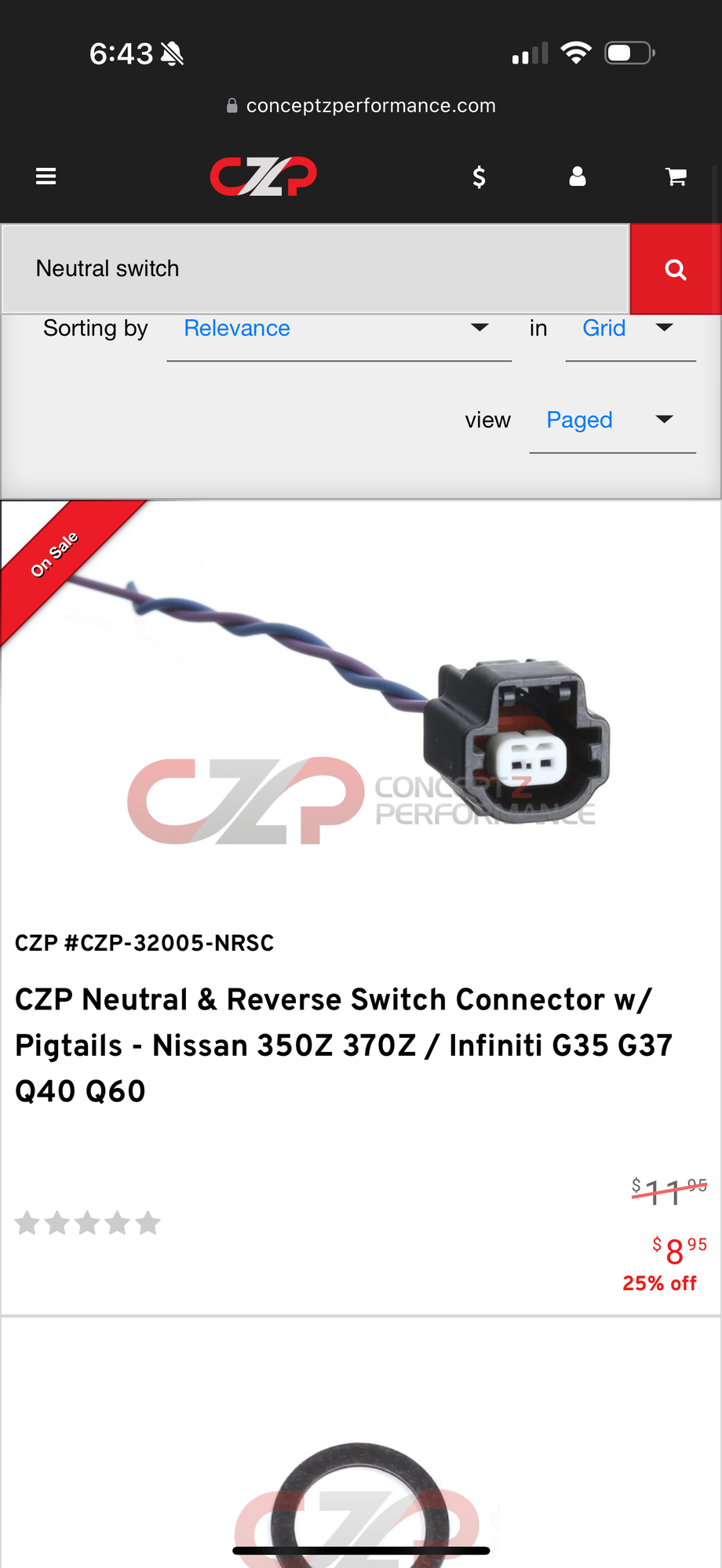

Old Nov 18, 2023 | 08:50 PM
  #24
Madchild's Avatar
Joined: Dec 2021
Posts: 35
08 G35 Sedan
Update!!!
Ok check out this thread, it's somewhere down in the middle where I went over all the wiring for that swap.
https://g35driver.com/forums/g35-cou...g-input-2.html
So first of all I wanted to thank u guys for the help. I ended up doing my manual swap in a day since I work at a shop with access to lifts. Everything bolted right up I used a 6pd from a 370z with the rev match feature and I left those unplugged I wired up the neutral switch and the reverse light pigtails on the trans to my AT trans harness. I’ll provide the diagram for anyone who wants to do this.
the way I have the car wired to existing AT trans harness allows me to start the car by only using the brake pedal when in neutral. If it’s in first even with the clutch depressed the car still won’t start unless it’s detecting it’s in neutral. Reverse lights works as well. So doing it this was allowed me to not have to go thru the ipdm for a switched power.
clutch pedal is strictly mechanical and neither of the two sensors are wired up.
im in the break in period for the actual clutch right now so I haven’t launched it. But it goes thru every gear like butter.
i do have a tune scheduled to flash my pcm from at to mt on the 20th so my pcm and stop trying to find my tcm lol and so my cel will turn off.
so yeah once again I appreciate you guys reaching out, there’s not much on my 2008 G35 sedan out there as far as 6mt swaps go so I had to dive into alldata and prodemand for schematics. But yeah any questions hit me up and thanks again.
I used this to wire the neutral switch and reverse light switch and works perfect to start the cat

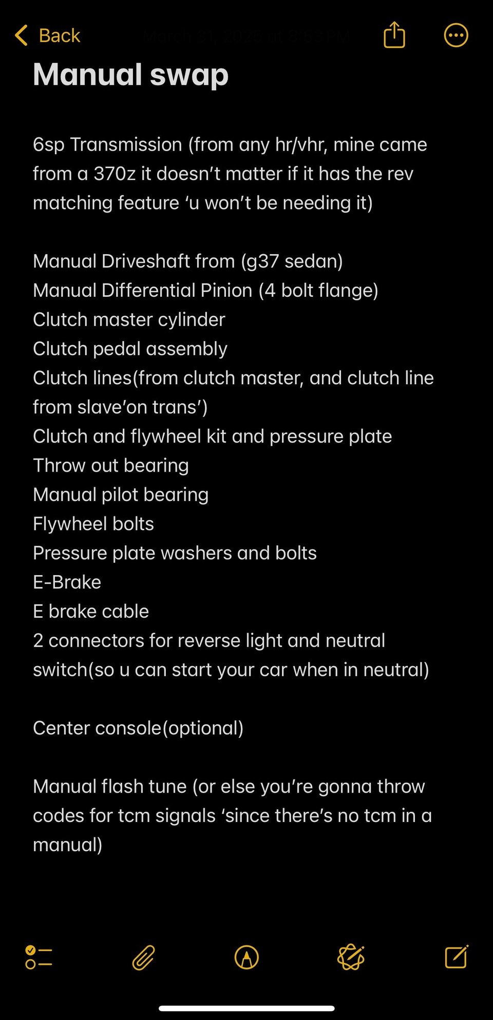

Parts list
Hey Madchild,
I am about to start this project. Could you share the parts list. No one else has publicly taken on this project and posted about it but you.
Also if I’m not wrong, you did not have to change the ECU right?
Thanks
Old Mar 31, 2025 | 08:30 PM
  #26
Madchild's Avatar
Joined: Dec 2021
Posts: 35
08 G35 Sedan
What year G do u have and is it rwd or awd ? The parts list is gonna vary depending on what year and trans u have.

Not a problem bro, I’m more then happy to provide some insight since I literally had barely any help regarding looking everything up myself. No mine was rwd as well there’s a lot of little stuff you’ll need I’m compiling a list for you right now so stay posted.

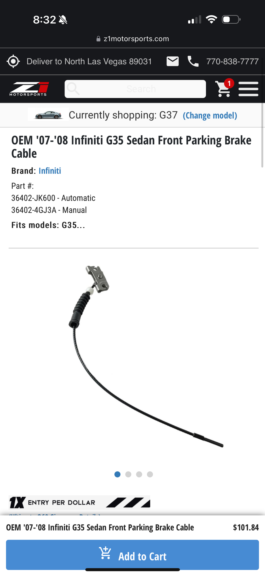

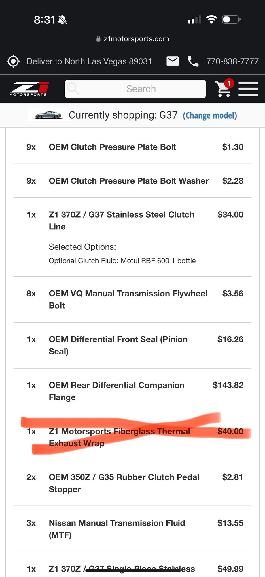

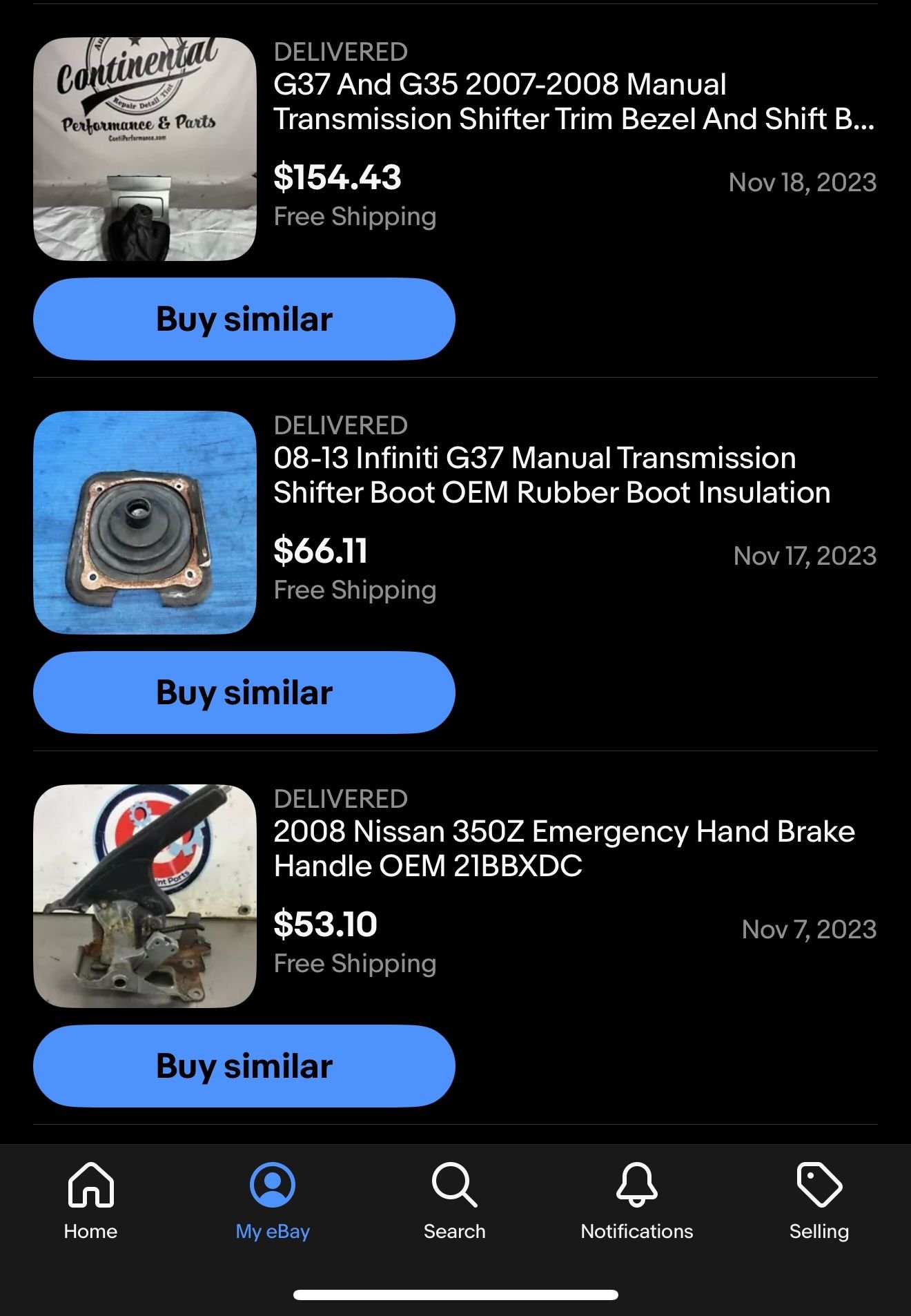

Old Apr 1, 2025 | 12:07 AM
  #29
Madchild's Avatar
Joined: Dec 2021
Posts: 35
08 G35 Sedan

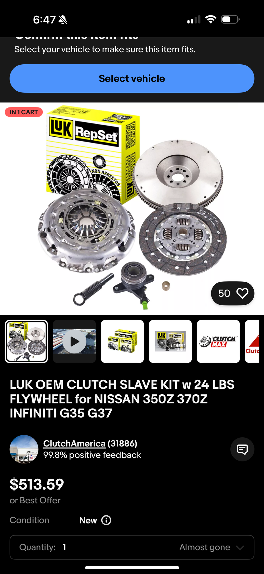

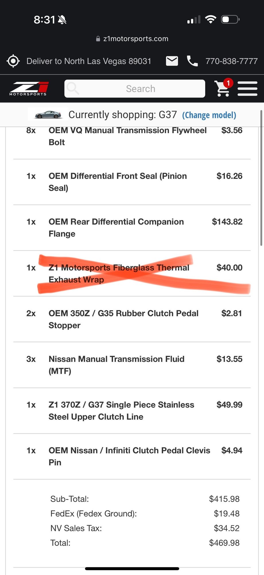

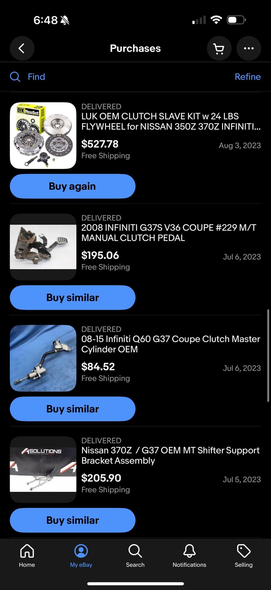

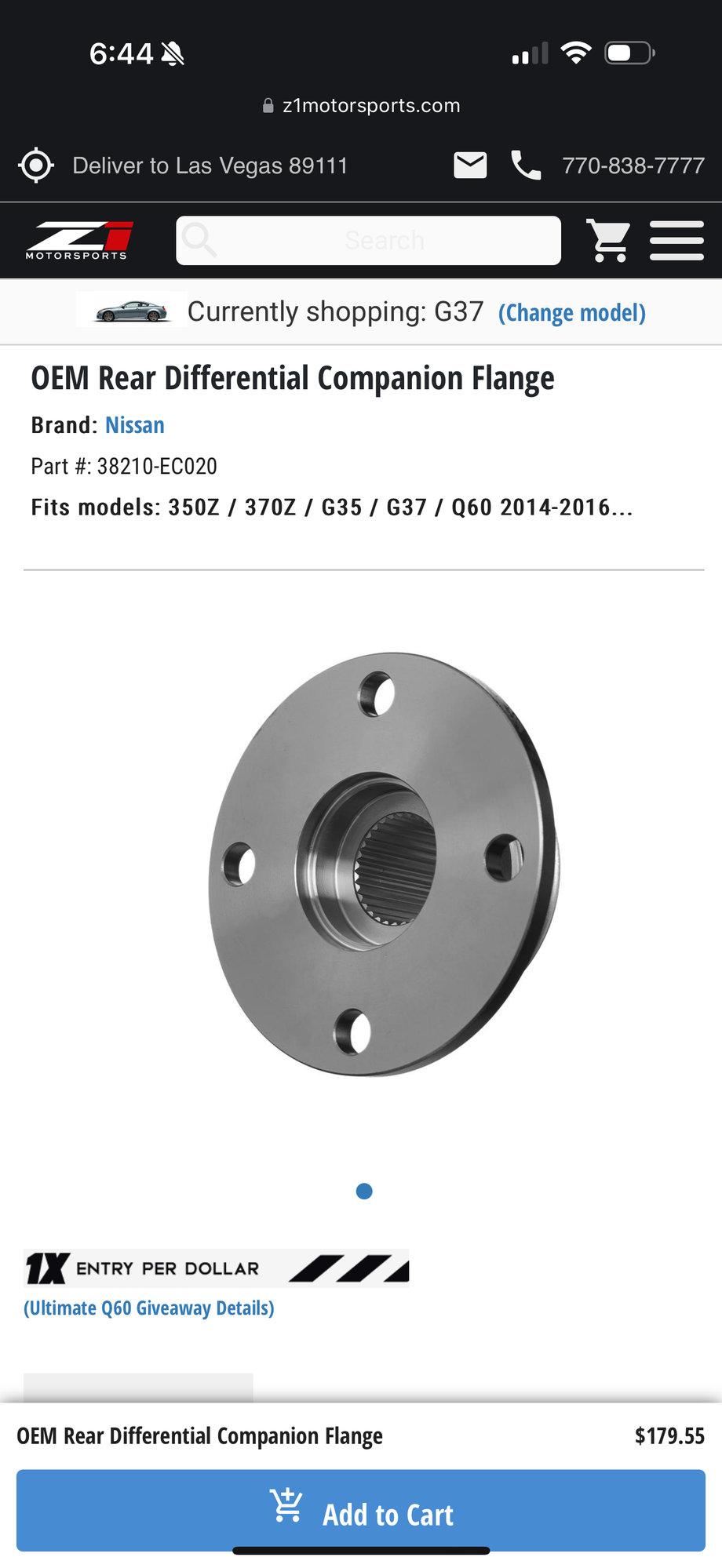

Old Apr 1, 2025 | 12:31 AM
  #30
Madchild's Avatar
Joined: Dec 2021
Posts: 35
08 G35 Sedan
You don’t need to go with the LUK clutch kit, I just went with it because it’s a known factory replacement and it came with flywheel, pressure plate, clutch, csc(concentric slave cylinder), and also the manual pilot bearing so it literally came with everything for inside on the trans
