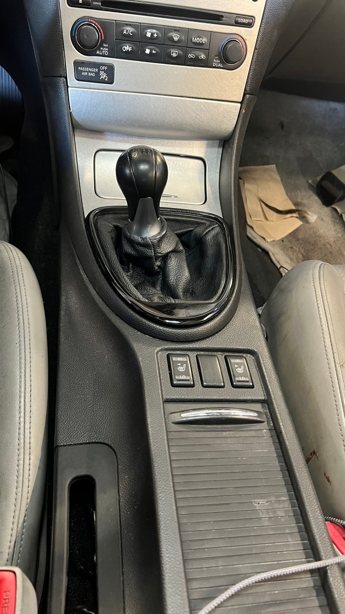

Did you change the center console? Or did you retain the old console.

I had to complete the inside lol I don’t do anything half a**** lol and yes the vr30 swap is a whole other mission, it’s tough because the vr30 is a 7speed and u usually swap the valve body from the stock g37 7speed over to the vr30 trans and I have no idea how that works with our car

Clean
That looks clean bro. Did you get the console from EBay? I have the part number for the shifter column. Can you share the one for the remaining assembly?

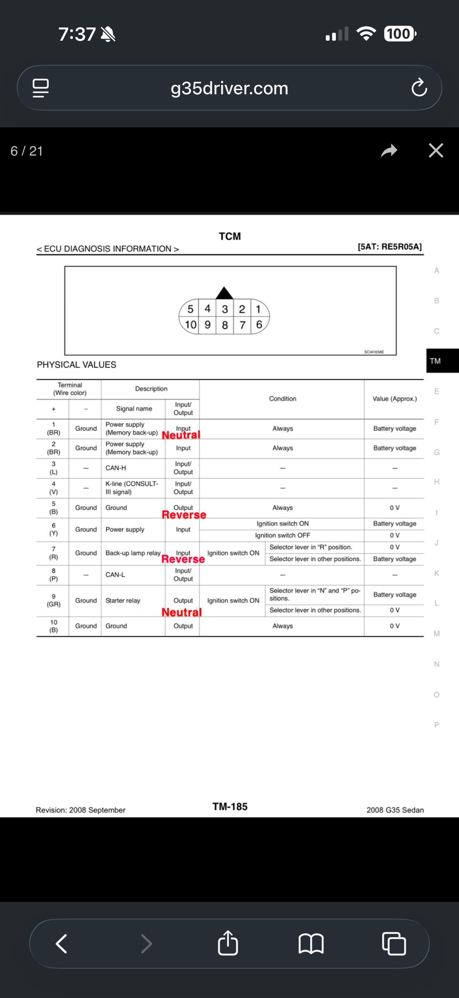

which color wires did you use for nuetral bypass bro im getting crank but no start i used grey and yellow for my 2011 g37 and i did samw for this 2008 g35 bypass nuetral but crank no start i dont know if wiring is different

yeah u got the colors correct, ur using the brake pedal to start the car right? But getting crank and no start?

Yeah im using break to start it and i tried starting it in first it wouldnt crank but later i did it on first gear wheels started spinning like the car wanted to start probably thinks first gear is a neutral or something i dont see any wiring wrong i dis since i followed samw ateps for my g37 and that one started right up, Tbh just really stressing out thinking of parting out the car.

ooooh the car ur working in rn is the g35 not g37?

colors r different for a 2008 g35

Wait so what colors do i use cus at this moment im using grey/yellow, So whoch ones do i use for the 2008 g35 i dont really get the diagram just let me know the colors please?
