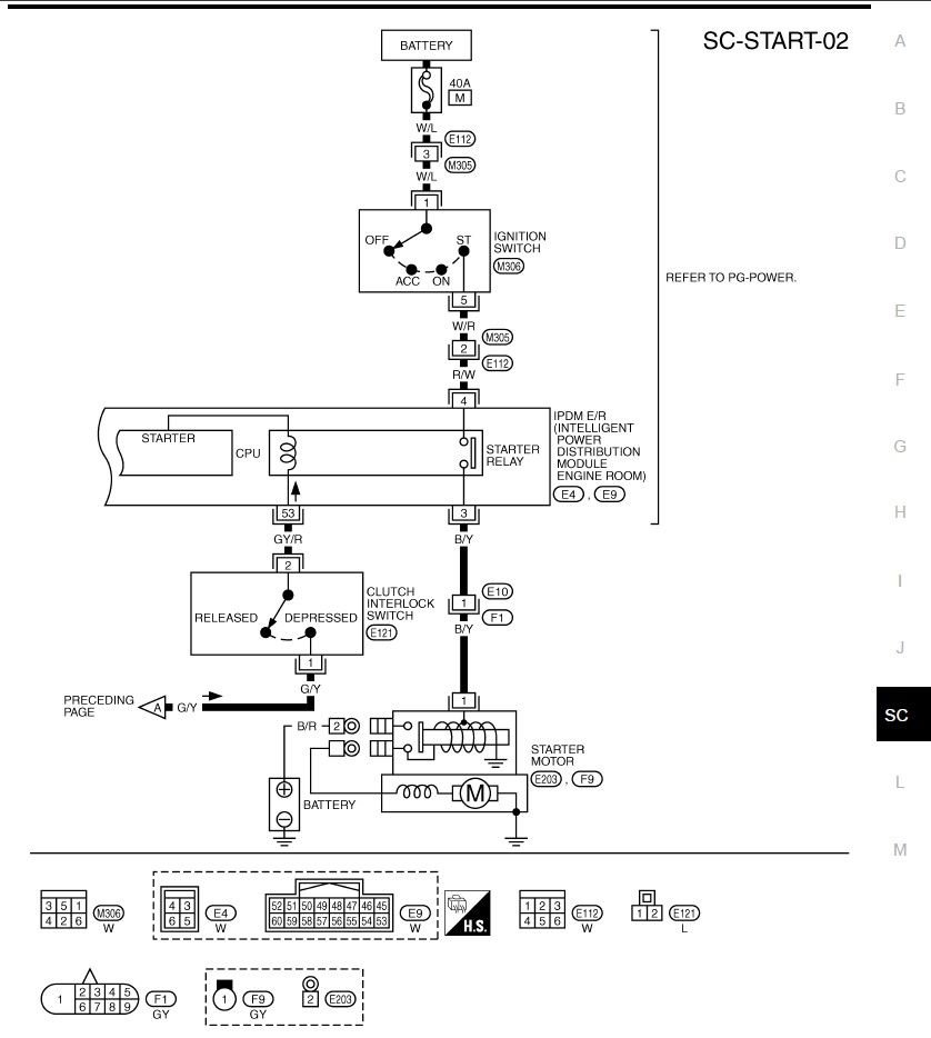

So how would I wire up the switches on the clutch pedal? Possible Diagram?

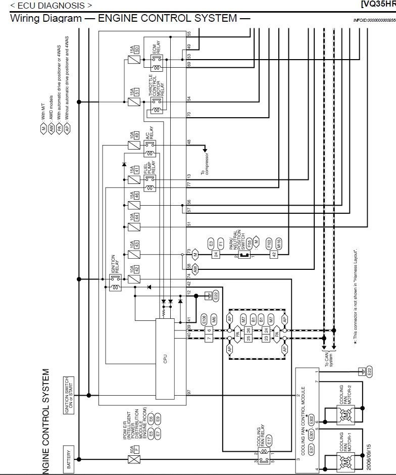

Start with the V35 schematic since they actually have one line diagrams. There isn't much difference in overall function between the V35 and V36 chassis. Then look up the V36 car for which wires actually do the thing.
For example, here's a V35 schematic 6MT one line from section SC - Starting/Charging. You can see the IPDM computer needs the PNP switch on pin 50 wire color B/R black/red stripe. Also IPDM start relay needs the clutch pedal switch on pin 53 GY/R grey/red stripe. The clutch pedal gets it's power from the ignition relay in the IPDM pin 25 G/Y green/yellow stripe.
Compared to the V35 5AT wiring schematic where the TCM sends the PNP signal to IPDM pin 50 and the start relay command is also controlled by the TCM start relay.
So using those V35 one line diagrams as reference we compare to the V36 chassis it's very similar the 6MT clutch switch goes to IPDM pin 30 GR grey wire, or the 5AT TCM controls the same wire. 5AT and 6MT PNP power comes from the IPDM pin 109 (G green wire for 5AT or BR brown wire for 6MT) the 5AT would then send PNP info via CANBUS to the IPDM whereas the 6MT switch needs to go to IPDM pin 73 P pink wire.

One big difference is the V35 the PNP switch is just a ground source reference monitored by the computer in the IPDM, on the V36 it's actually an energized source. Both use the clutch switch as an energized source to power their respective relay.
