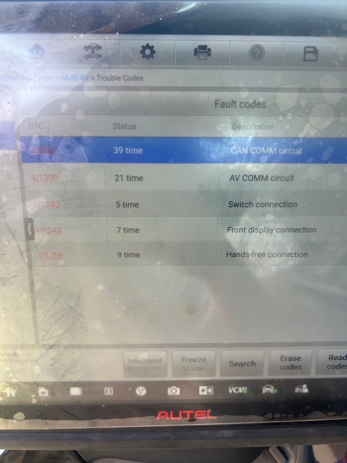

I have a 2007 Infiniti G 35X sedan,
I tried to start the car, but the car doesn’t start the park and reverse signs on the dash are blank but when I try to manually shift it to neutral and drive the lights on the dash show up, but if I try to do it with them shifter and pull it back. Those letters would not show up on the dash and when I try to do a scan I attach the photo of what the codes are showing so I am not sure how to fix this if anyone has an idea.

Firstly, did all this happen at once or has the car been misbehaving for a while? Was the car 100% working fine then suddenly not? Did you just go through a car wash or have a big rain storm? Did you run over anything on the car lately? Do you see any visible damage to the transmission wiring harness under the vehicle?
U1000 means one of the computers isn't communicating. This is typically where I would start, all those other codes are stuff that SHOULD be sent from the TCM but it appears that it's probably not communicating. Start by looking for obvious damage, then start checking fuses in the fusible link and IPDM.

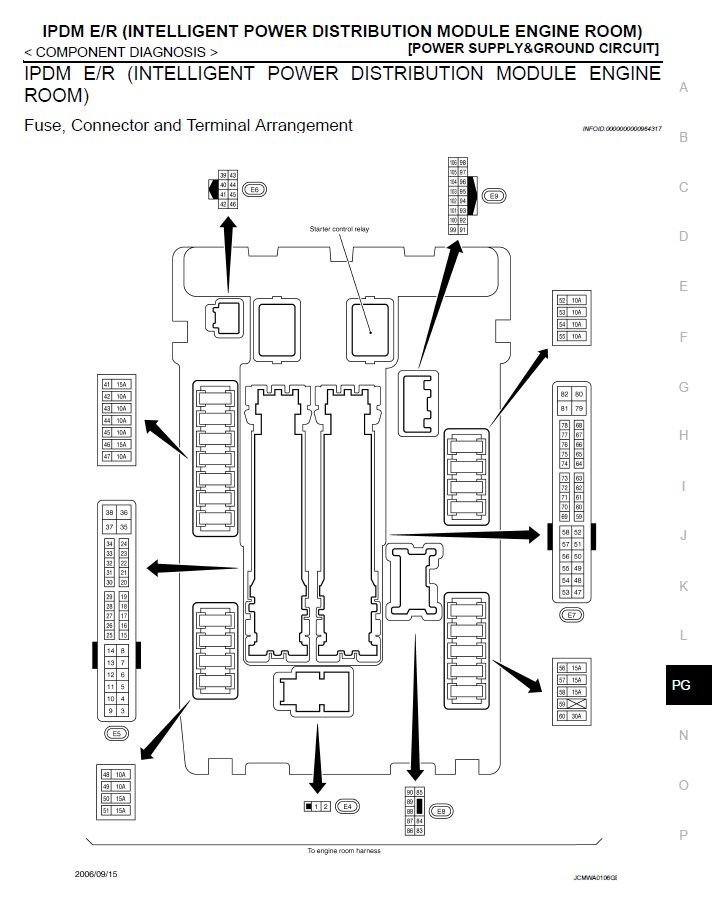

Next remove the IPDM cover, that's the engine bay fuse box behind the battery. Check EVERY one of it's fuses. There's 40 or so, pull each one and visually verify they're all good.

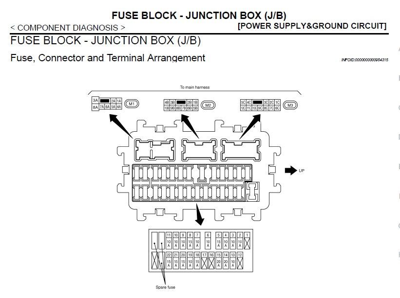

Finally remove the access cover to the cabin Fuse Block - J/B located in the left/driver side footwell. Check EVERY one of it's fuses as well, there's 50 or so in that one.

I was just pulling numbers out of my ***, looks like each one has about 20. Here's the layout for your vehicle.

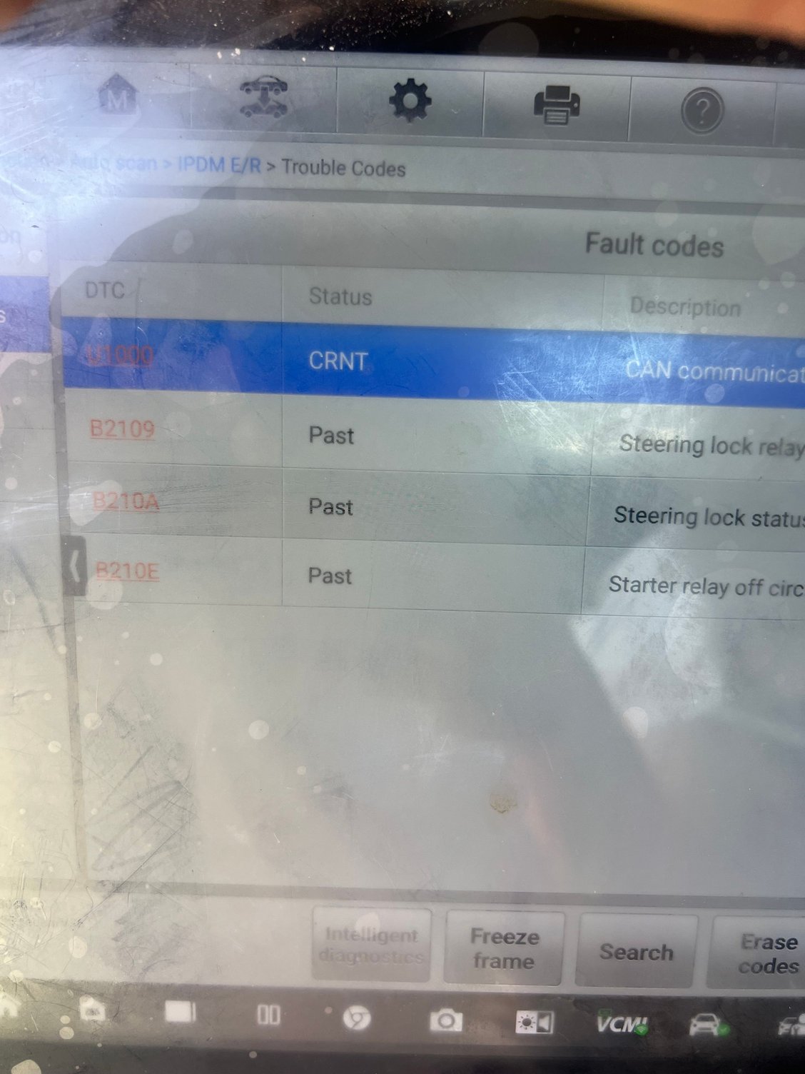

At this point your best bet is going to be taking it in for a diagnostic at Nissan or Infiniti to find out what computer stopped working. Troubleshooting the U1000 is the next step.
