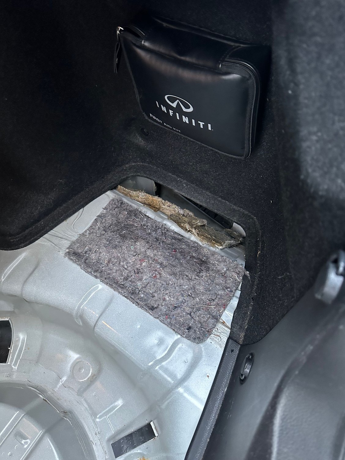

It's been a long time since I've been on here; I still have my '08 S after 15.5 years and 132k miles later. It's been the fourth car in the stable for quite some time now, so it's been relegated to sitting outside.

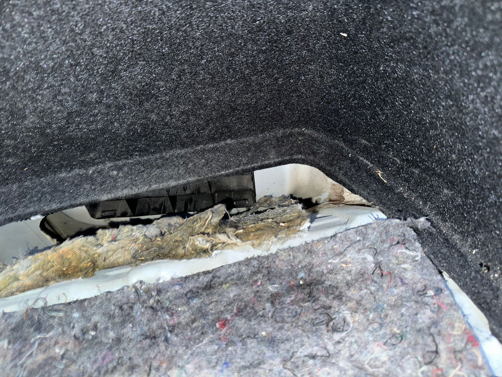

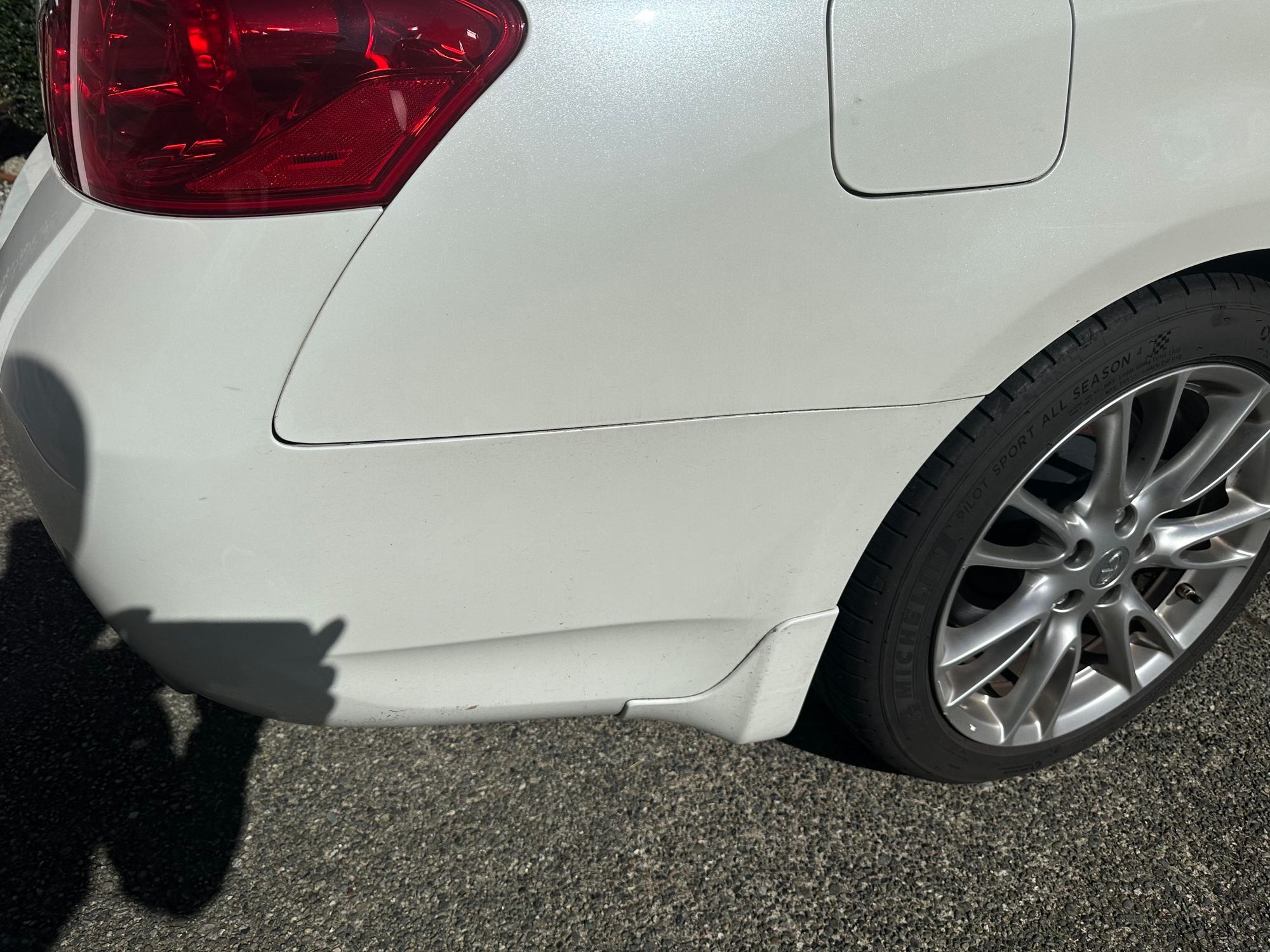

Long story short, I recently discovered a lot of water in the trunk but have no idea how long it's been there. First, there was water in the spare tire well area, which has since been drained and I'm currently not finding any more water there again. However, I'm seeing water consistently in the passenger side cavity where the air flow/pressure vent is. I've extracted the water out several times now, but keep finding water there. During a quick troubleshooting session, I had my daughter take a hose and spray water directly into the "gap" where the rear bumper cover meets the rear quarter panel and do see water coming through the aforementioned air flow/pressure vent. However, that doesn't seem like a natural way for rain/water to enter? With that said, we could not get or see any water make its way to that cavity by any other area or means during our limited testing.
Does that cavity area have some sort of drain that is clogged, and it's not allowing it to drain? Or is there another drain for some other area (e.g, rear sunroof?) that is missing or clogged and diverting water here as a result? Or perhaps I have a leak somewhere? Any thoughts or insight would be greatly appreciated. I don't have much time nowadays so I'd like to have a plan of attack before tearing the car part.
I was thinking of removing the rear bumper cover and potentially replacing the air flow/pressure vent (I assume it's replaceable and relatively cheap?), even though it doesn't make too much sense to me for water to enter that way naturally.
In the meantime, my driveway has a very slight slope or grade so I started backing into the driveway so water can try and flow away from the trunk area instead of towards it.

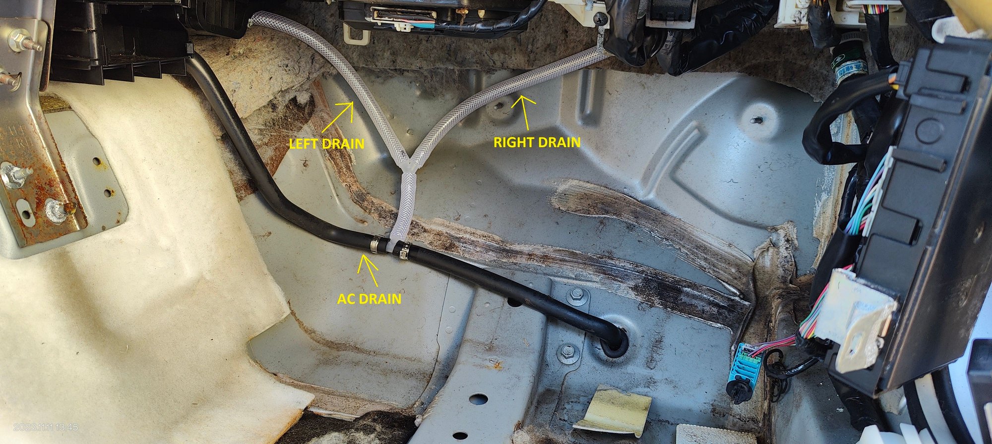

Sunroof drains, IF you have one. I bought a 2007 Sedan V36 and it had water under front seats and in the trunk from the plugged up 1mm hole sized drains. Did a tube bypass into AC drain and no more water. But then again, I keep my car inside the garage. But, after a decade, it's normal for sunroofs to leak; Seals crack, moldings get brittle, it's sagging, drains get plugged up (yes folks, sunroofs require maintenance!).
This is what i've used:
Tubing Tubing
Fittings Fittings
. Remove both front side upper pillar covers by pulled them off from their clips and there you will have black drain tubes. Cut them 8-10" away from the dashboard and route the 3/8 tubing to the AC drain using the photo for reference. ALSO, before you do that, confirm the black OEM drains are attached to the sunroof drain pan, mine came off on driver side completely.

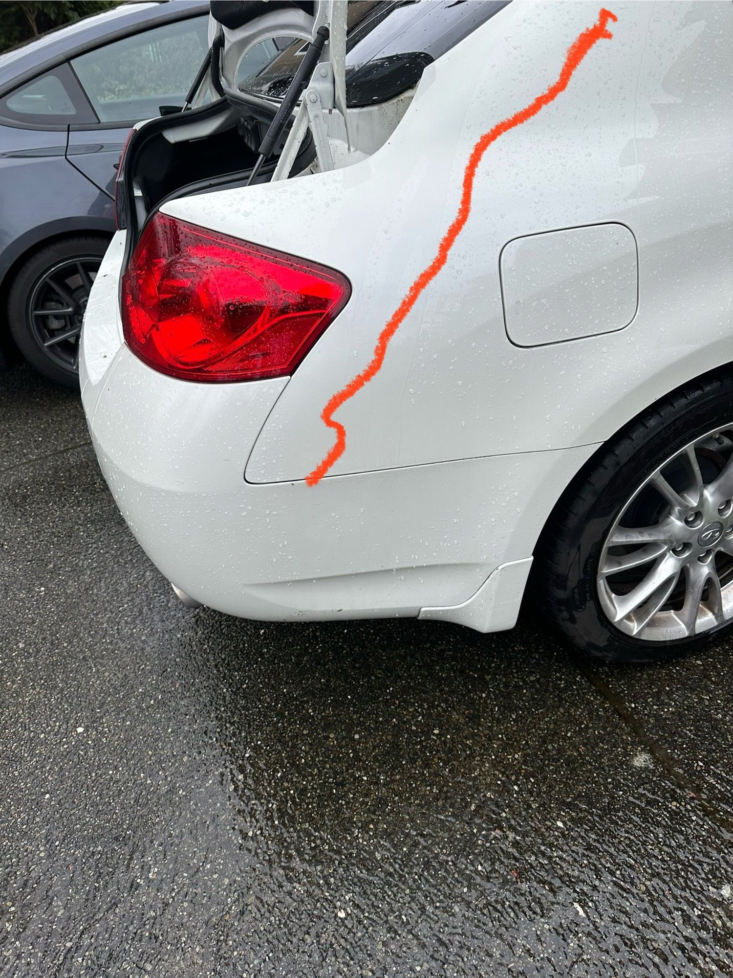

I thought I would provide a quick update. In short, the air flow/pressure vent was indeed the source of the water leak. I incorrectly assumed, but with the car at an incline, water does naturally flow to this area as pictured below.
After realizing I had ordered the wrong part number when removing the rear bumper cover, I uninstalled and reinstalled the original part and did my best to ensure it was fully seated. I then used some molding tape I had laying around to provide a “awning” of sort to divert the water away from entering.
All is well, at least for now.
