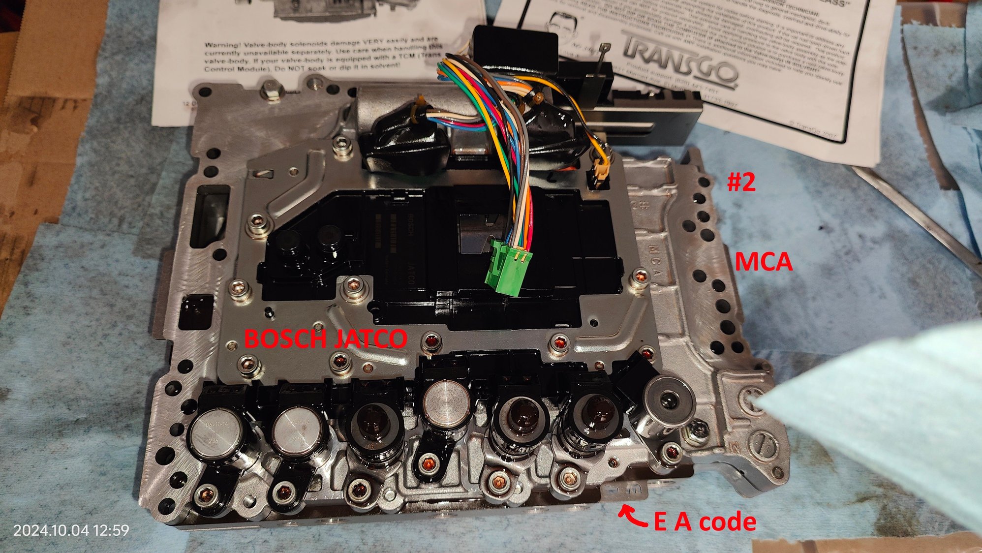

I did the TransGo kit few weeks ago and now i regret it. Today i was doing 80 in 5th on the highway and floored it and this is what happened; The transmission went into Neutral and engine revved up to the maxxx. I had to put it in N to D and N to D few times to get it back into gear. I thought my trans is done at only 130k of non abusive driving.
I did clear all driveability settings in ECM and TCM so the trans can relearn itself. It shifts normal below 3-4k but it kicks so damn hard at wide open that it literally moves the rear end of my G to the side. Chirps the tires and if i'm upshifting on a slight turn, the back slips left or right depending on the curve. But the worst part of this mod is when doing 65-75 in 5th on the highway and suddenly flooring it.. First BANG, then second BANG and finally the right gear in and it goes (2-3 sec lag). It's so rough that my intake pipe holding brackets broke off and my filters now flap around.
I followed all the steps and drilled the right holes with the right bits (measured with digital caliper) so i don't know what the hell is wrong with it (besides the mod) but it really sucks..
The manual shifter is no better either, it works the same sluggish way as it did before this mod but that THUMPING and BANGING inside the trans when downshifting under full throttle is just horrible.. I've looked at few valve bodies with the same BOSCH unit but can't find the same E A plate stamp, not sure if it matters and no idea if all 2nd gen RE5R05A valve body separator plates are the same. So, if anyone knows FOR SURE and has a UNDRILLED valve body separator plate, let me know. It's stamped E A 2007 G35 5AT.
I couldn't find any info about the RE5R05A 2nd version valve bodies weather they're all the same or not (separator plate, not TCM) and i'm not sure if one from a 350Z is the same.
Also, if anyone has ever reversed the TransGo kit installation, did the drilled out separator plate work normal with the stock springs and pistons?

I've contacted TransGo 2 days ago and e-maild with Robert, and he confirmed that this mod is STRICTLY best suited for drag Boosted/Nitrous applications. So, i've asked him what can i do to reverse this operation and this is what he said; Assuming that you have kept your OEM pistons and springs during the mod install, all you have to do is remove the mod pistons and springs and reinstall the OEM pistons and springs. The drilled separator plate can stay as is and the orifice plug in the 4th hole can also remain.
So, today i got to work, took out the VB and reversed the mod. Yes, i did keep the OEM pistons and springs along with the instructions. After few hours, i got it back together and all i have to say is that this is the proper way this trans should run! The shifts are cut about 60-70% from the neck breaking THUMP to a good fast and firm shift! No grandpa slow/smooth upshift but a quick, non-neck breaking or tire chirping or *** moving shift. It's hard to describe but the best way to describe it would be between TransGo mod and stock; In my words, it's perfect for the NA platform.
So there you go, you can drive with this annoying mod or you can fix it. For those that threw away their OEM parts, you'll need a stock VB, i saw plenty on eBay as i don't think you can source the 3 pistons and 1 spring from anywhere or maybe you can. If you can, the fix is easy and before you do it, get yourself 7 quarts of Idemitsu Type S from RockAuto, they have the cheapest price on that oil.

The mod was done per page and checked 5 times before going back into the trans. I even watched youtube videos about this trans being rebuild, taken apart, the VB taken apart and put back together to get better idea what was ahead of me. I measured the drill bits with a digital caliper and precisely located the separator plate holes that need to be drilled, eventho the separator plate in the instruction manual is from 1st version and mine is 2nd version but the holes located matched. As for the downshifts, the only assumption i have is that the TCM registered an overpressure during downshift and dumped the solenoids to neutral for safety. I didn't go into limp mode but i'm sure it was on it's way if i didn't cycle the gears and go off the road. Either way, it's fixed now and in my opinion as a mechanic for almost 30 years, this is the way it should of been from the factory when installed in the G or Z cars.
