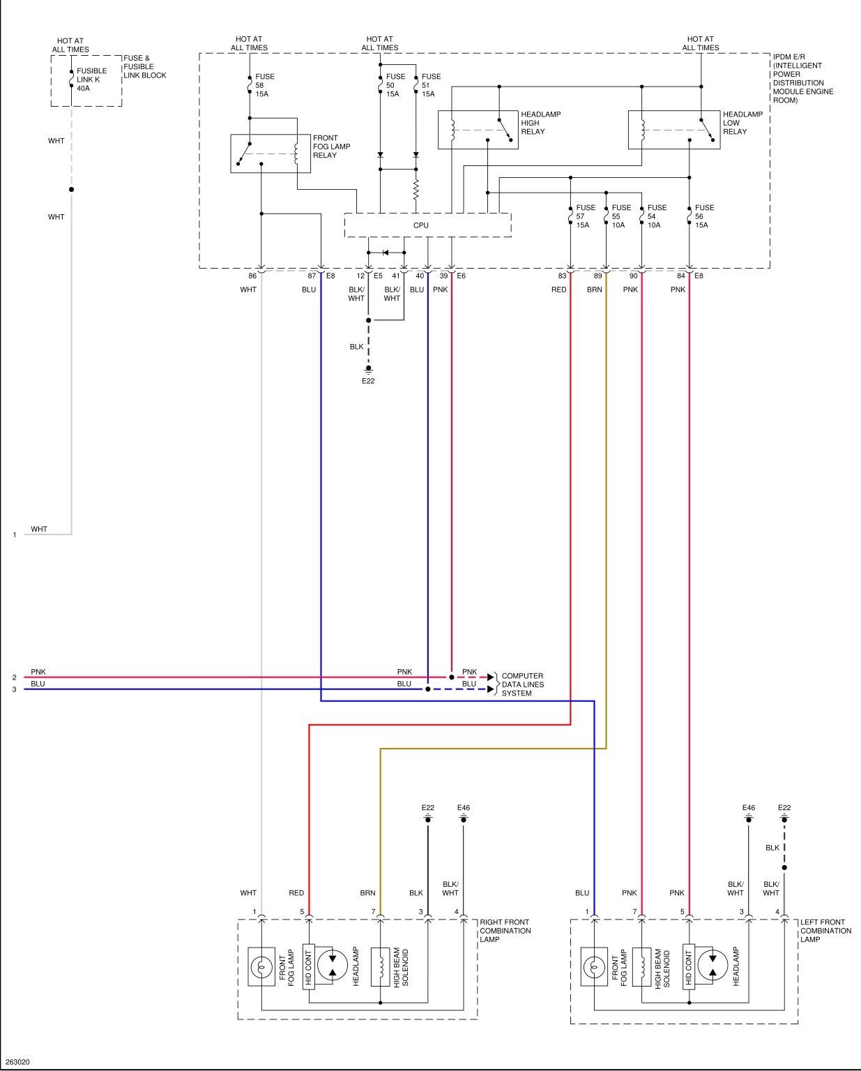

Get either a LED conversion from ebay or amazon that utilizes your OEM ballast or get new ballast with a new bulb. LED is 3x brighter than those 1990s Xenarc bulbs. I was able to ****** 2 used ballasts from amazon for $5.98 each because i thought one of mine burned out which turned out to be the ballast plug that connects to the bulb.
You need to raise the front, dump the front inner fender splash shields and then inspect the ballast plugs. MAKE SURE TO HAVE LIGHT SWITCH OFF OR YOU WILL BE HURTING BAD!
You could have the magic effect called 'Left ballast, Right bulb' out.. OR, it could be the case of wiring to the headlight assemblies or even a bad IPDM. Just because it clicks, it doesn't mean it makes contact.
Here, headlamp circuit from a 2008 G35X with HID.
2008 G35X Headlamp Circuit01
2008 G35X Headlamp Circuit02

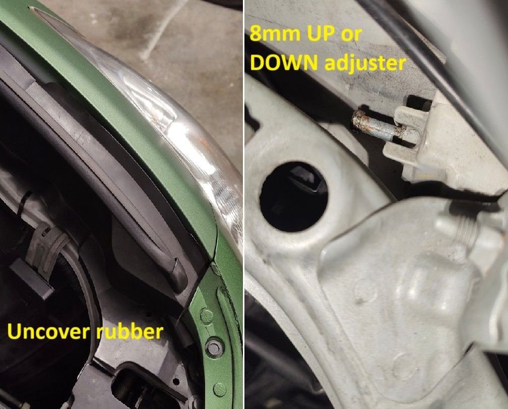

Those LED bulbs are just like your OEM bulbs, you reuse the clips to keep them inside the housing and attach the plug. You might have to bend the grounding tab on the plug to make it fit.
Then wait till gets dark, (assuming your headlamp lenses are clear enough not yellow or tinted) then adjust them using a 8mm 1/4 socket for up and down.
Headlight adjusting 8mm bolt under rubber cover.
