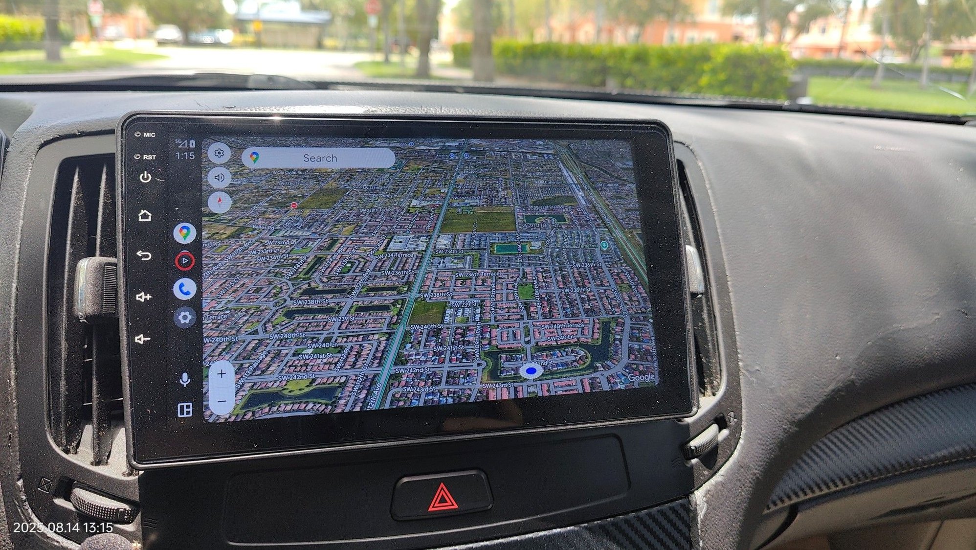

I just threw out all those stock navigation crap from my 07. I've replaced it with a aliexpress 10" android auto screen and trust me, you'll want to do the same.
