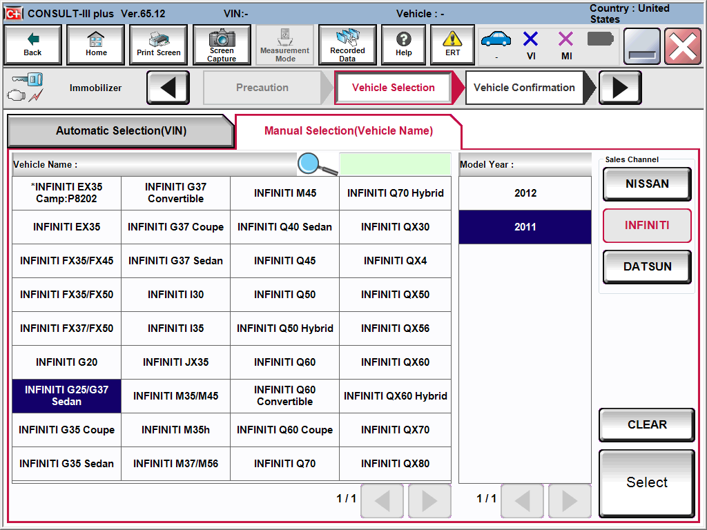

Sequence of events
I have not replaced any modules, physically in the car.
I followed your sequence of events and here are the screenshots in order of events:
I get 4A if I select Replace ECM or Register Key
I get 4B if I select Replace BCM
For either option, I enter the Pin code and then get stuck at Screenshot 5. I put the FOB in and turn On the ignition and the car does not program it. I just get stuck regardless.
