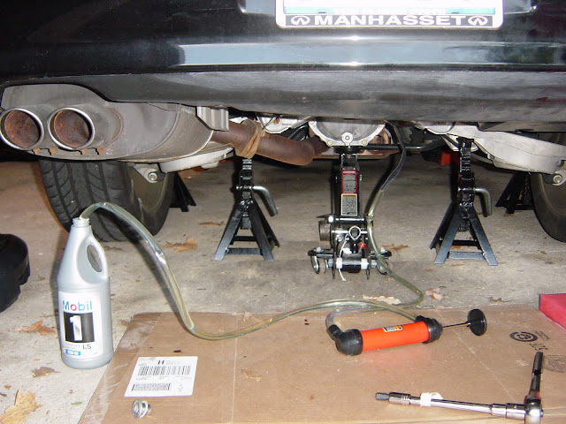

i have 2 funnels, a long skinny tip and short and wide one. everything goes into them...
those hand pumps are like $5 so i guess you can buy as many as your want. normally on SUV you dont need pumps but on our cars you somewhat have to. I think the rear diff wouldn't need a pump but i haven't done it.
i'm still looking for redline fluids...
You can use either the one that is posted above or the one that goes straight into the bottle
I prefer this one cuz it also acts as a cap for a bottle and that way you have a less chance of spilling your oil.
