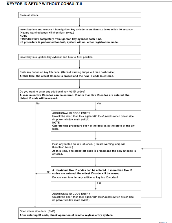

Well looks like you have this sorted out....
I did buy a 24 buck E bay key fob... easy to program.
Do you have a shop manual?
Mike
Attached Thumbnails Help! Lost Key, Now have no keys. Help!-key-fob-programming.jpg
