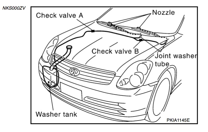

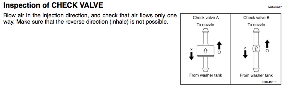

There are two in-line check valves in the washer system, the one marked "B" might be stuck closed...? Hard to see the exact location from the picture but you should be able to find it if you trace the hose.
Attached Thumbnails Two weird problems with the car... HELP!-washer1.jpg   Two weird problems with the car... HELP!-washer2.jpg
Old Dec 19, 2010 | 11:06 PM
simpson's Avatar
Joined: Mar 2008
Posts: 2,213
From: maryland
That check valve is under the cowel screen. Check valve a is right near the hood hinge.
