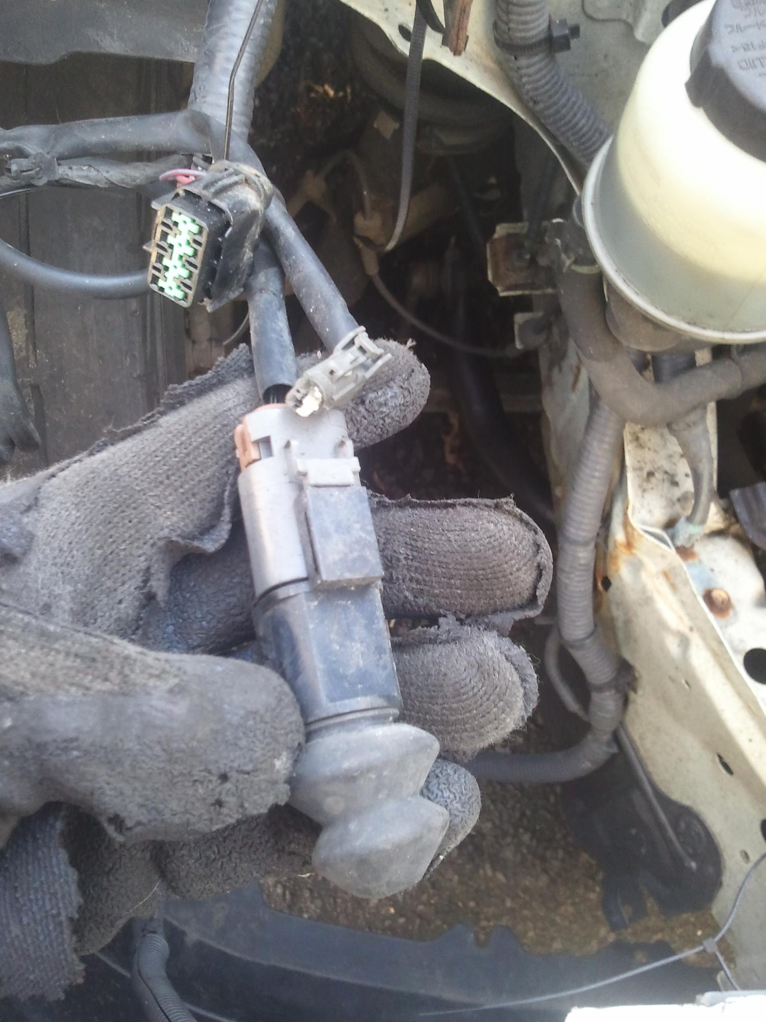

Rebuilding my front end after a nasty accident. I've tried to keep track of where things went, but it's been a year, and on these 2 items I'm confused. First - I assume is a Hood/closed sensor, and the next I have no idea. My rad support was the main component broken so I'm sure both bolt on there. Just need to know where and in the case of the aluminum piece, what it is would be good info.

that's your hood open switch it goes on the passenger side by the power steering fluid bottle
Lower left you can see it

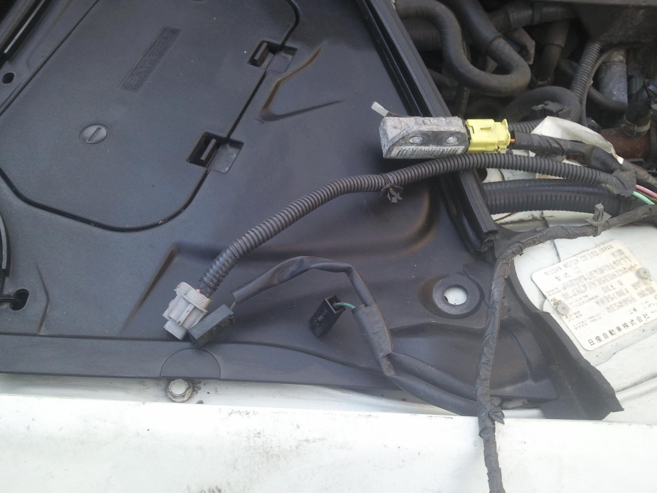

Damn. Means I'm missing the bracket. No chance of finding one? Will my G work properly without it? BTW, Thank you. The other part I couldn't post even tho I have a pic. It's metal and seems to be the end of a wire line. 2 bolt holes and L shaped in cross-section.

Sorry to hear about your wreck. That switch is part of the vehicle theft alarm and as far as I can tell only completes the circuit when the hood is open. Meaning, you should be able to unplug it and operate the car normally - just the hood wouldn't set of the alarm...

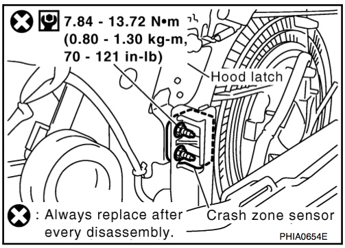

trying. ok, hopefully now. The piece with the yellow clip.

That is an ABS crash sensor and it goes in the front by the hood latch and those other plugs are for your horn

Here's the somewhat cryptic illustration from an '05/'06 service manual. You may actually need a new sensor if you had a front-ender. Manual says if you drop it you can''t use it...
Good luck with the rebuild.

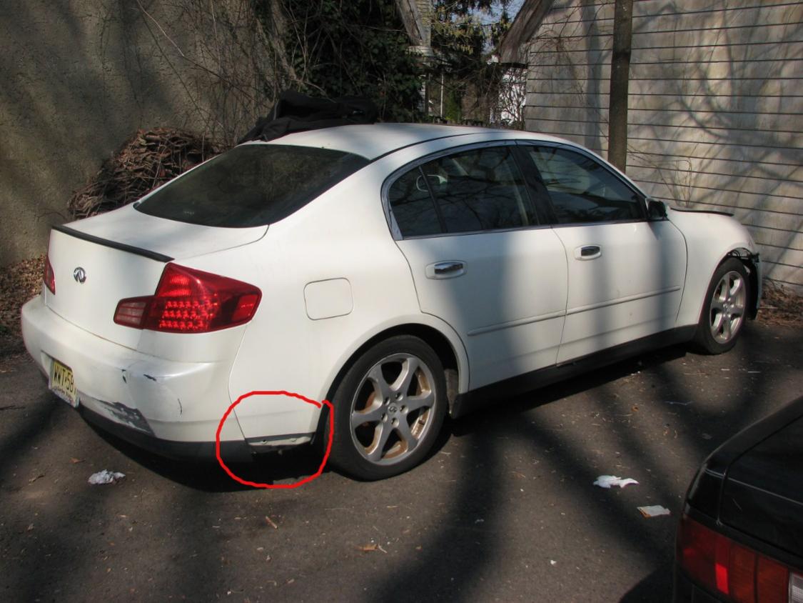

Just a shot in the air but thought I'd ask if anyone knows the name of this body panel. Not life or death. but it needs to be replaced. Thanks again.

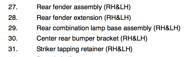

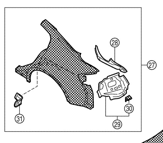

I think thats just considered the bottom of the "rear fender assembly" which is made of a few parts. Here's the pic and the parts (for '05/'06).
Attached Thumbnails where does this go???????-fender.jpg   where does this go???????-key.jpg

BTW. Update, Just got off the phone with my local dealership. No idea what a rear fender extension was but I described it to him. No luck. He told me they don't carry parts like that so guess I'm SOL for now.

I recommend finding a good body shop for those bits you can't do yourself. The pros can do amazing things with whatever you throw at them, including, most likely, repairing that body panel. Funny, the shadows in that photo make it look like the rear fender is whiter than the doors or the bumper!
