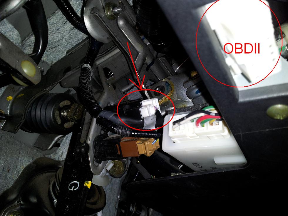

I was trying to do the TPMS relearn procedure on my 2007 G35 Coupe, but I believe I pulled the incorrect plug. I stuck a paperclip in here to "ground" it but when I touched metal, the paperclip sparked. Consequently, when I'm driving, the VDC/SLIP/ABS lights come on after pressing the brakes and stay on. The lights are not on when the car is turned on. I'm guessing a fuse may have blown, but I'm not sure which fuse this may be. Does anyone know what plug the below is? The plug that i pulled is pointed to below.

Nevermind. Stupid question. It's related to the brake lamp... Found the blown fuse in the kick panel.
