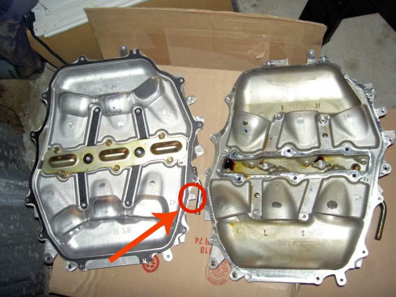

I was messing around in my box of spare parts looking for something, and ended up finding installation instructions for a MD plenum spacer. I went and checked and my car, and BAM, somewhere along the line of the PO's, one of them installed a spacer. However, I was curious if the MREV2 mani had been installed as well. I am not looking to take off the upper plenum, but I did notice something after googling. My lower intake has a "casting tab" with a 5 stamped on it. I am fairly positive that it's only on the MREV2 mani's, but I could be wrong. Is this a legitimate way of knowing its an MD product, and is there any way to be 100% sure without removing the upper plenum?
Picture for Reference

No, the MREV2 is just a modified OEM non-Rev lower plenum so both will have that tab. In this photo, you have an MREV2 on the left and a Rev-Up OEM plenum on the right.

But, if you have that tab it means its either an mrev OR a non rev-up lower plenum. The non rev-up plenum works almost as well as the mrev, so if you've got that tab you are good to go whether its mrev or otherwise. Really you just don't want the one on the right.

Yeah, yours is a non rev. You don't have to worry about a lower plenum.
The only one you DONT want is the rev-up plenum. The Mrev is an 03/4 lower plenum that has been modified for any car that came with a rev-up motor.
Basically, anything other than the rev-up lower plenum is good. The rev-up is flawed in design.

The mrev does flow slightly better than an unmodified nonrev plenum, but not enough to spend $500 on. The mrev is basically a ported and polished nonrev plenum. I saw a thread on my350z where a guy opened the runners a bit and ported and polished it and Tony from MD commented on the thread saying the other guy was very close in terms of how an mrev2 is modified. So, yes, if you're turboed and need MAXIMUM flow I would go with an mrev (or port/polish my own), but for NA, any gains would be next to immeasurable on a nonrev VQ.

i am confused at your wording. the mrev and mrev2 are both ported and polished nonrevup plenums. i was talking about the actual revup plenum with the shorter runners. not the modified one from motordyne. because in the pictures the op is comparing the mrev2 (non revup plenum) to the revup plenum on the right with shorter runners. the revup plenum (on the right) is supposed to flow more at top end compared to the nonrevup or modified mrev2 plenum. i am assuming the longer runners on the nonrevup plenum increase the air intake velocity from the longer runners but that would be pure speculation

Bottom line:
Rev-up plenum - not desirable at all
Nonrev lower plenum - fine for all
MD mrev2 - slightly better for rev-up motors than nonrev plenum and optimal for FI applications.
