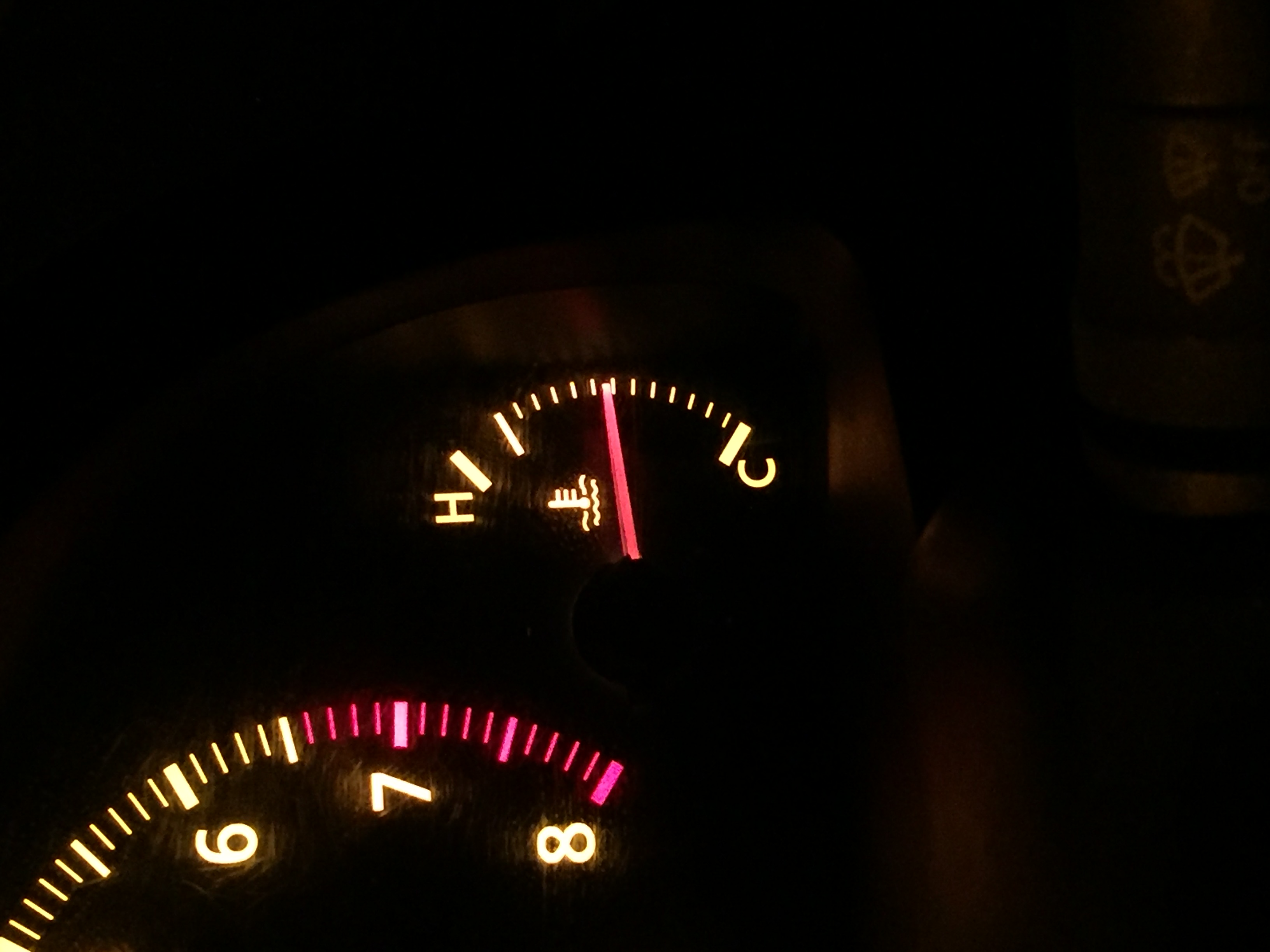

How hot does your ride run?
Ever since I've gotten my g I've noticed that the temp gauge is kind of high. I wondering how hot your temps get for your ride.

Mid gauge, never higher even here in SoCal in the summer with air conditioning on...Gary

Front and rear cameras, tire pressure for all four tires can display on screen,folding side view mir
That is not normal
Get it checked
See the cooling section in the FSM for your vehicle
Thermostat
Radiator cap
Water Pump
Coolent
Fans
Good luck
Telcoman

Mine usually sits one notch below mid-gauge. Yours looks like it's one notch above the mid-point.
Does yours move, or pretty much stay the same? You can verify actual coolant temps with an OBD2 scanner and an app on your phone. Mine usually runs between 180-190 degrees, might get up to 195 when driving hard.
Old Jan 13, 2016 | 11:53 AM
Jusseth's Avatar
Joined: Jun 2015
Posts: 149
Yeah, I would get that checked. If it does not go higher than that point, I would suggest the culprit to be the thermostat.
