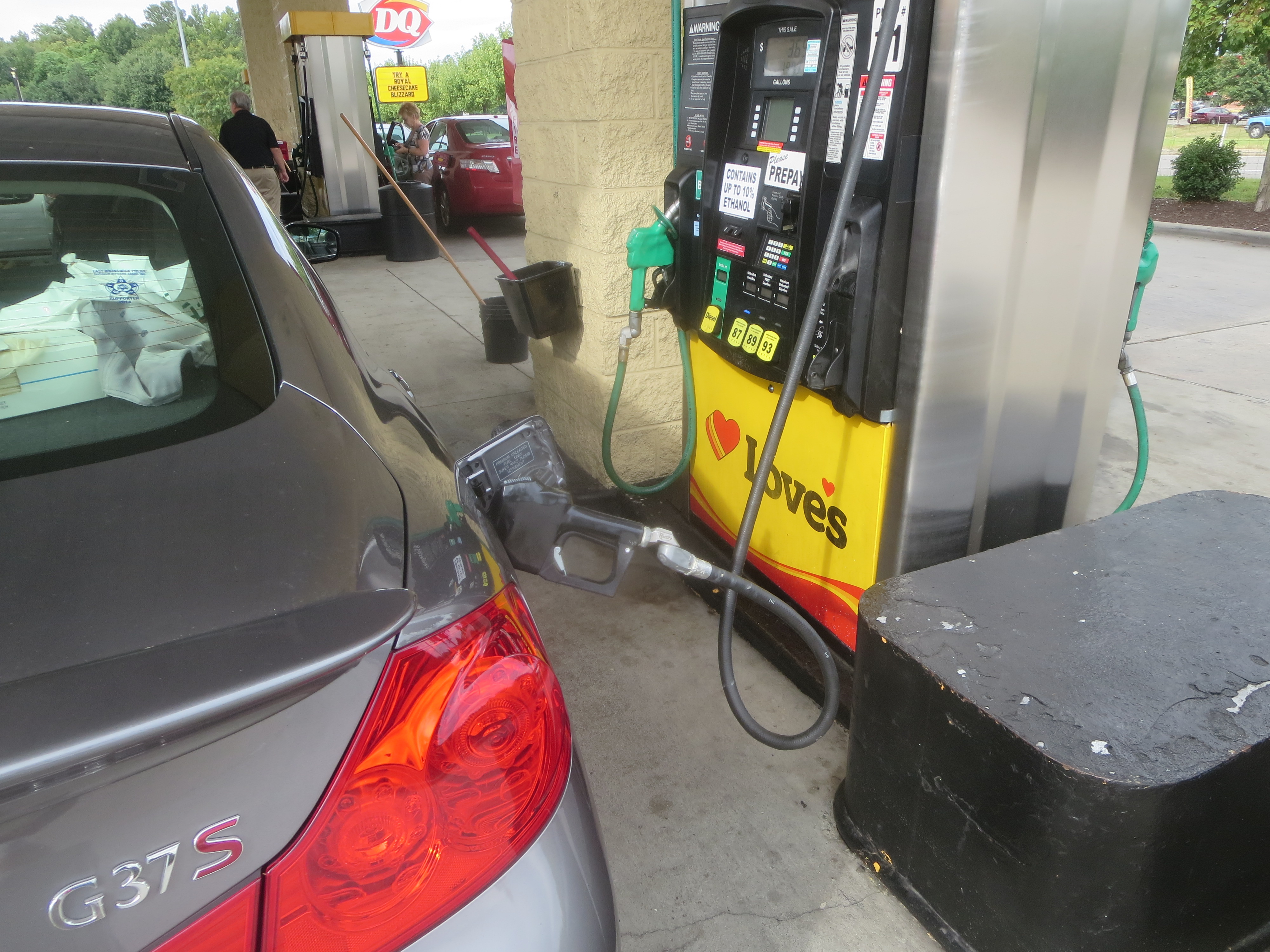

After twelve years of Infiniti ownership (06 traded in on my present 2012 with 171796 miles) and my present one with 88k miles I've driven both of them 260,000 miles all on regular 87 octane without any engine or other problems whatsoever.

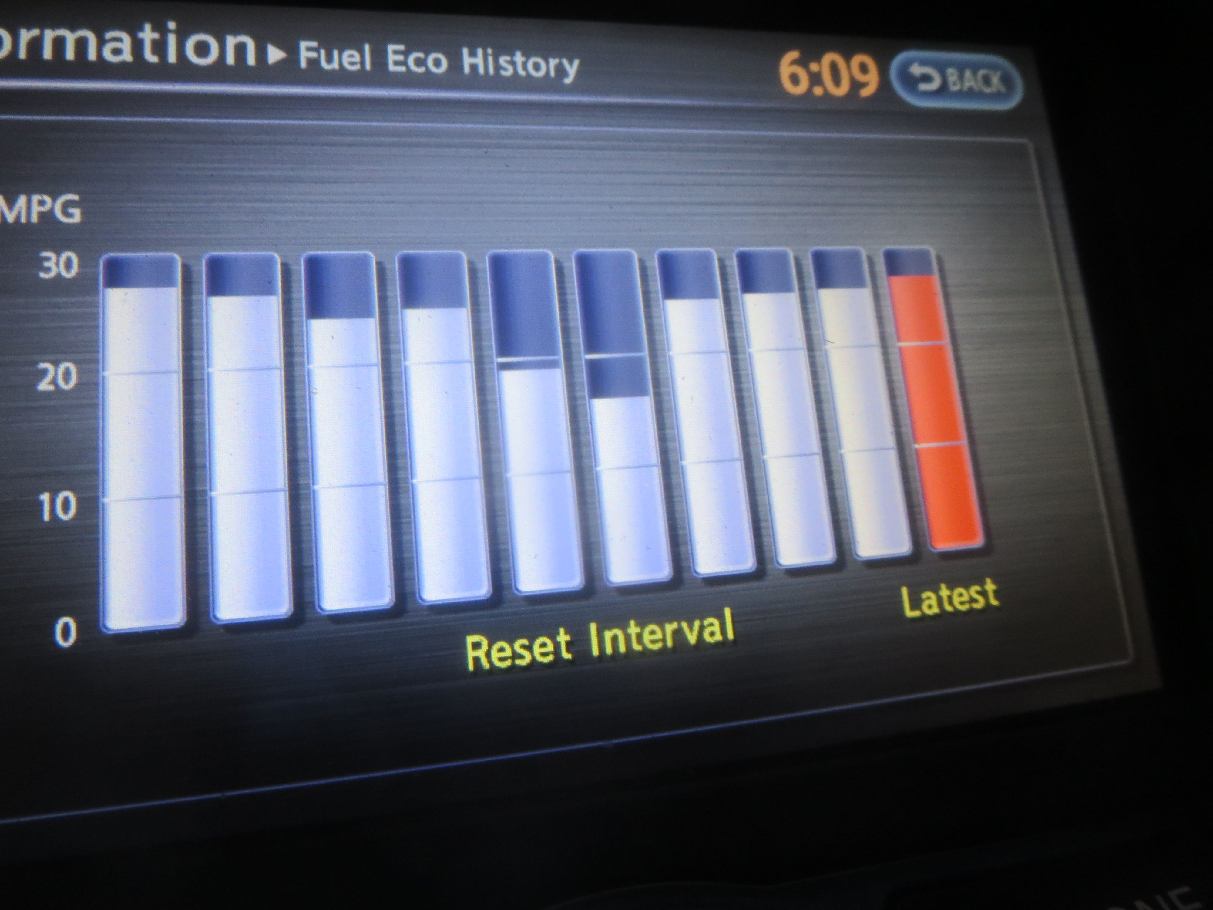

I did do a one month test using 91 octane and another month test of using 93 octane in April and May of 2009 after hearing all the ragging of many like yourself telling me I was going to destroy my vehicle.
Those two monthly tests proved that I got better MPG using regular 87 octane.
The tests were conducted when I was commuting 100 miles/day or 2000 miles/month using the same route and same trip every day.
I've saved thousands of dollars using regular 87 octane these past twelve years and I only inform others that nothing is going to happen to their Infiniti by its use.
Locally here in NJ I purchase almost all my gas here.
F U Photobucket
On my trips from NJ to Florida a few times a year I prefer Loves truck stops. Excellent gas, clean rest rooms with many stalls.
F U Photobucket
Always get excellent MPG on the road cruising down I95 from NJ to Florida
F U Photobucket
Short trips with frequent stops and starts, not so much
So sorry if that bothers you but hey if you enjoy pissing money away and it makes you happy enjoy your premium gasoline.
