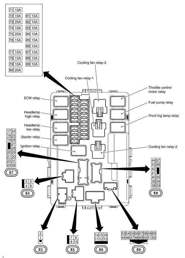

So I've gone through the FSM, and sketched out the route from the sensor back to the battery and to the ECM. I'm going to try to test any fuse or connectors I can with hopes that's all it is. My fear is that it doesn't really appear to have anything between the sensor and ECM but I could be unclear with the FSM diagrams. There are fuses and the ECM Relay (how do I test it btw), but it seems to be on the way to battery and nothing on the way to the ECM itself.

Start with the fusible link, you probably blew one of the fuses there, it's attached directly to the positive battery terminal, you will probably find one of the fuses is blown, a visual inspection is all you need for it because it will look blackened inside the viewing window for one of the fuses if it's blown or you will simply see the wire blown apart. Next check fuse 77 on the IPDM, also check the ECM relay for proper operation, 12v across pins 1 and 2 will CLOSE the circuit on the other two pins, use a generic fuse holder and don't do this with the battery hooked up to the car in case you short something out and cause even more problems.
Yes grounding out that pin could have damaged the ECU/ECM, it's just a computer complete with resistors and other electronics that are very susceptible to damage from line to ground faults like that. Basically you can only test these other components to verify power is getting to the ECU and that is has a ground. There's a LOT of possibilities for why it won't start and you might need to tow it to Nissan for a diagnostic rather than throw a bunch of parts at it hoping somehting makes it work.

I would take some female spade terminals and crimp them onto some 12" pieces of wire then tie everything down on a bench and use aligator clips to apply the 12v to the coil side of the relay, then you use your digital multimeter set to OHMS and read across the contact side of the relay. Opening and closing the relay will cause the meter value to change exactly as if you touched the probes together and then pulled them apart, open and closed.
