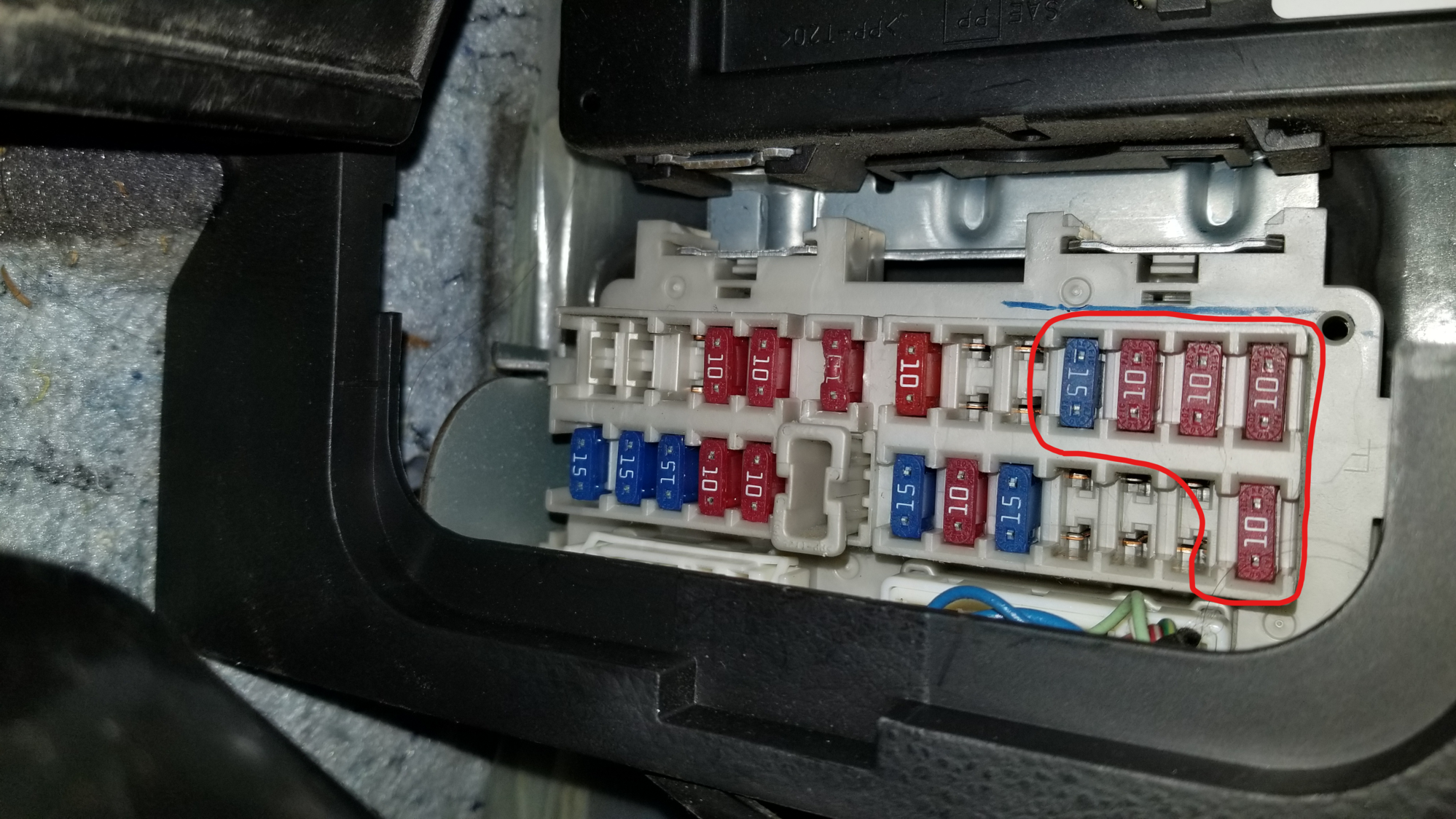

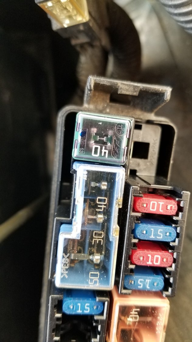

What is this "BCM fuse panel" you're talking about? I assume you mean the CABIN fuse box yes? It receives it's power directly from the fusible link so I'd check every one of those viewing windows to see if something blew, that's PROBABLY what happened.
Replace the fusible link if needed, it's like $25 for a new one.

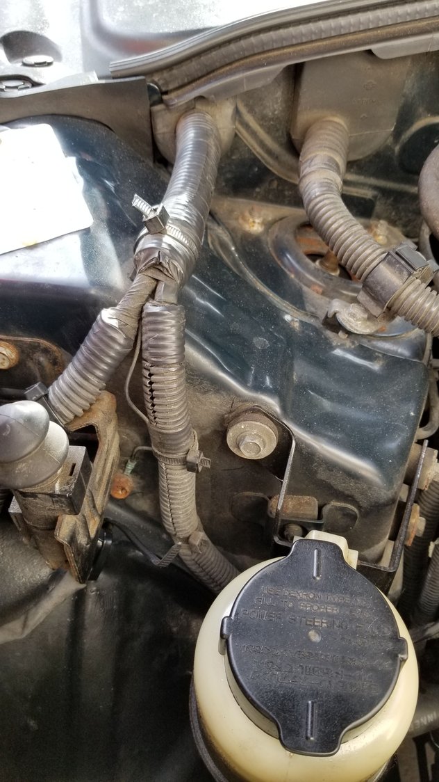

This is the book nding jumper I'm talking about on the passenger side, my finger is on the bolt. The other end is u der the coolant reservoir.

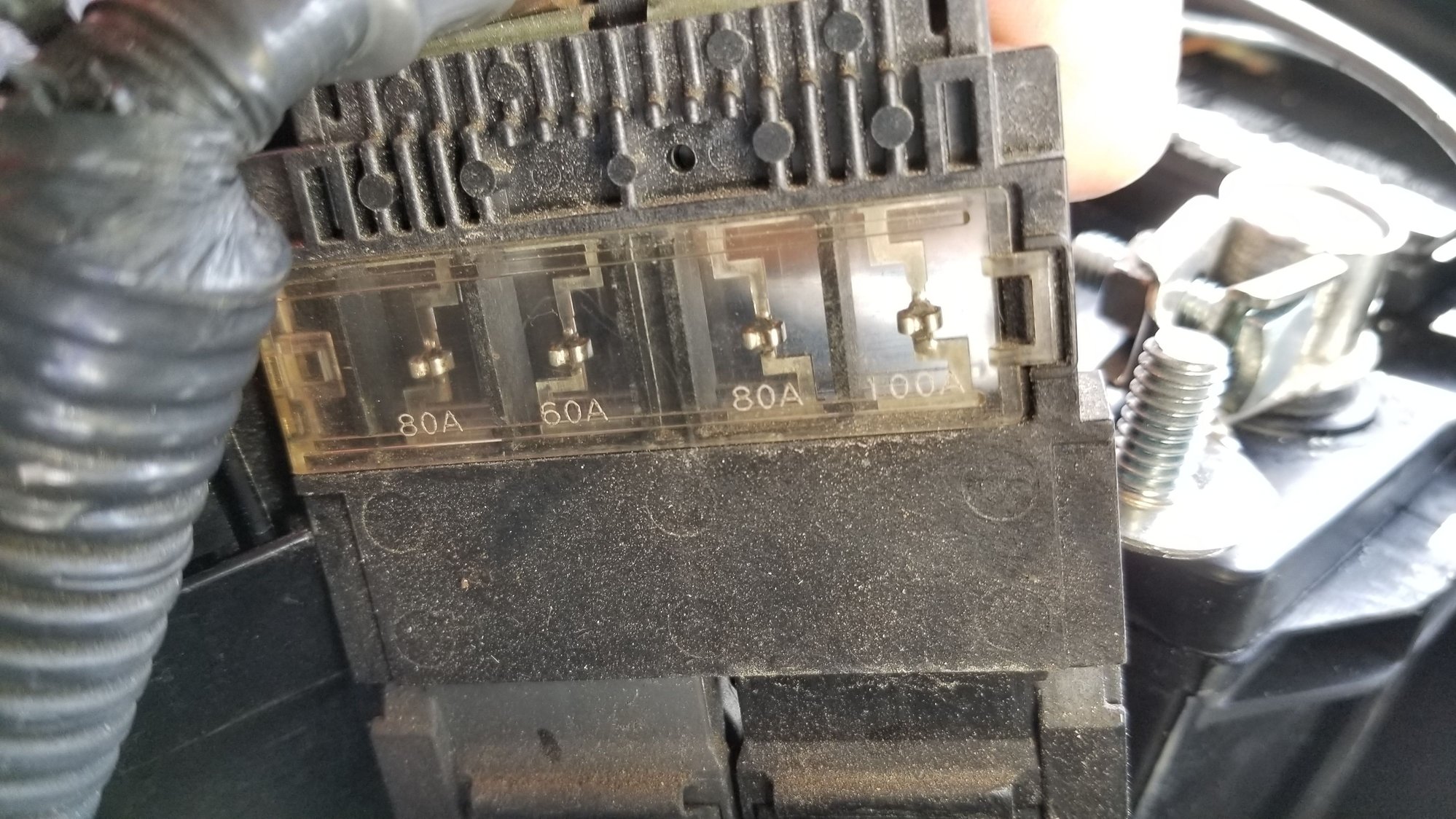

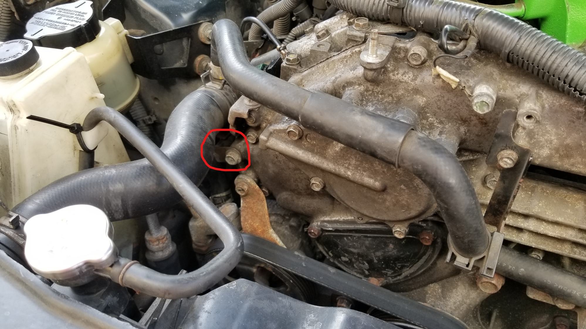

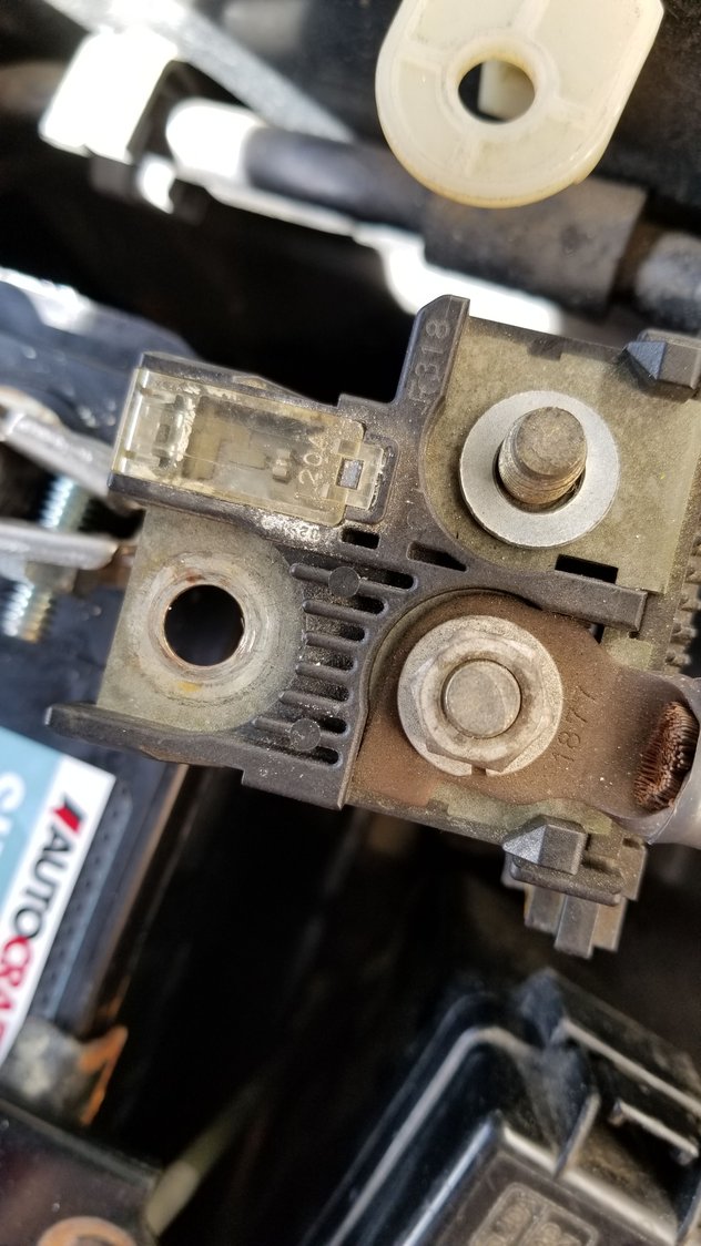

Here are some pictures. I checked my fusible links. None of them looked bad or blown. i cleaned off the battery cables and made sure there was a solid connection. The battery itself is brand new, just got it last week. The binding jumper is connected to my timing cover, and the other end is connected to the body of the car. The connection of the binding jumper to the body of the car looks pretty corroded though.
This side of the binding jumper is connected to my timing cover.
Big fusible link
The other end of the binding jumper harness is connected to the body. It does look pretty badly corroded though. Should I remove this and clean the mating surfaces?

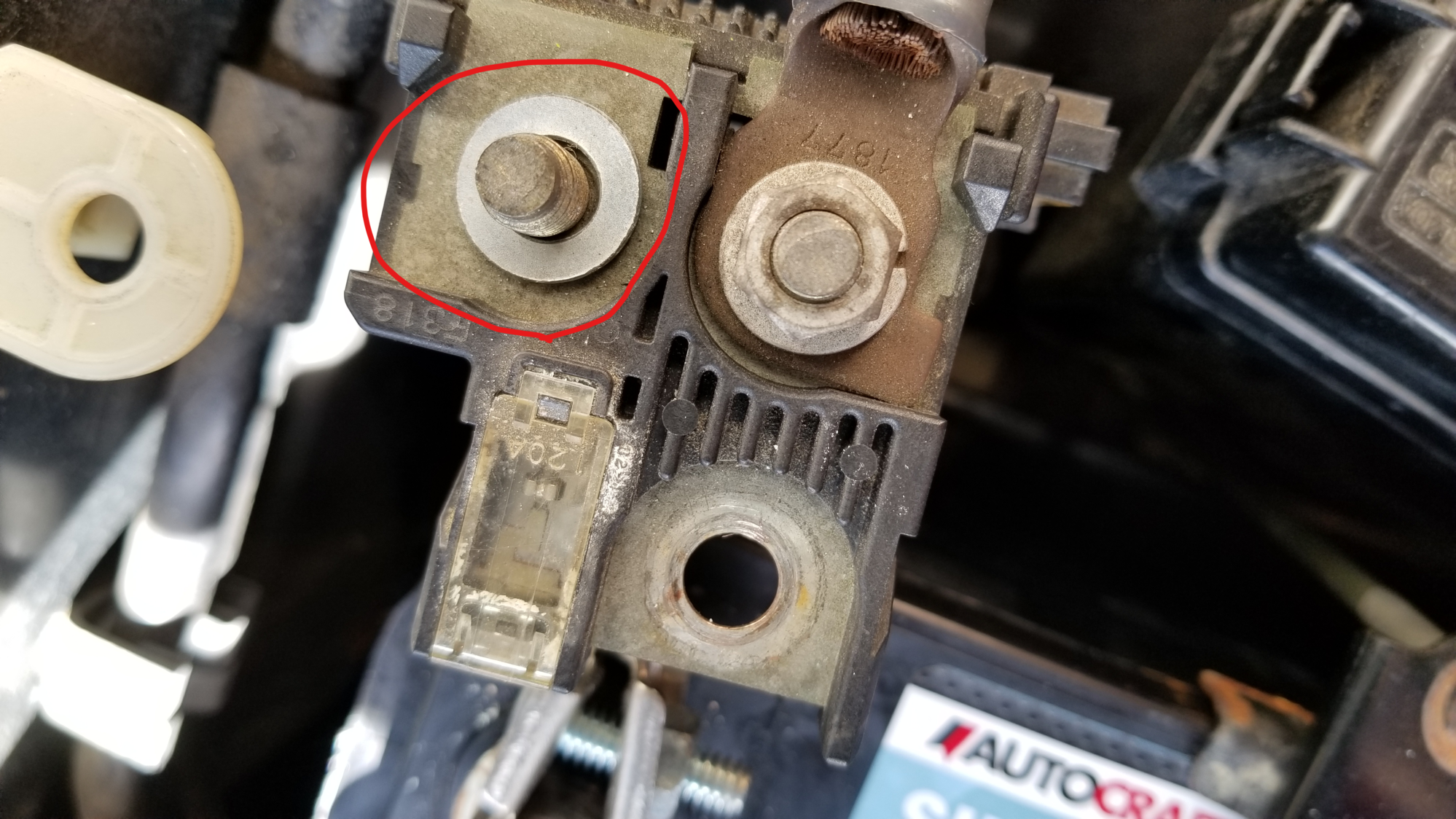

What is supposed to go here? For as long as I can remember nothing has been attached here.

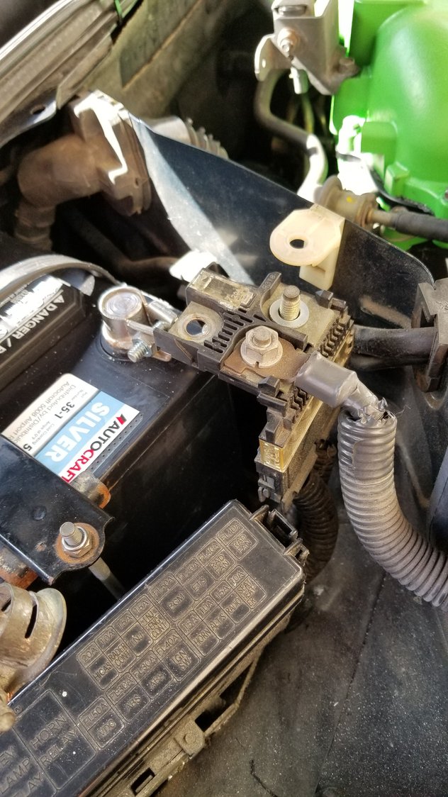

More fusible links on the positive battery cable. Visually they look good.
More stuff. All of these links look good too upon visual inspection through the clear windows. (side note: the horn doesn't work and the horn relay didn't work when I tested it a few days ago with my power probe III)

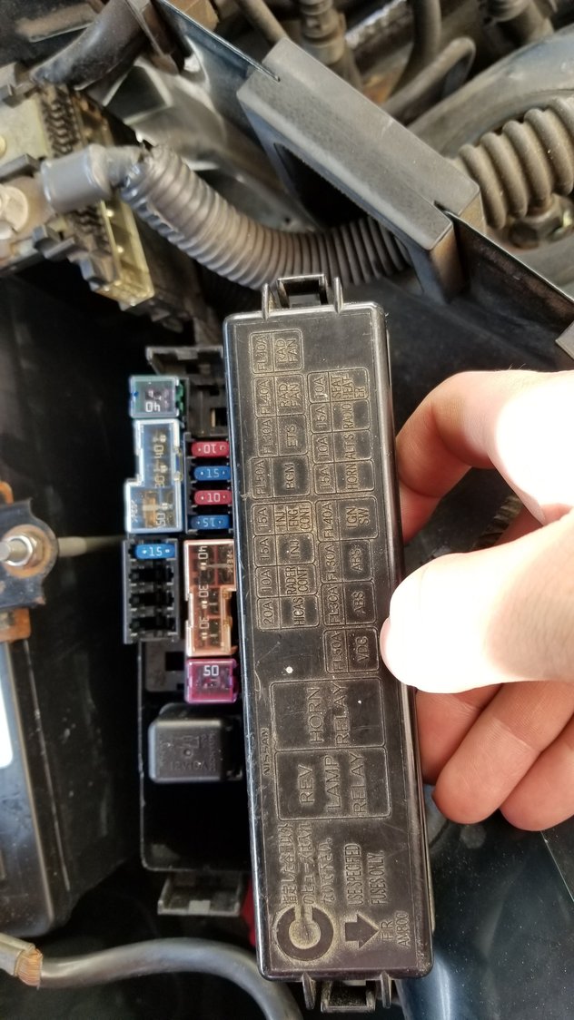

This is my cabin fuse box. The fuses circled in red gave that weird erroneous reading when i tested them with my power probe III, all of the other ones tested ok (including that weird looking one by the fuse puller)
close up
close up
close up
the little grounding connector here looks pretty corroded too, would that tiny one cause any problems?
