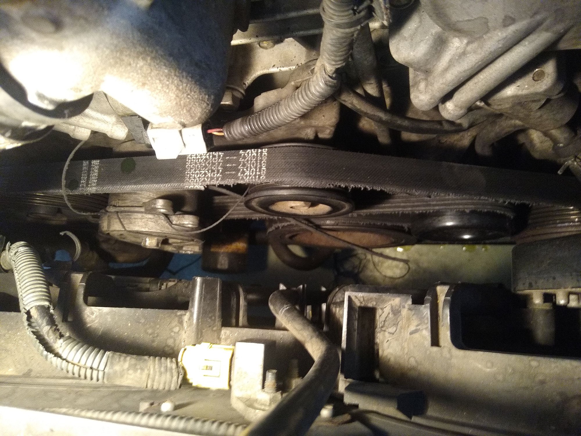

Well I changed idler pulley,& changed the belt. Went for a drive, now the belt is shredding?? Any clues why? Thanks
Old Mar 27, 2020 | 08:20 PM
kelman81's Avatar
Joined: Oct 2018
Posts: 175
Likes: 26
From: East TN
G35 Sedan Leather Base, Z1 Plenum Spacer, Z Tube (Currently sold to a friend)
Is something out of alignment? Did you reinstall something that uses a pulley without the shins or with washers it didn’t have before? Are you sure the belt isn’t interfering with something? Does your AC clutch cycle on and maybe resist it?
sorry if you’ve explained any of that above.
Old Mar 27, 2020 | 08:27 PM
guyver3's Avatar
Joined: Mar 2020
Posts: 6
g35x
The belt AutoZone gave me I believe was too wide. It's now working fine but belt looks shredded.. could it be that it shaved off the excess belt? All I did was change idler pulley and put belt on. I did not mess with anything else.
Old Mar 27, 2020 | 08:48 PM
kelman81's Avatar
Joined: Oct 2018
Posts: 175
Likes: 26
From: East TN
Are they maybe giving you a coupe belt (older model and engine) than the redesigned 2007 model sedan belt?
Old Mar 27, 2020 | 09:45 PM
guyver3's Avatar
Joined: Mar 2020
Posts: 6
g35x
Thank you for bringing that to my attention. I did notice the belt extra tight even with the tension off. I'll take it tomorrow to the auto parts store. Hopefully it was that
Old Mar 28, 2020 | 12:24 AM
cleric670's Avatar
BANNED!!!
Joined: May 2017
Posts: 14,837
Likes: 2,497
From: Washington State
Coupe 6MT Premium RAS
Or you didn't verify that it was 100% seated into the grooves on one of the grooved pulleys. It will definitely shred off a ribbing if it's not actually seated into the rib of the pulley. You would he able to visually verify this usually before you remove the shredded belt.
Old Mar 28, 2020 | 11:02 PM
Hall Stevenson's Avatar
Joined: Feb 2018
Posts: 494
Likes: 49
I have an '08 and Autozone says the belt is 810K7 for mine and that appears to be what you have on there as well. The '07 and '08 should use the same belt. I see multiple references to that same p/n with Advance Auto, Continental, etc. Even if you didn't install the idler pulley 100% right, I'm hesitant to blame that since the idler is smooth and can't shred the belt. It also doesn't "align" it to my knowledge. It is only for changing direction of the belt, I believe.
