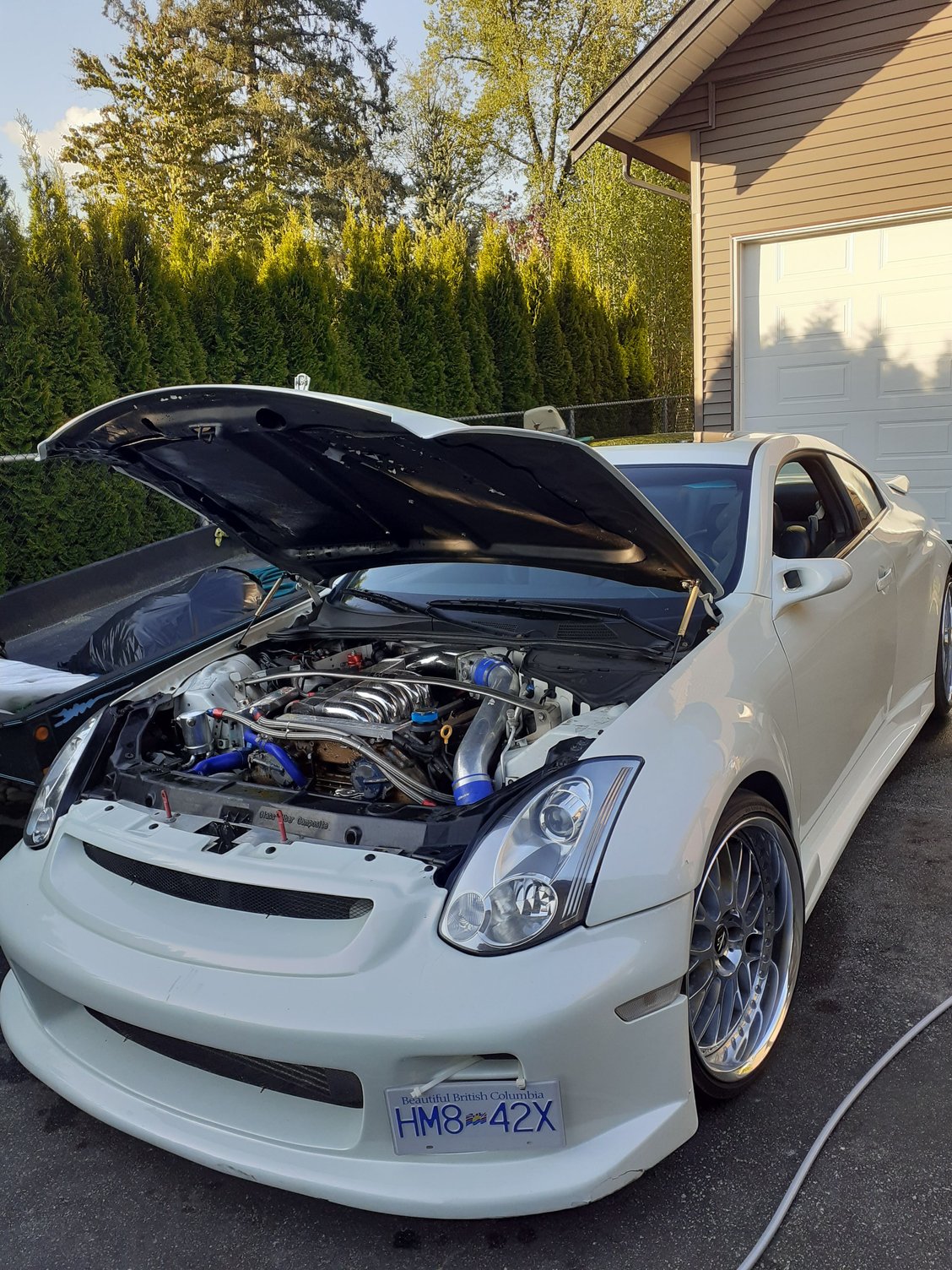

Old May 6, 2020 | 05:07 PM
Qship's Avatar
Joined: May 2020
Posts: 12
From: Vancouver,BC
AAM State 2 block, Gready twin turbo, Top Secret body kit, bla, bla,bla...
This is the project you guys are helping with. Thank you.
Old May 6, 2020 | 08:33 PM
cleric670's Avatar
BANNED!!!
Joined: May 2017
Posts: 14,837
Likes: 2,497
From: Washington State
Coupe 6MT Premium RAS
Rear bumper fitment is a little off but I'm actually liking the wide body kit, any clue which one it is I've never seen it before, looks custom?
Old May 6, 2020 | 09:18 PM
Qship's Avatar
Joined: May 2020
Posts: 12
From: Vancouver,BC
Oh ya that...The fitment was fine before the tow truck picked up the car when the hose blew and I had it towed home. The car was lower than the pictures you see when the hose went and it was a monumental hassle to get it on the truck. I've since raised the car about 1.5" . Next thing to do is fabricate a new tow hook set up if I get towed again...and I will. Some attachment tabs snapped when loading the car. It was a **** show . The tow truck driver was good and I was helping so no blame on anyone. I was just happy to get it home.
The body kit is from Top Secret, it's the Super G-Force kit. They are a big player in ***an but I haven't seen much of their stuff on the west coast.
